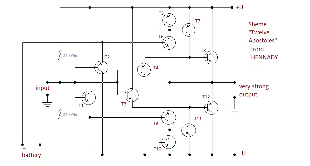

Good evening/morning.... I was reading the other day about 'Diamond Buffers' topology, have any of you have experience with that topology, does it sound better or different as some say ?
What exactly interests you in this buffer?
And what exactly do you want to collect with its use?
Т6 and т9 are the same output transistors as Т8 Т12What are T6 and T9 for? Bias control?

Bias Control is performed by an independent voltage "Battery" source at 2.2 ... 2.6 V
Can anyone be interested in a more advanced scheme than a "Diamond buffer"
This is may scheme of the "12 apostles" (attachment):
Hi Hennady,
Interesting, but aren't you at the mercy of outstanding matching requirements of PNP/NPN transistor specifications and stable, low noise power supplies to get a decent signal quality through this buffer? Unless of course this is just the broad principle and/or it is intended to make it as a monolithic IC? I seem to remember a similar circuit topology being employed in a commercial opamp, but I simply can't recall which one.
And a battery can of course be low noise, but it is not stable - what happens when it runs low? Or being recharged?
Sorry, I wasn't intending to be negative, but it would help me (and probably others) if you could please clarify.

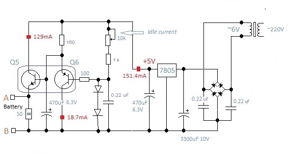

It's simple - it's an electronic battery
see Attachment

That is a lot of hardware to do the job.
And I don't understand the "50" (ohms?) at the "electronic battery".
129mA through 50 ohms would give over 6V drop, ie. more than the 7805 provides? Sorry, I try, but still don't get it.

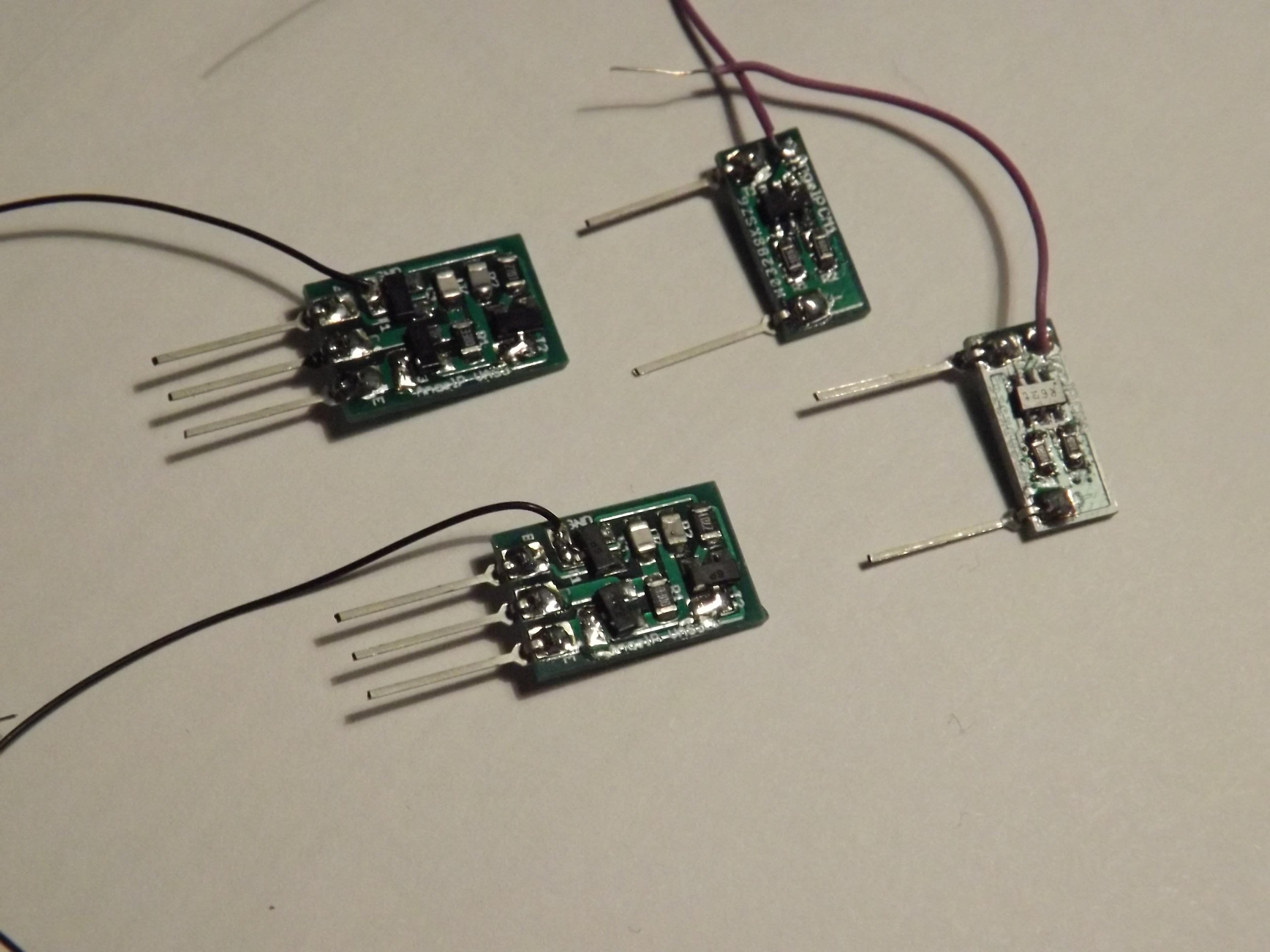

Well, It's been over 2 weeks since I installed the prototype boards you sent me and wanted to thank you again for your kindness!
I just wanted to report that my rotel is still kicking a$$! and that I have not had a single problem ever since whatsoever! Though, I don't listen to it very loud at all, just sometimes.
Installing the boards was very straight forward, thanks to your instructions, though, I have to tell you I was a little, or should I say very
nervous about installing these boards, because I sure was afraid to burn my amp, as it was the first time I did something this advanced to an amp, not to mention, it was the first time I dealt with Current mirrors and VAS, now I am so freaking glad I did! becuase the reward is really great.
At anyrate, here is a picture of the boards on the left channel, it was just a matter of removing 6 parts per channel then adding the boards, which it was fairly easy. After installing them, I was very surprised and relieved that the amp turned on and worked with out any issues at all, I mean, i didn't even had to adjust bias nor DC offset again!, it was great, they worked real good immediately. Sir, very well done on those boards.

Thank you for your kind words Joaquin and good on you!
I am very pleased that even though the two modules were originally designed for the RA-8/900 series of Rotels, you actually succeeded in upgrading your RX-750 with them. I can guarantee that its THD/IMD etc. will have dropped like a stone. Enjoy!
People have asked me whether I would consider selling the VAS and CM modules - and why not?
I am not in this for any personal profit, the direct price of PCB, components, SMT pick and place manufacture, testing and packaging is about US$10 per module. So, it is $40 for the two pairs required. Postage comes on top of that.
They will of course come with detailed installation instructions, but some basic PCB soldering experience is still required.
I don't know how to get them on the diyAudio marketplace, maybe someone in here can help? Or maybe I can just put them on eBay?
Speaking of which, if you rather fancy me supplying the heavenly music box, I will soon have four cosmetically perfect and upgraded RA-931's ready for sale on eBay, just search "RA-931 AngelP Signature".
I also offer to do the full 42 component upgrade for Rotel owners who would prefer me to do the total rejuvenation/upgrade of their own beloved amp. I live in the UK, so please note that international shipping costs may be an issue.

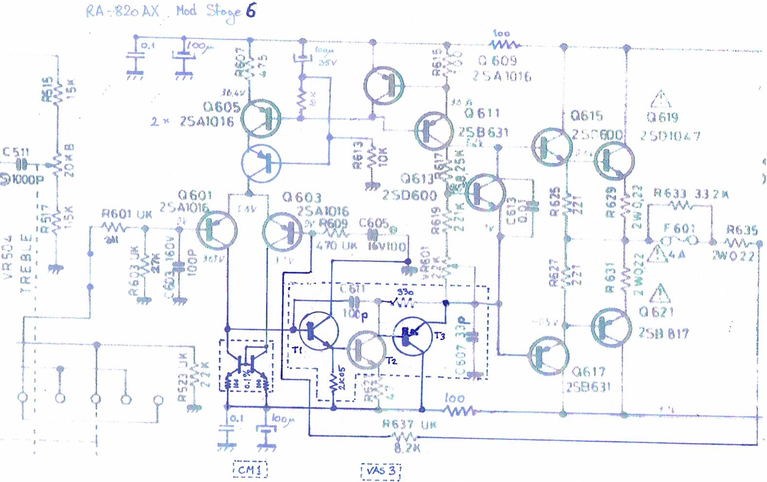

I have been asked the following:
I enclose (somewhat) better pics of the modules and a schematic of the 6th RA-820AX mod where these new modules are employed.
T1 is connected as an “emitter follower” (EF) so the collector is not the output. The collector should just be at a stable dc voltage high enough and able to deliver the current through it and the emitter resistor which then “follows” the base input. (Think of it as like putting a unity gain buffer opamp in).
You can connect the T1 collector to V+ if you want, T1 is the SMD version of 2SC1845 so it can easily take the resulting 80V across it, but that doesn't give any improvement and there is no need to go beyond the 40V GND to V-. (BTW; If you connect the collector to the emitter of T3, the entire VAS 3 module will appear as one single diode protected darlington transistor with a hFE of about 2500.)
Firstly, the 2nd EF (T3) basically does the same thing as T1, only here it greatly reduces the load on the VAS (T2) caused by the following driver stage. This increases linearity by protecting the VAS transistor to do its job.
Secondly, the SOT23 version of the SC1845 and SA992 has a max. collector dissipation of 300mW. The bias stage current of 6mA with 40V across a single T2 would give 240mW – that may be ok, but it would still run uncomfortably hot.
Sharing the 6mA (2:4) between T2 and T3 solves the problem, and the module has been designed so the dominating 160mW heat from the T3 collector is readily dissipated down into the main PCB copper tracks as heat sink.
It works a treat, I have never measured temperatures over 48°C anywhere on the VAS3 module even under full load. And as you may infer from the version number, I have indeed been through a couple of VAS iterations before finally settling on this one.
1. why the collector of the 1st transistor is connected to ground, not clear on why the output is being shorted to ground? will this cause a problem eventually?
The “VAS 3” module is a "EF-VAS-EF" stage, i.e. the middle VAS transistor is “sandwiched” between the two EF's. The 1st transistor (T1) performs like a buffer, reducing the current load on the input stage by its hFE, in this case by a factor of 350. This has been shown to greatly reduce the THD of the stage. Please cf. my measurements and cabirio's simulations (e.g. post 183)T1 is connected as an “emitter follower” (EF) so the collector is not the output. The collector should just be at a stable dc voltage high enough and able to deliver the current through it and the emitter resistor which then “follows” the base input. (Think of it as like putting a unity gain buffer opamp in).
2. why did you change the board to use 3 transistors? I thought your mod 5 used only 2 trainnies (EF-VAS) as you posted on your main thread.
[FONT=FreeSans, sans-serif]The reason for that is twofold: Firstly, the 2nd EF (T3) basically does the same thing as T1, only here it greatly reduces the load on the VAS (T2) caused by the following driver stage. This increases linearity by protecting the VAS transistor to do its job.
Designing the module as a simple direct drop-in replacement for a traditional TO-264 or TO-220 NPN VAS transistor gives the option to easily upgrade other amps than the Rotels they were originally designed for, although there will obviously be some limitations.
Note that memofer's amp is a RX-950AX receiver with a very different PCB layout, yet he still made a success out of it.
I have just been asked whether I could improve a NAD 3030, which seems quite feasible.
Per[/FONT]
