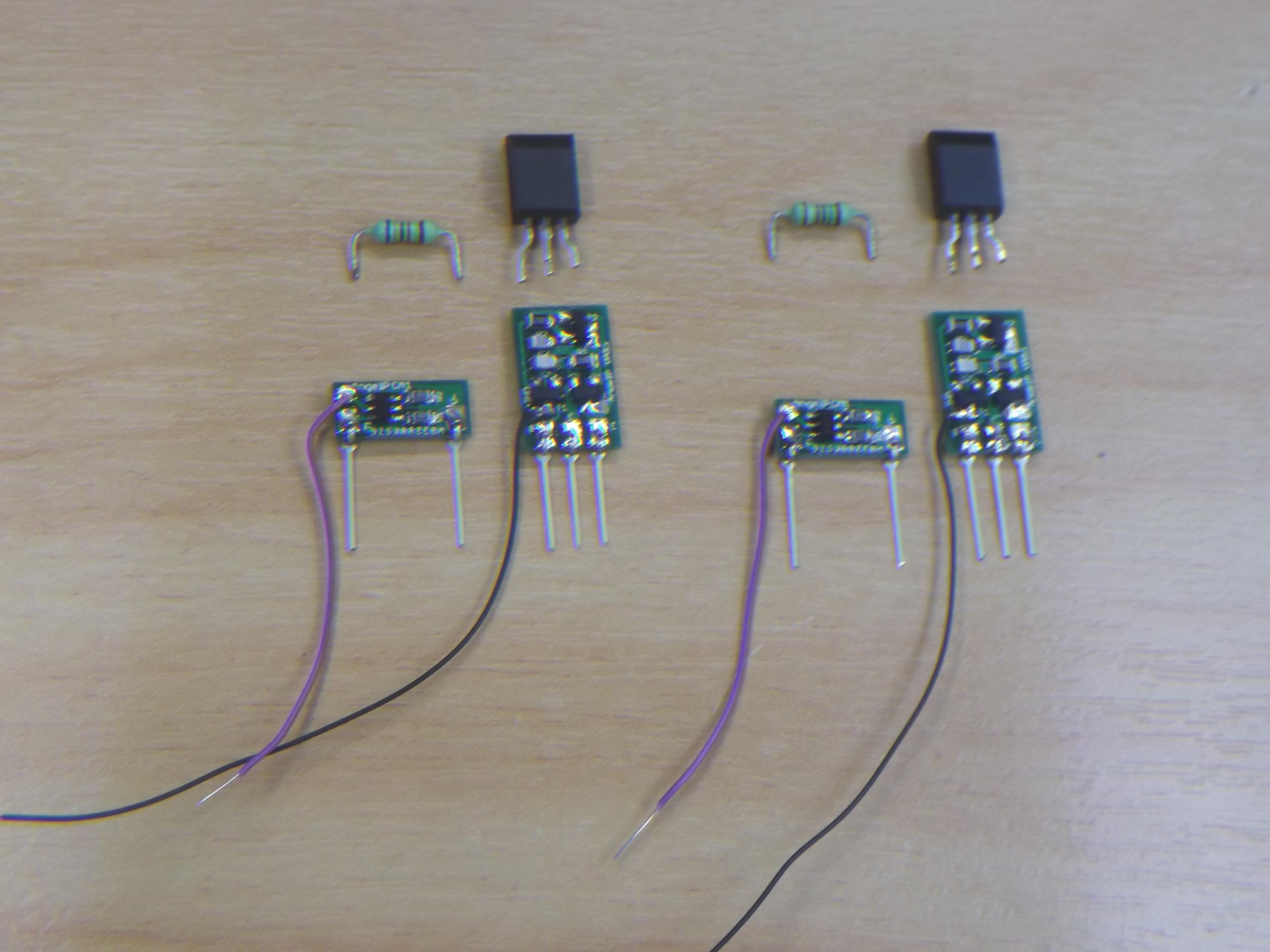

So, I decided to finally stop doing the very time consuming fumble-boarding of the CM and VAS circuits, and instead design and order proper double sided SMT boards from PCBway - which I must say I have had very good experiences with in the past.
At first I decided to also ask PCBway to populate the pcb's for me, but the initial web price quote for this simple job suddenly almost doubled and it appeared that someone in their procurement considered a 100k 1% resistor chip as a good match for the specified 100E 0.1% (!)
So, I sort of lost confidence and thought "Ok, I can do this better and cheaper". Well.....
After some experimenting and getting to a decent solder paste stencil printing setup result, I first tried to solder the small pcb's with my trusted SMD hot air gun.
I still have to locate some of the the boards and most of the tiny 0603 components somewhere on the floor :(.
So, I bought a cheap T-962 IR reflow oven, which, after having done all the essential safety repairs and firmware upgrades as recommended on the web, now performs very nicely indeed.
My first finished miniature boards of the CM and VAS are pictured under the original components for which they will be a direct drop-in replacement.

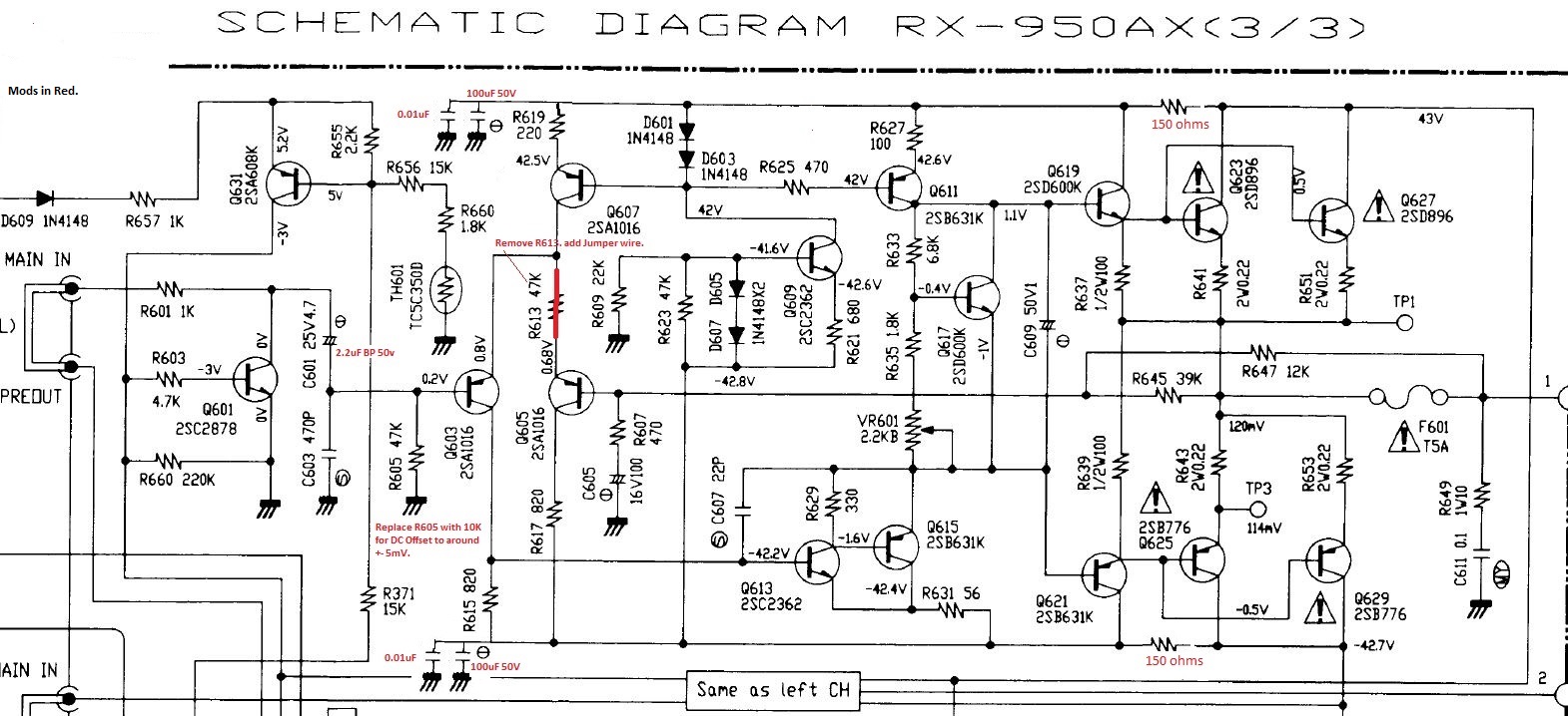

I was wondering if your mod would apply to a Rotel Rx-950ax? the amp section does look close to yours but not exactly the same.
Hi memofer,
I have never been under the bonnet of a Rx-950ax, but had a brief look at the schematic of the power amp stage. The diff PNP input could definitely be improved with properly paired 2SA992's and a current mirror instead of their two collector resistors. I would also short out the strange single 47k emitter resistor that clearly unbalances the input and is a proper noise source.
For the VAS section, my small pbc module contains all the 950ax circuitry, but also includes the important pre-VAS emitter follower. It will not quite be a direct drop-in replacement as in the RA-930 series, but the mod should be doable with a bit of tweaking of the pcb's "collector" pin connection.
Maybe you should attach the RX-950ax amp section schematic for other DIYers to be able to follow?

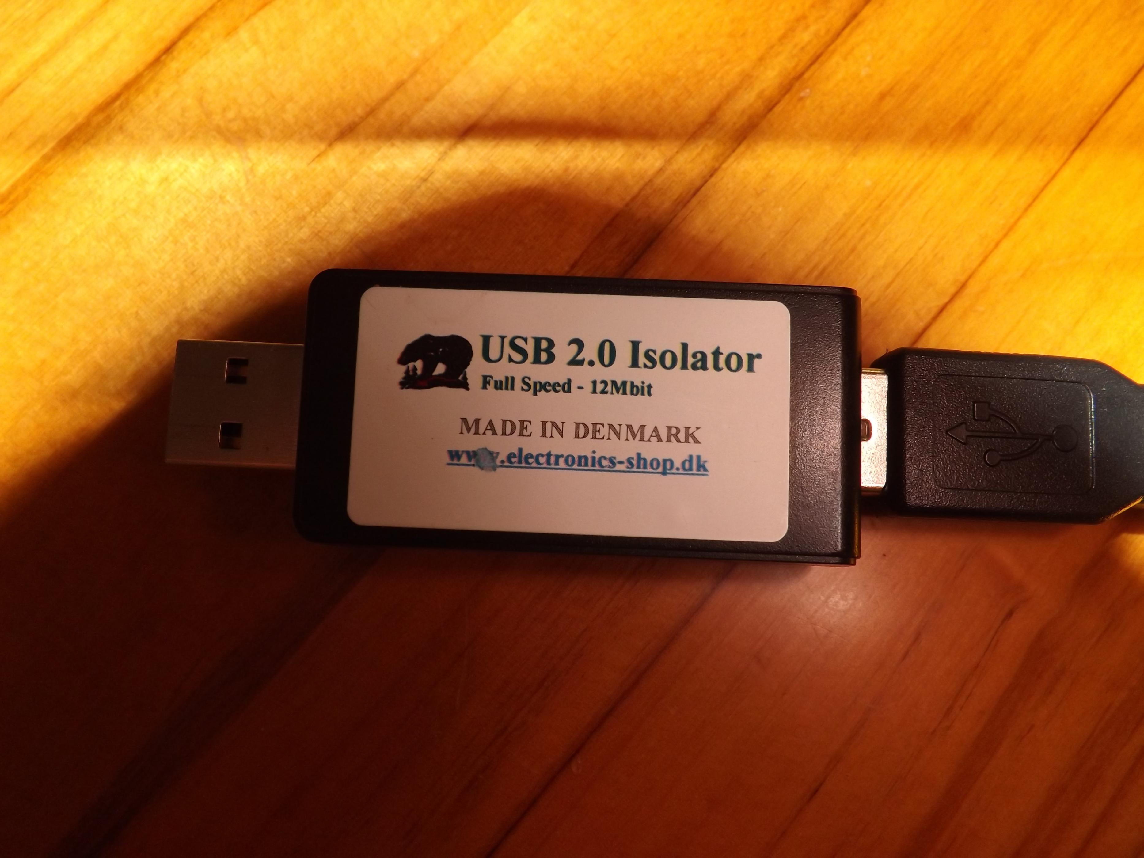

As readers of this thread may know, I have a setup of a dummy load box with a built-in XonarU7 audio to USB unit which makes RTA of amps very quick and easy.
Due to other work I had it stacked away for quite some time, but having finished the new pcb modules I was very eager to set it back up and do pre- and post mod measurements. Too eager.
I forgot to attach my trusted USB isolator (pictured) to the cable, and the first RA-931 patient I connected - had 120Vac stray voltage on the speaker outputs. Not much energy in it, but enough to feel a small tingle when touching the outputs and the PC enclosure.
And enough to show the weakest link in the setup - the Xonar's USB com circuitry, which apparently does not have a proper overvoltage protection.
I now have an invisible XonarU7 box - at least to any USB port.:bawling:

Hi memofer,
Per
Thanks for the suggestion AngelP, I will check it out as soon as I can and will apply some of your modifications. Though, I am still learning about amplifiers, I am not sure how difficult it will be to apply the Current Mirror you suggest. will that single modification makes that much difference? as I have never had an amp. that uses current mirror.
and by-the-way, I want to thank you for making this info available as I like my Rotel receiver, I know it can be improved.
thanks,
Hi again AngelP,
Your name is most appropiate for me, because your single suggestion re removing the 47k emitter resistor, and including some of your other mods,
has made a huge difference. it almost feels like you just handed me a completely different amp! it sounds better than I expected and I will
have to go over my music library again!
Now, I am really curious about the current mirror and will research to see how I can apply it, would you be willing to sell me the parts?
or suggest what to buy?
For now, I will enjoy it as much as I can.
attached are the changes I made.

Hi memofer,
Congrats with your success so far! I would probably have placed the two 150E resistors on the other side of the Q619/621 driver collectors so they wouldn't have to carry the extra current and voltage drop, but that's just me.
You can of course make the current mirror yourself, but it is a bit of a fiddle because the mirror transistors are SMD's. (See pic in 264)
Having already had the pcb's professionally made and bought the components, it would absolutely make sense to populate and reflow solder the parts for you and other modders. Further, I will sell them at cost, as this is my passion - not my day job.
The current mirror mod job is now made very easy, just remove R615 and R617, drop in and solder the CM module in place of R615 (resistor end down to V-) and solder the thin wire from the module to the top end of the R617 pad where it connected to the Q605 collector - and repeat for the right channel.
For the VAS module, I will have to look again on your amp layout, but it seems relatively easy. Remove C607, Q613 andQ 615. Drop the VAS module in place of Q613 and short R629.
The black wire from the module should be soldered to ground, possibly to the ground end of R609.
All these mods are reversible - no cutting of pcb tracks, etc.

re those 2 resistors, the only reason I placed them there was because, it was just to easy to do it
at that locaion, as all I had to do was to remove 2 jumper link wires and bingo! it was so easy. so far they
seem just fine as they don't even get warm, so it must be ok.
Looking at the layout, would you know what is the purpose of Q609? just curious!
Let me know!
Cheers!
Joined 2012
Q609 and all the circuitry around it forms a constant current sink from the bases of Q607/611 down to V- - replacing the simple 6k8 resistor to ground usually found in that place.
Is it better, does it really improve things? - well, I don't know, I've never measured it.
Mind you, it could be a good idea for the purpose of increasing PSRR, but I think that your nice, brutal 150E / 100uF filters do the job just as well.

I was not planning on doing anything to it, just wasn't sure of it's purpose, but that makes sense as a constant current sink, I thought it was some sort of voltage divider/regulator.
I used those 150E resistors cause it was all I had in my parts bin and I figure it was close enough! so maybe I just got lucky! :D
I know what you mean, there is another model of the 950ax that is the mkII,
but I have no clue what's the difference, maybe it is as the one you mention.
though, in my amp. the schematic is wrong on resistor R613 47k, as it was only 47ohms not 47k. maybe just a typo.
Joined 2012
Oh, that would make so much more sense, 47E would be an attempt of an emitter degrading resistor - but which should have been 0.1% mirrored in the other input transistor pair branch - or shorted out.
47k would be absolutely bonkers!
Are you contemplating putting in a new hFE matched input pair, or are the existing trannies ok matched? Do you know?
