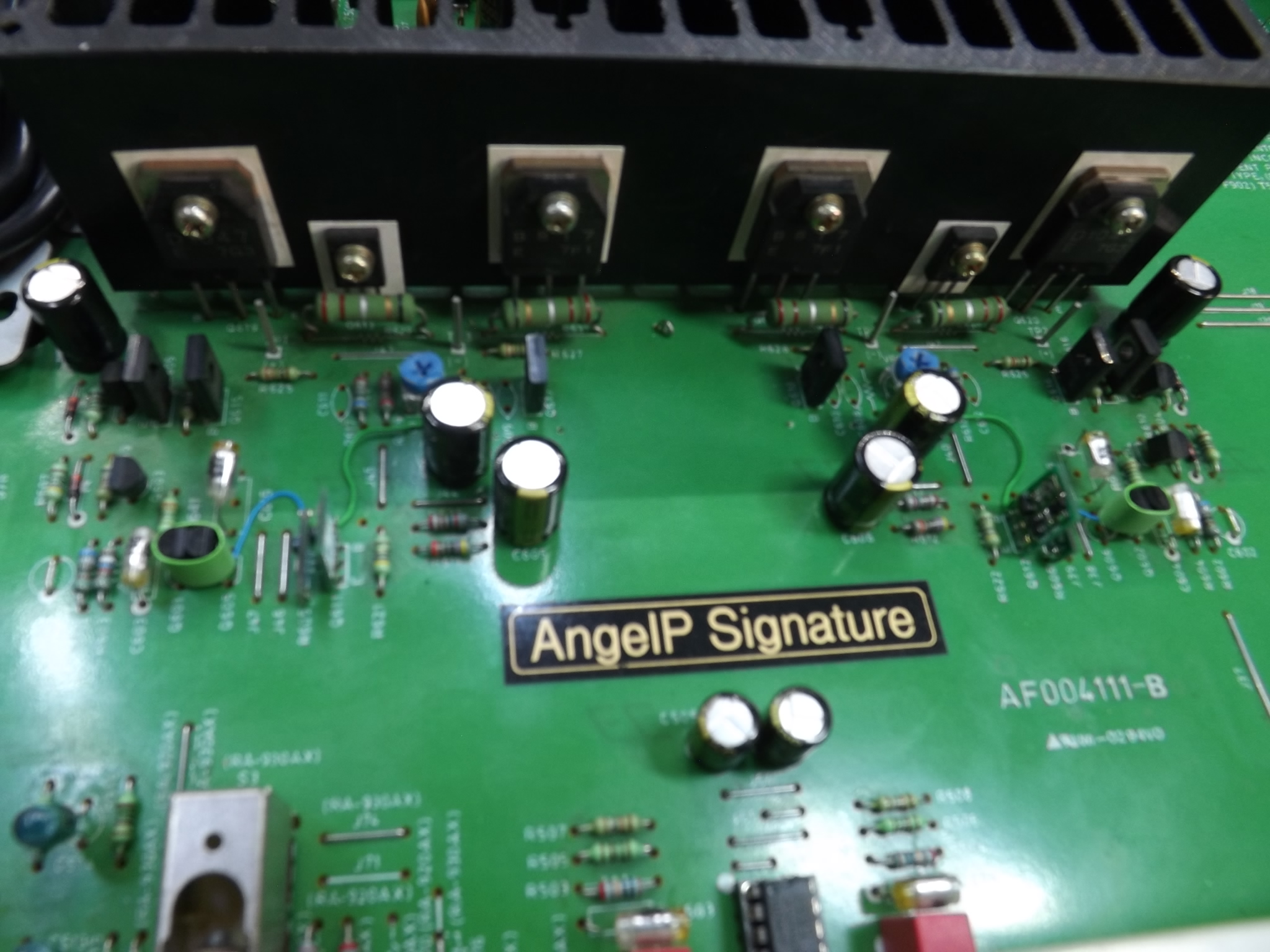

16 ohms is a strange value. But if the short disappears and the fuses stop blowing when you isolate the heatsink the problem probably lies there. The heatsink should not conduct any current.
What I would suggest: First with power off
1) Measure the resistance of the trannies' secondary windings. (Should be <1ohm)
- and then with power on, heatsink not touching chassis:
2) Measure the voltage at speaker outputs (Should be in the mV range)
3) Measure the voltage between speaker+ output and heatsink (Should be 0V)
- if it is a high voltage, power off and
4) Measure the resistance between each power transistor collector to the heat sink. (should be infinite or high Mohms)
If R642 (33k) is down to 4ohm, the parallel 5A speaker protection fuse must have been blown and the output stage suffered a huge current load. But even so, 4ohms is also a strange value..
OR - your multimeter or test leads have a fault. We all tend to trust our equipment readouts more than our own judgement.
Just my 2p,
Per
Been busy with other things recently all the above checks ok seems to work ok with the heatsink isolated but I cannot find why /where it shorts
what is the potential difference between the heatsink and the chassis?
3mv as it is now

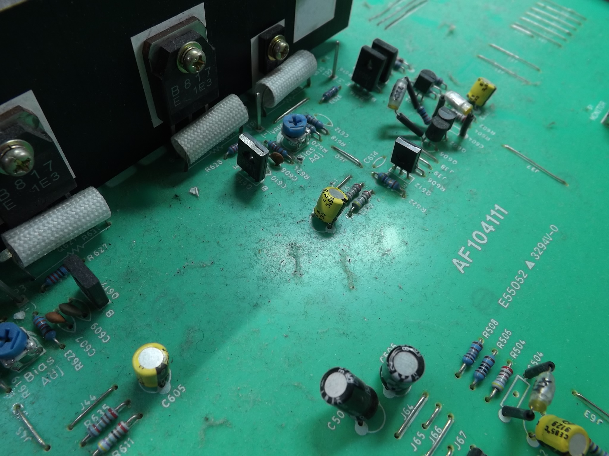

Anyway, here's two "before and after" pics. Cosmetically you could call it "barn find" to "concourse level" - but regarding audio quality it is more like "beam me up".
Per
