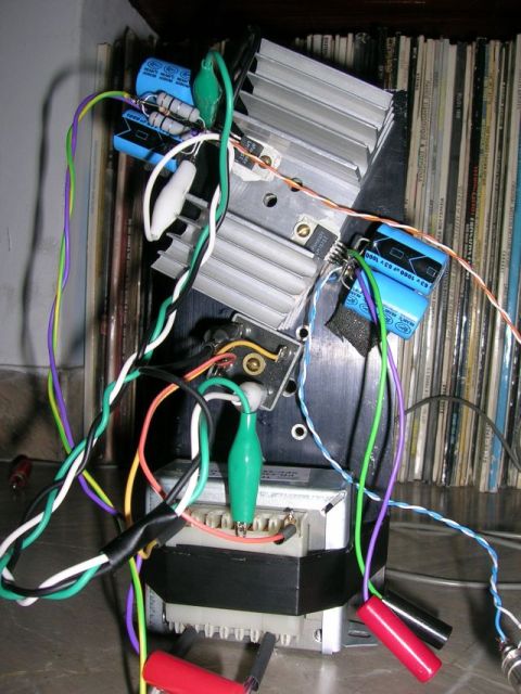

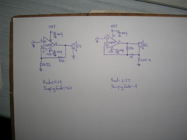

An easy experiment (Merits of Variable Output Impedance Amplifiers)
Hi all
I have asked myself many times why I enjoy so much listening to music through my 6L6 push-pull no global-feedback amplifier.
To be more specific, why is it so that I prefer listening to this amplifier and not so much any other transistor or MOSFET output or chip amplifier (all with global voltage feedback) that I have built?
Well, I could have built the same tube amplifier WITH global voltage feedback to compare, but I have not.
I understand that bringing such a subject in the forum in such a blatant way, is like asking for trouble.
There are myriad of variables involved and each one has to be identified and treated in isolation.
But my queered mind stuck in one of them: Amplifier’s Output Impedance.
Why?
There is a gross difference in this specification between this tube amp (Rout~13 Ohm)and the rest (Rout~0.01 Ohm).
Resulting Damping Factor with 6 Ohm load is ~0.46 for the tube and ~600 for the rest.
I had to build two amplifiers which should differ only in their output impedance to find out.
Rod Elliot’s Project 56 (http://sound.westhost.com/project56.htm )provides a method to vary the output impedance of an amplifier through a combination of voltage and current feedback.
I set-up two bare basic LM1875 amplifiers as shown in attachment.
They both have the same gain.
Quick and dirty implementation seen in attachment.
I listened to them in mono. Sound-wise they possess the difference I perceive when comparing the sound of my tube amp and the rest of my amps.

The reason you hear a difference between these two amplifiers is the output impedance, combined with the speaker's varying impedance. The combination will affect the frequency response, and that is the most audible effect.
I am not surprised that you perceive the sound more like the tube amplifier, but I am surprised that you prefer the high output impedance. This is because most speakers are designed for a 0 ohm driving impedance.
Hi Svante
..but I am surprised that you prefer the high output impedance. This is because most speakers are designed for a 0 ohm driving impedance.
From my limited experience:
Multispeaker units with complex cross-over circuits do match well with nearly 0 Ohm driving impedance, but again not always.
Single unit, no cross-over speakers are breathing better with a positive driving impedance.
With open baffle and rear horn loading it is more evident.
Least evident is with small volume sealed and small volume bass reflex.
Thus, how much high output impedance gives best results, depends on speaker unit and enclosure type.
Also on kind of music to be reproduced.
Rock, techno, rap are best with very controlled mid bass and good attack (low driving impedance).
Symphonic, opera, need extended freq. response, balance, space. For this, higher driving impedance is beneficial.
(I have settled upon my (sad) conclusion that I have yet to hear a system that performs very well with any kind of music).
With the help of Rod Elliot's article, it is feasible to test how much driving impedance is good for everyone's case.
Regards
George
