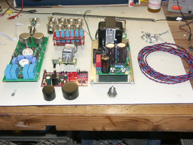

I mounted the power supply and amp their new home and powered it up, the neons glowed for a second and died down but no leds. Then I noticed no filaments in the 6SN7. Power it down and checked and cold solder joint re-soldered and and powered it up and everything lit up. Would have put some inputs and outputs on it and tested but no molex plugs to be found. Decided to ditch the molex plugs and solder silver wire for internal wiring (it deserves it) so had to ordered some wire. In the mean time a pair of Martin Login Electrostats followed me home today listening to some Buddy Guy - the grin on my face is starting to hurt.
