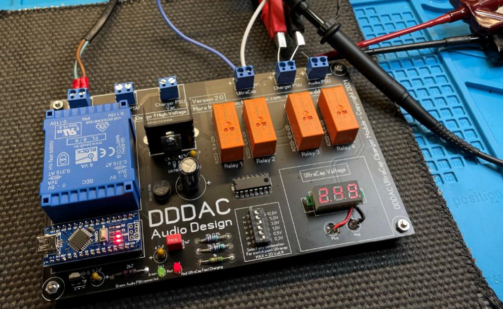

here it is, working fine.
Has nothing to do with Ian solutions, which are very good by the way and plug and play
It is just a management module to quickly charge a UC bank (up to 20Volt) through an external charger (10 A or so) and than switch back to the audiophile PSU which is also externally connected. The module will disconnect the charger and de-power its mains.
The UC Bank should be connected directly at the VB input of the user. Which I believed to be of advantage looking at the concept why a UC helps sound quality (shunt close to user) I know some see this critical for safety reasons, so you can still ad a thick 2 pole switch and disconnect the UC bank when not in use. Up to the user of course
It is a general module where the switch voltage can be set by DIP switches. Nice for experiments (like I do now) or in use with other gear (DDDAC 12 volt supply or Clocks/PCs with 15-18 Volt)
But I am not asking anyone to use this or risk their homes. BTW, DIY always carry risk. No need for UCs for that. If I see all that gear with no safety earth, you might dangle dead to your next tube amplifier as well :eek:
any way, here is a pic:
Probably to much Off Topic, I will start an own thread where we can discuss further if you want (in power supplies)

I admire the passion for the solution. Please let know impressions with Andrea's clock once things are up and running.
Because of the nature of Super Caps and the risks involved, I'm good to standardise with a Ian solution. I already have 3 3.3V UcHybrid, 1 5V UcMate, 1 3.3V UcConditioner and 1 5V UcConditioner so I don't want to mix solutions. A 12V or 16V UcConditioner will blend in nicely. Especially if you have the option to stack on top of MKIII.
I'm not running a lab, but just a simple consumer setup where I have the weigh the risks of points of failures.
My higher priority issue now is researching how to loop a semi-rigid cable around or through the TransportPi after ReClockPi for Andrea's clock.
I do though look forward to impressions with the Super Caps in the mix.
