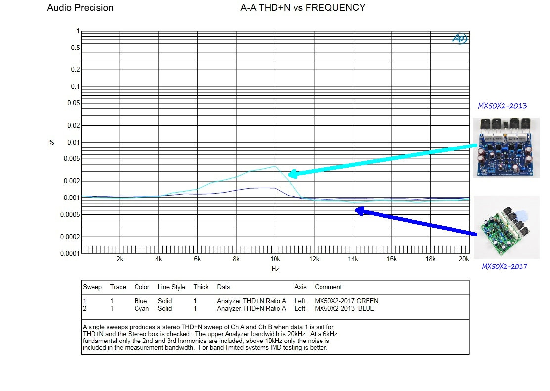

Hello ljmThis is MX50X2-2017 updated version.
It is smaller than the 2013 version of distortion, and stability. And it's fixed.
Don't need to manually adjust.

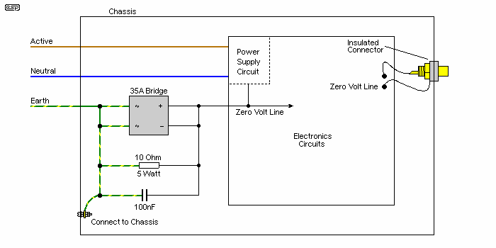

I plugged in quickly to test the MX50X2.
I have a channel plugged in and there is a hum.
Any ideas what I could try?
Thank you,
Denis
This is making amplifiers. Problems we often encounter.
Generally, there are two kinds of noise.
1, caused by signal input. You can try to short-circuit input + - or turn off the potentiometer signal. If there is still noise. The noise is caused by the power supply.
2. Noise caused by power supply. The common situation is switching power supply. Or transformer interference.

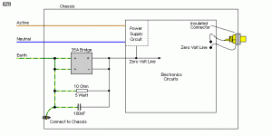

Hi LJM,
Thank you for your support. This is not a hum caused by the input signal but rather by the power supply, which by the way, very good quality.
I solved the hum problem. I build an "Earth loop breaker" based on the circuit discussed by Rod Elliott. So I have a functional channel, I still have to mount the 2nd channel.
It is a prototype assembled quickly to validate the quality of the amp. If I am satisfied, I will order a new case.

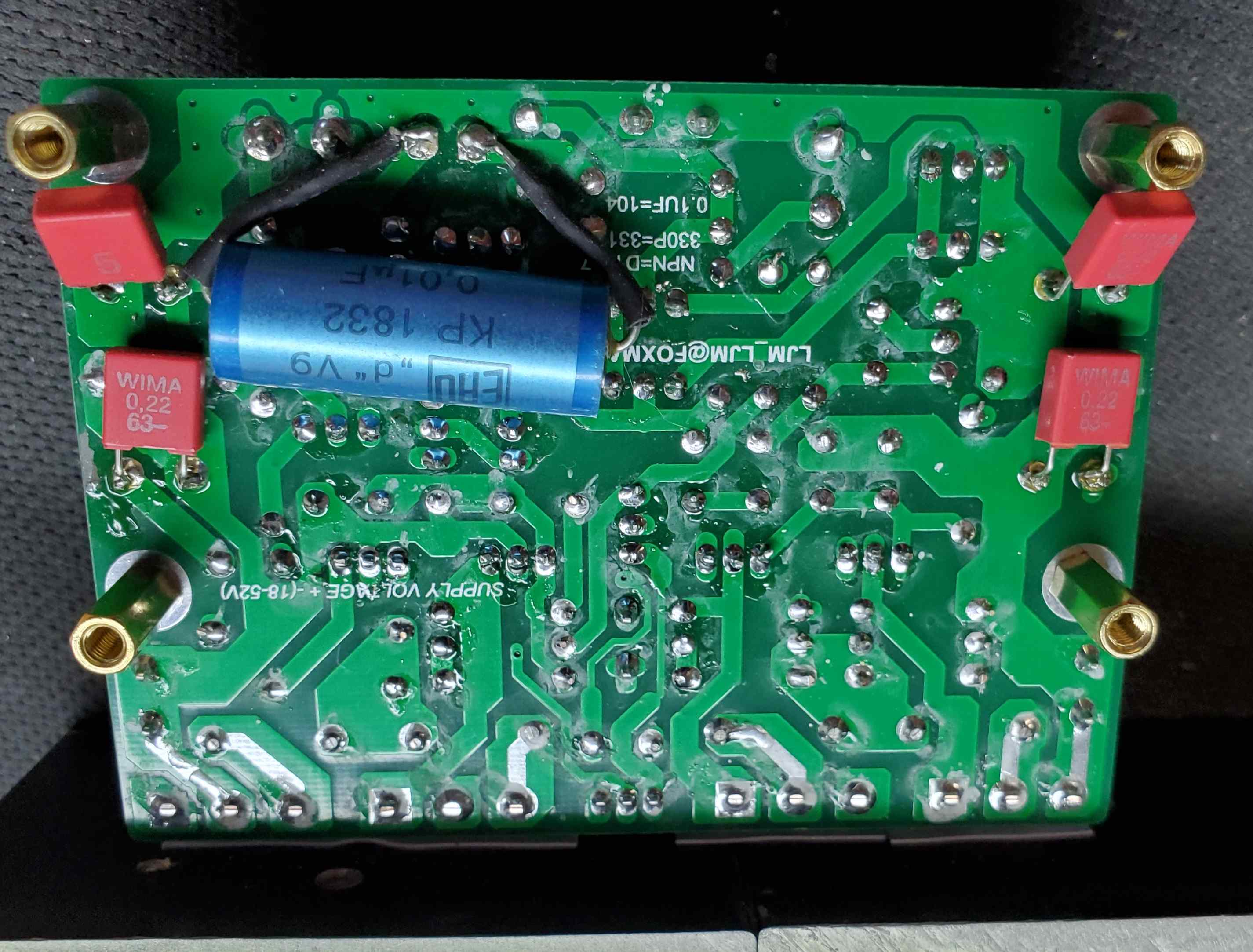

here's a little feedback on the tone of the MX50X2. I really like the sound of this amplifier. At first I was a little skeptical.
I found my L12-2 superior especially in the mid-high and high resolution.
On the MX50X2, I changed the input signal condo with the addition of an Ero MKT bypass, and some Wima bypass condos on the power board condos.
Then I received a new DAC based on double ES9038 and racing OP. In short, the result is above my expectations, the soundstage and the volume and positioning of the instruments is higher with the MX50X2 than the L12-2.
Make no mistake, the well-powered L12-2 is still a great amplifier, but the MX50X2 has a lot more depth in the soundstage. Also with the small modifications on the PCBs and my new DAC, the MX50X2 comes close to the resolution of the L12-2 in the highs, at least that's amply satisfactory.
But I would have liked the L12-2 to remain the best, because of the case and its power supply.
