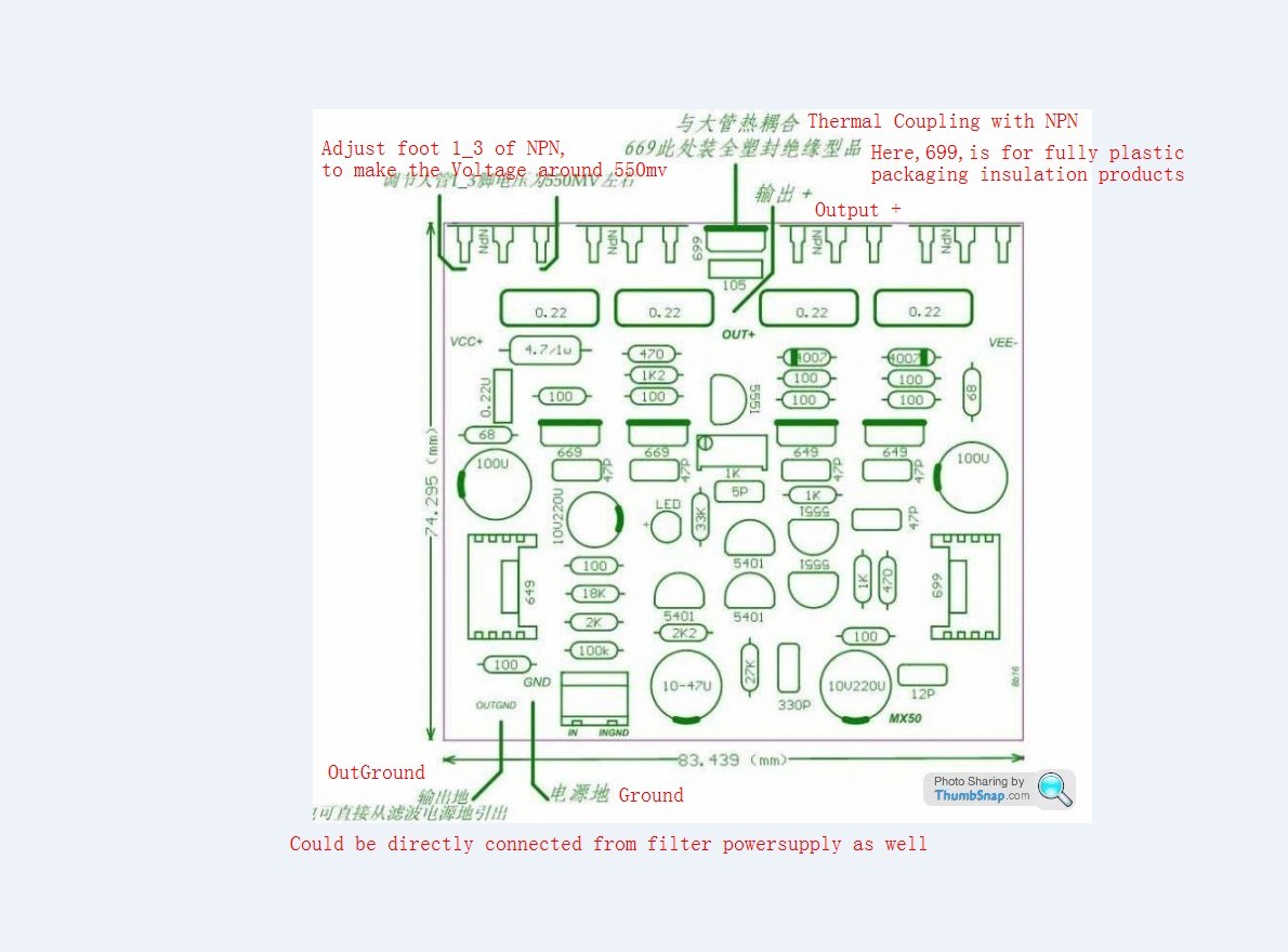

Hi! fi have a problem with my MX50 x2. i buy this tansformer 300W 220V Toroid Transformer for Amp 28V 0 28V 12V 2 6V | eBay then i buy this power supply board Assembled Nover Rectifier Power Supply Speaker Protection Integrated Board SN | eBay and i buy 2 mx50x2. I gathered mx50, connected to the power supply board and transformer. And one of the boards mx50 burned. In what may be the reason? where to look? or advise another set of amplifier

All it would take is the bias pot adjusted to the wrong end of its travel on 1st power up.

"Bias" has to do with current being drawn through the circuit with load, but no source. It has to do with the amplifier's functional circuit.

And what is the problem with the trim of the bias?

One certainly does need local decoupling at a distance of an inch or so.
That inch or so implies a minimum flow and return circuit length of >50.8mm
That is enormous.
Yes. And we don't know the exact ESR and inductance of reservoir capacitors (which are in the audio path...) Thus, I always put 1 uF film capacitors directly soldered on the PCB with short leads from rails to the output gnd (same as the Zobel Network). Correct wiring is mandatory, with 1.5 mm² (min) wire (+ - and gnd)
Another questionnable matter is the lack of small resistors (~47 ohms) in the emitters of input transistors ; very helpful in order to improve stability. And in the emitters of current mirror also.

I would put a meter in series with the +50v supply and adjust the bias for the recommended level of quiescent current but I cannot find any recommendation from the designer of the kit. I can get at the emitters of the output transistors
which are connected to 0R15 resistors (supplied instead of 0R22 as stated on the board)., but it would be easier to measure the total current Perhaps someone has information on the level used by Musical Fidelity in their XA50?
