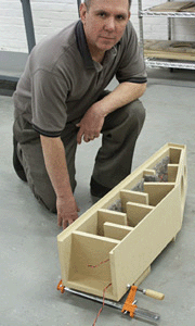

Ariels
Dave,
The Ariels DO use stuffing, both in the straight portion of the line and in the labyrinth. It also has felt glued onto the straight portion. This is at least when the speaker was first conceived, and how I built them. Maybe things have changed. I know that the whole mysticism of the Ariels have gone to a certain designers head and he likes to play it all up. If you read the original article, it's quite different than todays "revised" thesis!
I don't know if the Ariels can be considered a TL, Lynn calls the upper portion a line and the bottom portion a labyrinth.
Hey, have you seen the inside of the Meadowlark Kestrels? It uses a labyrinth!
Ron
Dave,
Ron
