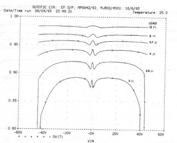

There are some definition of "non turn off" output stage. Some say never turn off (every output transistor has a certain bias current flowing all the time) is enough. Many patents like from Japan are about this.
But some give "harder" requirement, that is the continuity of Gm. In classA, Gm is relatively constant even in handover (crossover) around 0V from PNP to NPN vice versa. In lower than classA bias, there will be dip or valley for Gm curve around 0V. Douglas Self book shows these graphs.
Many "Non turn off" output stage cannot fit into this 2nd criterion, even all output stage transistors never turn off.
