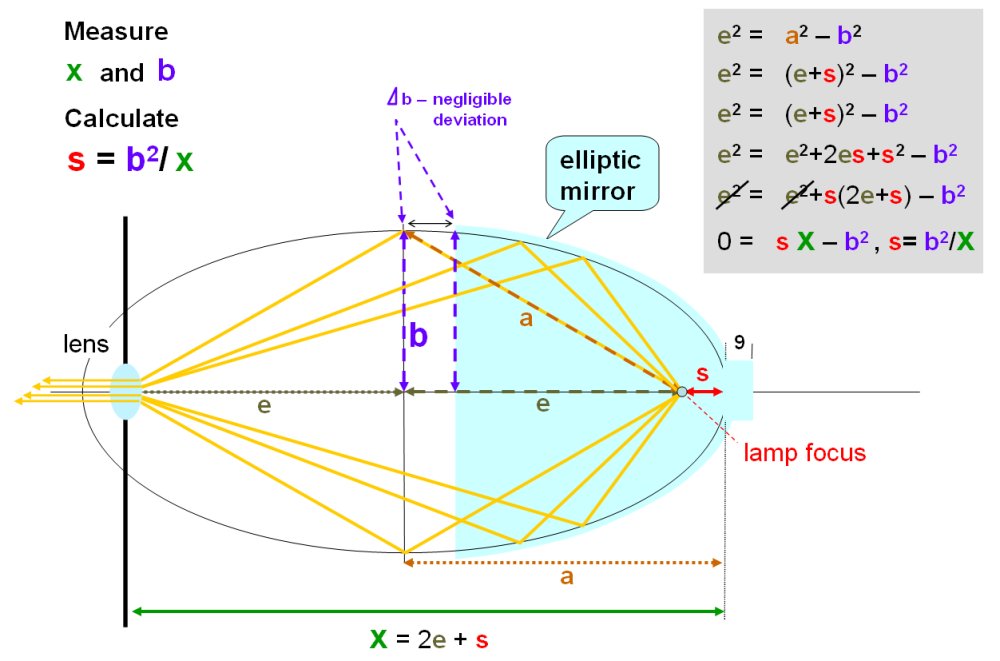

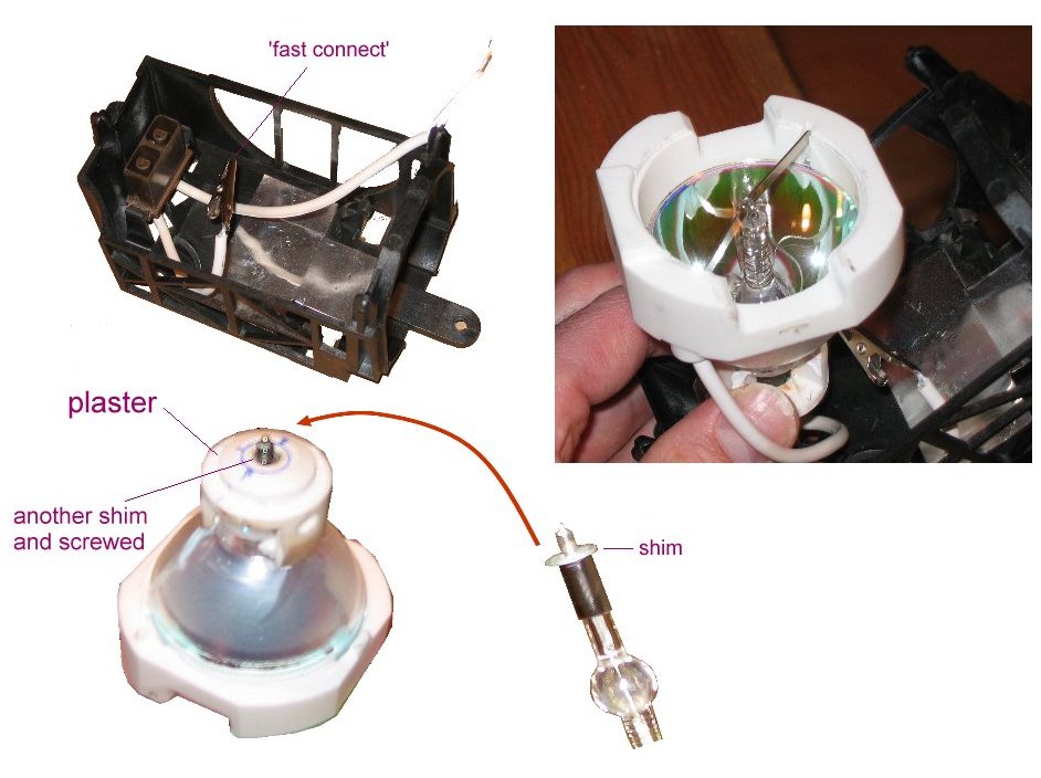

last weekend I succeeded with the new lamp from ywh. I still have to do little adjustments because the picture isn't as bright as expected (add a shim or two may help, I hope. This is possible because I screwed the lamp and used plaster only for ceramic parts). The LP350 did run for 3 hours continously now without any problems.

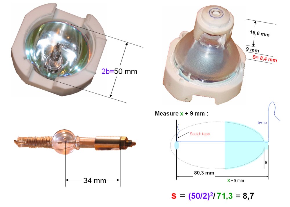

The main issue was to get the focal point and I did some mathematics. It's an elliptic mirror and ellipses do have two focal points - thats the starting point.
I hope the following pictures (this and next posting) are self explaining. First step is to measure the distance between lens and the reflector base with a twine and also get the mirrors front diameter. Then you are able to calculate the focal points distance from the reflectors base (the arc position) using the formula I found.

But you don't know for sure that the edge between the neck and outer ellipsoid is in the same plane with the edge between the inner neck and ellipsoid, as if neglecting the reflector glass thickness.
The approach is good nonetheless, well done.
So are all or most comercial projector reflectors using ellipsoid mirrors? Are they using divergent lenses in the second focus then?

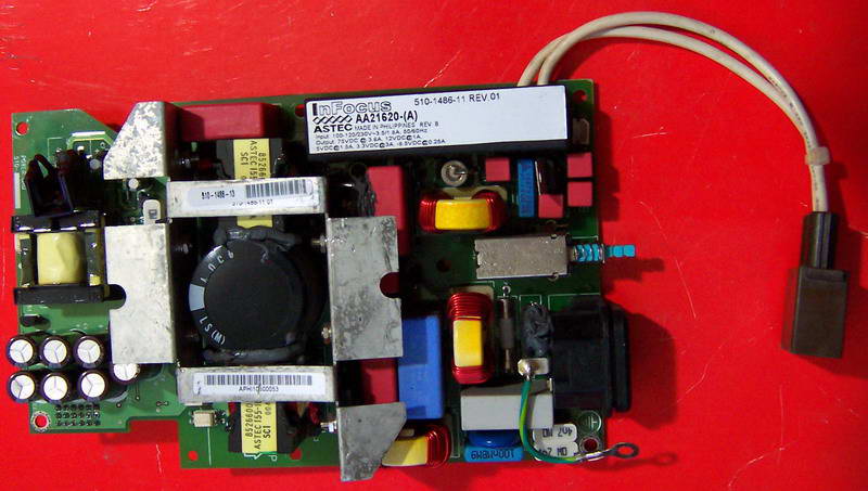

childsid said:Dumbfounded ,
About 70 of the LP340 & a ton of 350 had bad power supplies mainly from poor design & overheating. I don't know the particulars as I am not an electronics Guru. I do have a repair man that does an excellent job at fixing them. I paid for parts which averaged about $6 each & he charged me for labor seperately bases on repairing about 70 or so. If anyone needs a power supply I can get theirs repaired or perhaps sell one, repaired & refurbished at $75 plus shipping..........
Thanks,
Jim
Hi childsid
I have a 350 which hasn't been upgraded (bought it with a blown lamp) - Given that I'm a long way from the US, could you possibly let me know which parts you bought (sounds like fairly basic parts if they only cost $6 per unit ) and what is done by your repair man to fix the power supply??
