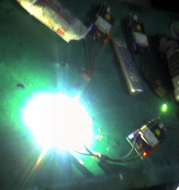

early signs weren't positive :( - but keep reading
the top indicator leds were flashing green - on/off, red on/off, don't know precisely what that meant, but it might have been a sign that disco is coming back !
unplugged and checked the wires i'd shoved in the connector were well in, and restarted the machine...i've now had several successful power-ons, initialisations, short runs and power downs...i think we have lamp-off ! ;)
i'm currently 65 minutes into an apparentlly successful continuous run (green indicator steady-on/green), and will update what happened over some hours - if it stays running
highest temperature i recorded was one of the coils in what has been described as the split power supply - 48 deg c
only other thing is the noise !...flight 153 now taxying !...could any kind person tell me the simplest most electrically efficient fix to remove the cooling fans, or if any old led or what resistor might take their place ?...i think i should leave the small split psu fan as i reckon it's near silent...i have some 510ohm resistors - would they do for the lamp/lcd cooling fans ?...thanks from mr thick !
the torch i was charging up showed virtually nothing in the way of detail or brightness at the lens, so i may have to run the uhp lamp off my other lp, and run the wires to this modified one so it has an electrically seperated illumination to really check what the lcds are doing...to be honest, i am as doubtful as anyone that leds will really light such clonky, tortuously constructed machinery, but if there's a way, i'm determined to find it, even if 80% of the original light engine goes in the bin (well, on ebay)
