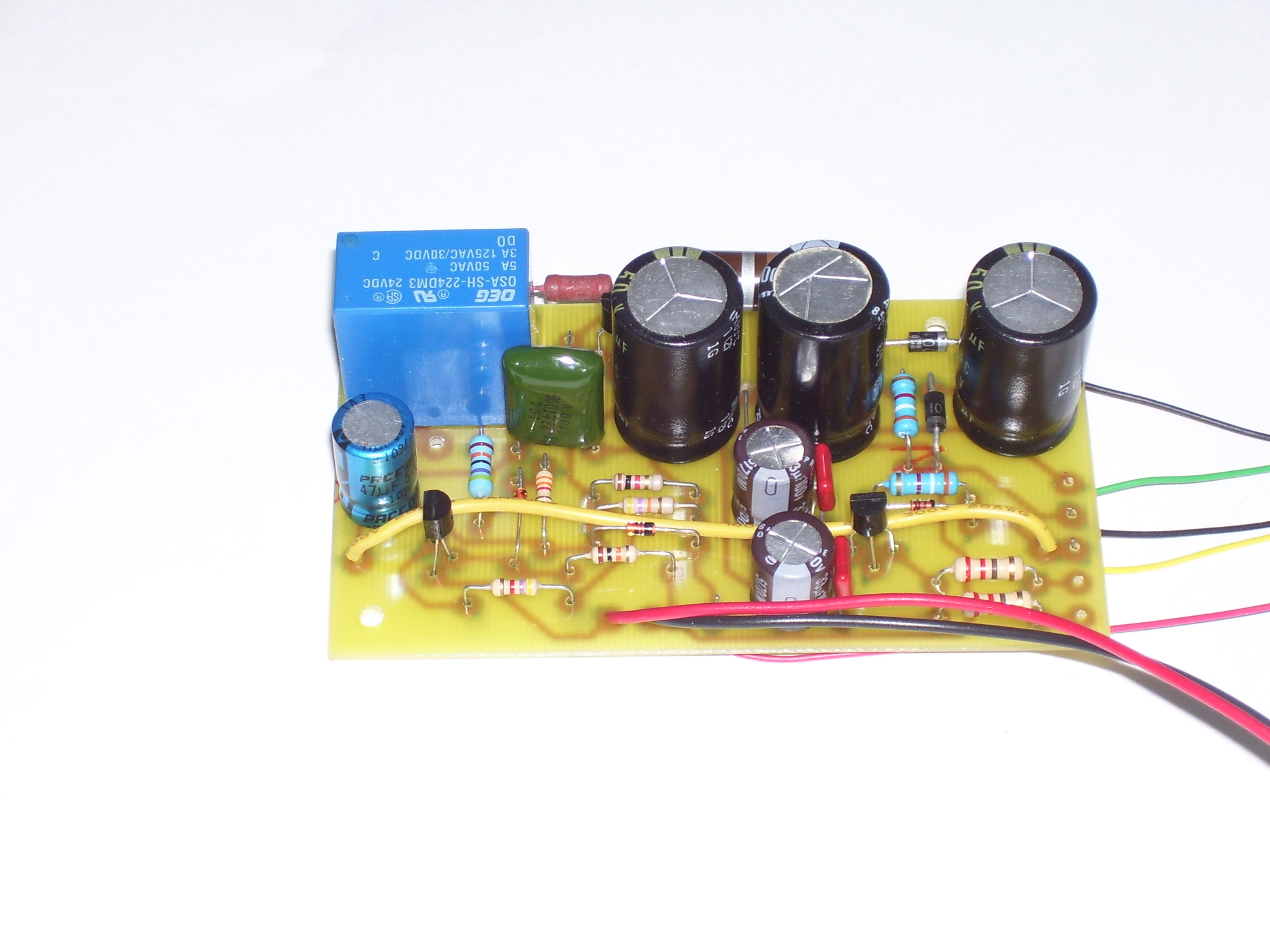

Hi mill,
It sounds very much like one of more transistors are shorted inside your lamp power supply causing the rectified mains voltage to go straight through to the lamp!
When 240V ac mains is converted to DC, you get a voltage of 340V DC. I'm not sure if this would kill the lamp or not, because the lamp needs an arc to get it started anyway??
I wouldn't have thought a power supply leaves 340V across the lamp when it's idle, but I could be wrong on that.
Can anyone confirm this with their own thoughts?
Also, I have an ASK Proxima DS1 projector (SVGA DLP) which has a blown power supply. I'm intending to retrofit a new ballast and power supply as I've worked out all the low voltages needed to run the processor boards....
@jwh or 18wheeler, I you still selling the electronic ballasts? Which lamp do you recommend if I was buying a new ballast to go with it? ie. is the JYd lamp more efficient than the JYs lamp etc.?
Thanks,
OzOnE.
Thanks,
OzOnE.

@ywh, I will have to try the 150W lamp and ballast as my power supply is beyond repair, so I've decided to retrofit a new power supply and ballast. Could I please have the total price for the 150W lamp and ballast including postage to the UK? (whichever type lamp goes with your ballast, I don't mind).
I have some useful information for anyone wanting to fit a new power supply to their Proxima DS1 projectors....
I couldn't find a service manual at all for the DS1, so I reverse-engineered the power supply and found all the voltages needed to run the main processing boards, fans, DLP chip and colour wheel etc....
These pinouts are for the main power cable, but the colours and numbers are taken for the "motherboard" end NOT the power supply end. The wires are in a different order at the power supply end. If your original power supply is definitely broken, and you want to fit another one, just chop of the power connector at the power supply end!!!.....
1. BLACK +12V (for colour wheel and fans etc.)
2. WHITE GND
3. YELLOW +3.3V
4. ORANGE +3.3V
5. RED GND
6. BROWN GND
7. GREY +5V
8. PURPLE +5V
9. BLUE GND
10. GREEN GND
11. RED +12V (for speaker amp etc.)
12. BROWN GND
So, if your Proxima DS1 has a very broken power supply, you can use these pinouts to run the main boards. You will obviously need to fit your own lamp and ballast though.
You can connect all the grounds together, and also connect the +12V lines together. The above pinouts are tested and confirmed to work fine with a PC power supply. I can't be sure that all Proxima DS1's will have the colours in the same order or different board designs, so - I accept no responsibility for any damaged caused while using this information!!!
The Proxima doesn't require a huge amount of power to run the boards. The original regulator for pin 1 (12V), is only rated at 500mA max, and pin 11 (12V) is rated at 1A max. Here are the currents found when testing my Proxima.....
+3.3V (orange / yellow) 750-1000mA in standby, 1.3A at power-on
+5V (grey / purple) 750mA in standby, 790mA at power-on
12V (black + red combined) 520ma in standby, 1A at power-on
To force the projector to turn on, you need to short the "lamp lit" photocoupler...
There are four TLP621 optocoupler devices on the lamp controller board, they are labled PC1, PC2, PC3 and PC4.... PC1 appears to be the "lamp sync" signal to the power supply and is syncronized to the colour wheel. PC2 is the "lamp on" signal to original the power supply. PC3 is the "lamp lit" or "lamp OK" signal to the motherboard and this is the one you need to short to force the projector on. I'm not sure what PC4 does, but I didn't need to use it anyway. Here's the pinout of the small 8-pin to the photocouplers....
1. BROWN PC1 anode
2. RED PC1 cathode
3. ORANGE PC2 anode
4. YELLOW PC2 cathode
5. GREEN PC3 emitter
6. BLUE PC3 collector
7. PURPLE PC4 emitter
8. GREY PC4 collector
So you need to short the green and blue wires (pins 5+6) on the small 8-pin connector which goes to the lamp controller board inside the power supply. I will try to attached some photos later.
Hope this helps someone. Maybe we can build a collection of pinouts for different projectors? @mods - please feel free to move this post as I'm not sure if there's a better place for it.
OzOnE.
