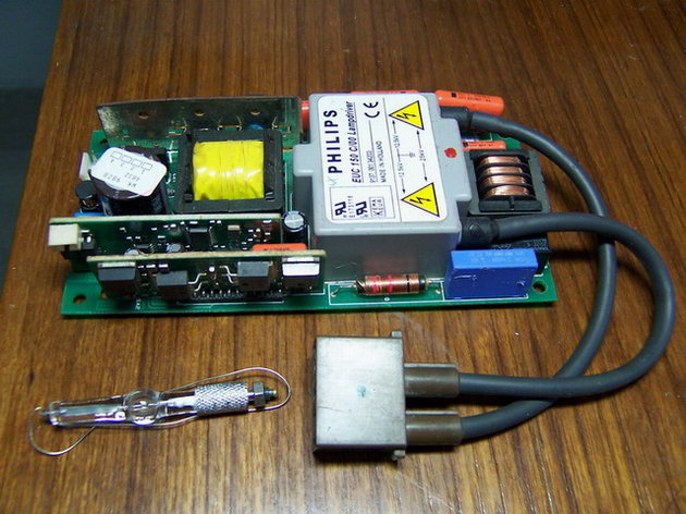

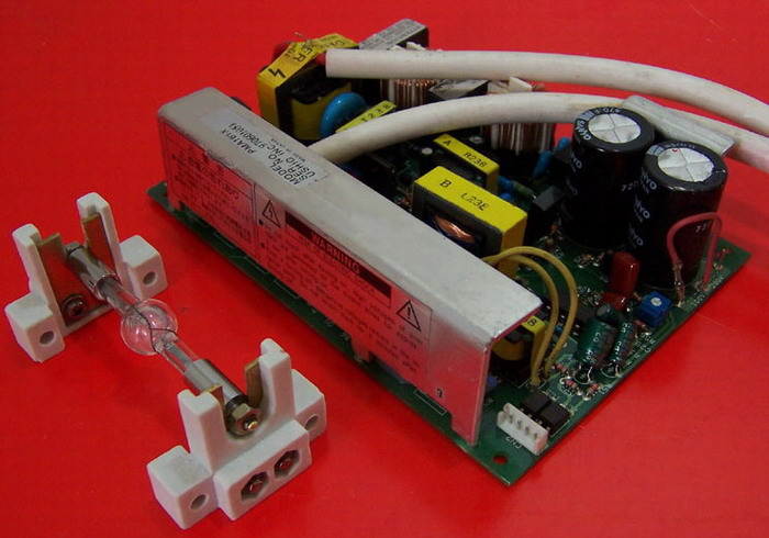

Hi OzOnE_2k3
yes, 18wheeler have the 150W ballasts too, that is 160w and JYS lamp,but the lamp is double end, have too metal end, you need take off one metal end.can you do spot welding?
or I order other and single eng jys lamp and ballast for you. this have 4 pins like yours,I think that is easy to replace.

yes , 250W ballast an e-ballast too big, if you have space that is good way.

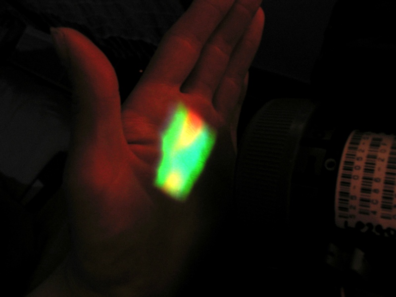

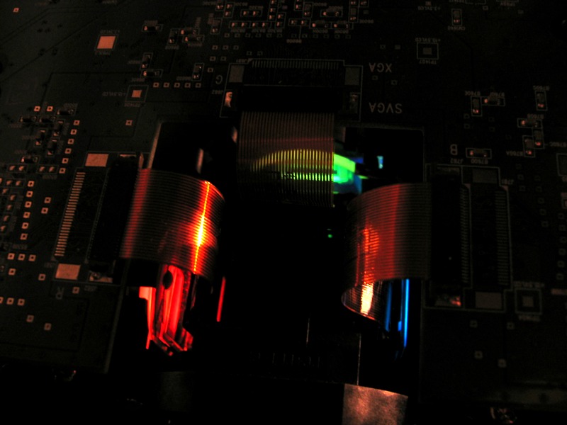

hi all and thanks !
OzOnE...yeah, i saw those laminas early in my intertravels, but rather ruthlessly discounted them because i think that more can be achieved with those luxeon leds (app1000lm per 40mmx40mm), though i'm certainly not above being corrected !
i'd be quite happy to run little leds or resistors in place of (i.e. plugged into the fan connectors on main board) the non-psu fans, as long as those resistors (if used) don't cook or cook anything else
i suppose the lcd cooling fans will be obsolete if the lcds are being lit by uv/ir free light source ?
it is possible that the sensing circuits may be so clever as to spot a premature 'lamp on' signal, but i think in the case of my lp240 and lp250 at least, there is a three to five minute delay in collection by the board, of the lamp on signal (otherwise known as the initialisation period) for precisely the reason that (in the case of my infoci) the projector lamp has a chance to provide said signal to a waiting board, without the synchonisation issues that may have arisen from the board sensing pre startup signal - lamp igniting signal - lamp lit signal
phew, did that make sense ?
my lp running without a lamp, it really is working...wuhooo !
hi ywh,
Is the photo in your last post the newer 160W ballast?
Do you still have the other ballasts available? (photo attached)
The above 160W ballast looks fine though if it's the newer type.

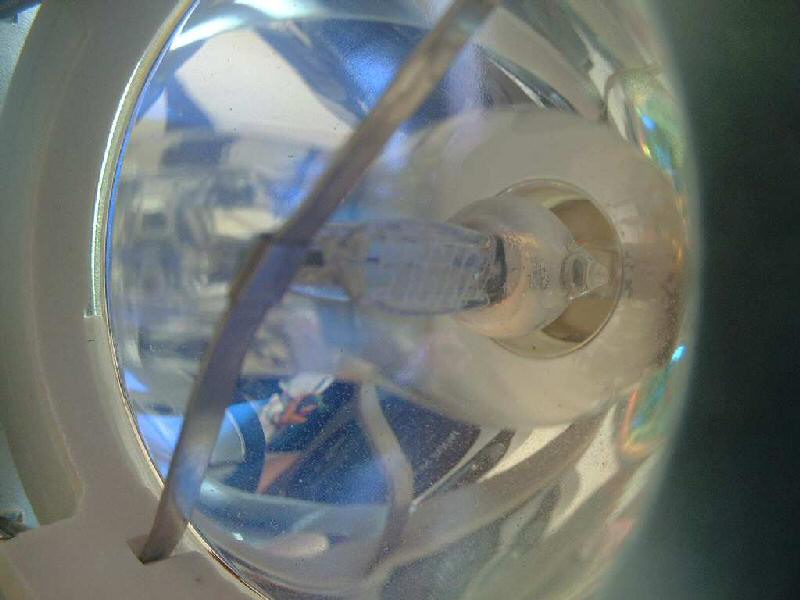

I wouldn't know how to remove the spot welding on the metal tabs, and my original bulb is only around 65mm. I could probably fit a new bulb with a maximum length of around 90mm though.
Double-ended should be fine, but I'm not sure about the metal tabs?
OzOnE.

Excellent news throwit!
Does your projector only enable the LCD's after the warm-up period?
Can you get any decent size of image when using the torch (experimental I take it!)?
You shouldn't need to have resistors in place of the fans in most cases (AFAIK). Most projectors I've seen have three-wire fans, with the separate wire for RPM detection. You'll need to fake this signal somehow to stop the PJ shutting down.
Although, if you have any two-wire fans that you're sure you won't need, just try unplugging them and see if the PJ still runs.
EDIT: P.S. Where did you get your torch, is it the white-LED one?

hi OzOnE
sorry 'bout late reply, technical issues with laptop
edits...i think there's a half hour ceiling on edits, to stop us swearing at each other, letting the next post retaliate, then reverting our post to pleasantries - or something
lcd function is almost instantaneous, only thing stopping me knowing if it's actually instantaneous is a) the wait for uhp lamp to warm up, and b) i haven't got round to having the torch going before the projector starts up, because c) the torch is one of those yellow beamed, pistol gripped supposedly very bright rechargeable types, but it only works continuously, very brightly, for a few minutes, it's basically one of those incadescent car headlamp types, and most of the light was missing the lamp aperture, which still had all it's whacky baffles and filters in place
unfortunately, thus far, the biggest i can go is large stamp size with the image, some way to go yet
the fans are two wire, and within three minutes of either startup (with a fan unplugged) or unplugging, they trigger a 'fan failed' on screen message and shut down...what would it do if i shorted each unneeded fan pos to each neg in the connector ?

So, the plot thickens. I've also noticed that many ballasts require a proper "sync" signal to syncronise the lamp pulses to the image frames (especially on DLP projectors). This complicates matters even more.
The original ballast / PSU from my Proxima DS1 uses a sync signal, so it would probably shut down without this signal (if I could be bothered to repair it first of course!).
But, if you're just looking to keep the projector from shutting down without the original ballast, then it should hopefully be a bit easier to do.
On the InFocus X1 for example, the "lamp enable" signal to the ballast starts at 2.7V, then rises to 4.2V when the lamp is warmed up and fully on (this is only the signal TO the ballast to start it, the "lamp lit" signal TO the projector looks like a standard fully-ON logic signal.)
If the projector receives linear voltages or other signals from the ballast, this would obviously be much harder to fool!
Like a normal transistor, optos can be used for either full ON / OFF logic switching, or they can send a linear voltage instead. Some projectors might use this linear signal for current or possibly temperature sensing of the original lamp.
"But, if you're just looking to keep the projector from shutting down without the original ballast, then it should hopefully be a bit easier to do"...does that apply to me ?

Hi ! OzOnE_2k3
the 160W ballast is PMA161X USHIO INC
http://www.diyaudio.com/forums/attachment.php?s=&postid=674603&stamp=1120377874
http://www.diyaudio.com/forums/attachment.php?s=&postid=674697&stamp=1120397595
this PDF is nice, can you find other file of

in this pic:http://www.diyaudio.com/forums/attachment.php?s=&postid=951796&stamp=1151679818
this is a vacuum seal on the bulb. the vacuum seal is the bump thing on the ball part.
If there is seal, JYs lamps are needed.
If there is no seal, JYd lamps are needed.
