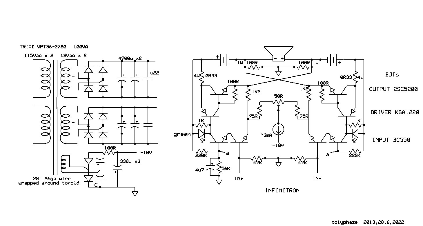

Please publish a more "beginner friendly" full circuit diagram with device numbers etc, and some build details/tips, and a thru-hole component PCB design. It will be of great help to people wanting to explore the Infinitron.

Thanks for the kind words.
My Infinitron has been in continuous use since built. It sounds so much better than the amp it replaced, a very complex (and costly) mosfet circlotron by B.A.T.

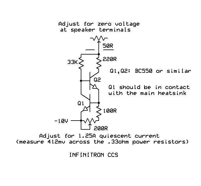

I have attached an updated schematic with more details for diy. Also attached is a separate schematic detailing the constant current source (CCS). This is a modification from the original, so the PCB is not quite up to date.
The PCB was a challenge (for me anyway) because of its density, as I had chosen a chassis that had limited space and had to make the PCB smaller than optimal.
Finally, I have a simulation using Paul Falstad's simulator, available at: http://www.falstad.com/circuit/
I could send you the code if you wish to try this.

@ Polyphaze
Much thanks for the updated schematic and the other details.
Surely the fact that you've been listening to the amp since its first build is worth a complimentary build from some of us, I think!
Not every one of us is a circuit geek, and many of us could benefit with a brief explanation of the circuit and its working/advantages etc. That is how, at least in my case, we learn stuff.
As for the PCB, your design could serve as a guide for other builders. So, kindly post yours. Now we have now excuse to wait further before ordering the parts and warming up the soldering iron!
