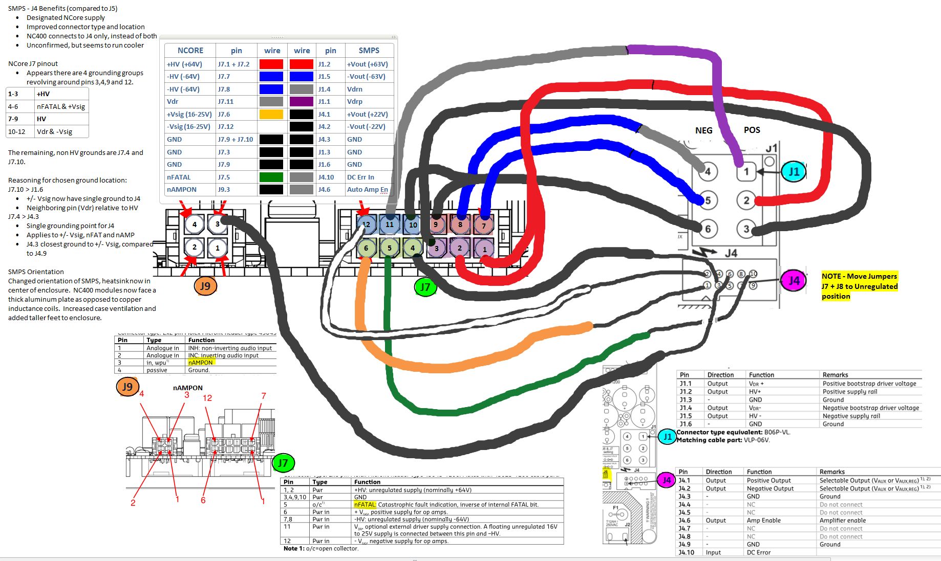

I've wired mine the opposite way (NC400 to J4 instead of J5) and can confirm it works as well.
As far as I understand (don't have a SMPS1200 handy to verify) J4.1/4.2 and J5.3/5.7 are connected to the same aux feed, so it doesn't matter which one you use - it only matters from a connector/cable loom point of view.
@Stenachio: yes I now see Hypex have revised the SMPS manual last november. It does indeed seem to point in the direction of using J4.1+2 as opposed to J5.3+7 if combined with J6+J7 jumper settings. I also wonder what impact regulated vs. unregulated has both on performance and power consumption from smps and modules. Please share any feedback you receive from them!
Hypex support replied back stating that their original (SMPS1200A400 to NC400) wiring diagram is correct.
I just finished wiring mine the opposite way and confirm it works as well.
@Julf - Apologies for the double-post. Forgot to mention the "official" reply from Hypex support.
They didn't mention the jumpers and appeared to write it off the proposed (J4 vs J5) alternative as "6 of 1, 1/2 dozen of another". Their reply was rather terse:
"The diagram is correct. The voltage on J5 is always unregulated, regardless of the position of the jumpers."

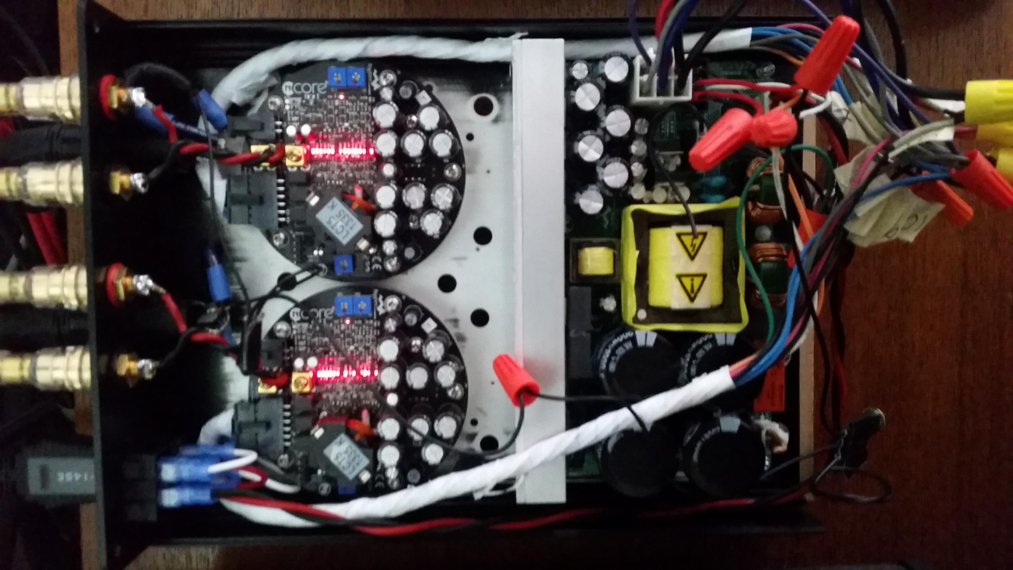

After closely reviewing the manuals I made several changes to the ground locations and elected to use J4 exclusively for the NC400 instead of a combination of J4 and J5.
It sounds great and appears to run much cooler, more like the expected +5W dissipation. Hopefully I'm not a simply a victim of expectation bias and some of the more seasoned members can confirm/deny any factual basis.
Please be advised that there's still a great deal I don't yet understand about electronics. The alterations to the Hypex recommended wiring approach were largely based off careful observation and deductive reasoning, so hopefully there aren't any glaring errors. Comments/criticism on the changes are most welcome.
Here's a summary of the changes. (also listed on the attached image for easier reading)

Changed orientation of SMPS, heatsink now in center of enclosure. NC400 modules now face a thick aluminum plate as opposed to copper inductance coils. Increased case ventilation and added taller feet to enclosure.
SMPS - J4 Benefits (compared to J5)
- Designated NCore supply
- Improved connector type and location
- NC400 connects to J4 only, instead of both
- Unconfirmed, but seems to run cooler
- Appears there are 4 grounding groups revolving around pins 3,4,9 and 12.
+HV
4-6
nFATAL & +Vsig
7-9
HV
10-12
Vdr & -Vsig
The remaining, non HV grounds are J7.4 and J7.10.
Reasoning for chosen ground location:
J7.10 > J1.6
- +/- Vsig now have single ground to J4
- Neighboring pin (Vdr) relative to HV
- Single grounding point for J4
- Applies to +/- Vsig, nFAT and nAMP
- J4.3 closest ground to +/- Vsig, compared to J4.9
