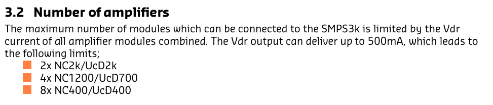

And talking about the nc amplifiers... have anyone noticed the part from the documentation of the SMPS3KA700 (view attachment)?
Seems like if there is a nc2K out there somewhere
about that bwt.

Hmm, I did not think about the fact that a single large power supply will have more reserve. I did think about the crosstalk.Separate supplies will perhaps provide a bit less channel crosstalk (but how much do you need?), but one single more powerful supply will have much more reserve, especially in active systems where not all amps are required to provide full power at the same time.
So, let's say I need to power the speakers of a 7.1 setup.
In this configuration you will normally have only a number of channels driven at any time.
For the mains I would build two mono amps with one SMPS600 pr. amp. That way there will be no crosstalk on the main channels - that also will be used for hifidelity music listening in stereo.
But then it would probably be a very good design to have 5nc400 powered by one SMPS3KA400 as these channels rarely will have full power to all speakers - and the powerful SMPS3KA400 will be able to deliver a huge amount of power to the speakers that would need max power.
As hypex say one SMPS3KA400 can power 8 nc400, using it to power 5 should still leave a lot of powers in reserve. And again, this is MUCH cheeper than using 5 SMPS600 or 2 SMPS1200A400, and gives a lot more power than both the other options.
