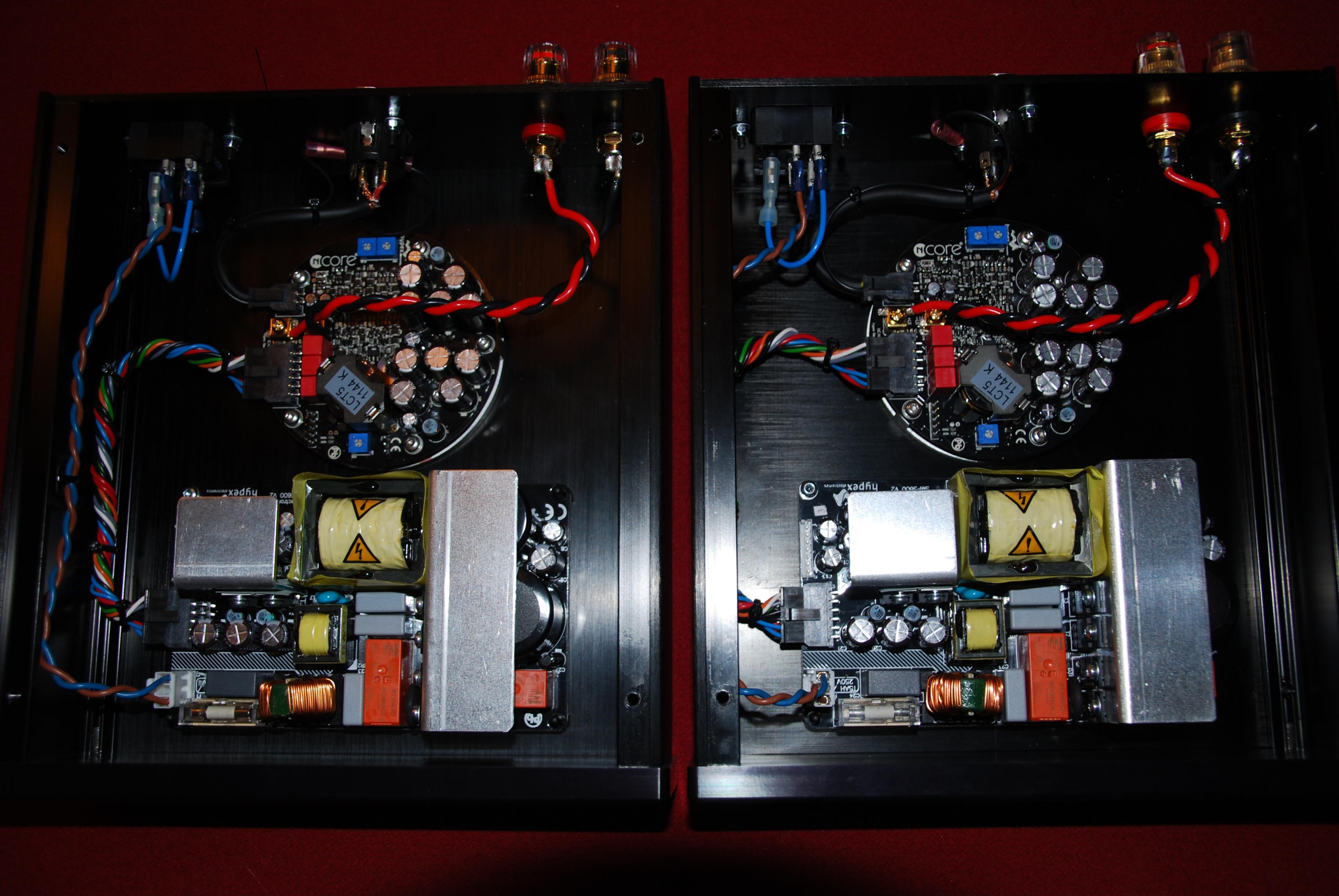

Quick build question...
I am deciding on how to terminate the speaker wire leads to the nCore module. My first plan is to use silver plated copper wire, and use it without tinning in order to obtain the best contact in the terminal clamp. I know the wire will creep over time allowing the terminal connection to loosen, so my plan is to check it daily for a few days, and tighten the terminal screw to take up the slack. After a couple tightenings like this, I suspect it will settle down and remain tight for a long time.
The other option is to go ahead and tin the wire, and tighten twice, but the connection with the terminal will not be nearly as good.
What do you folks think?
Third option is to use small fork (or ring) terminals attached to the speaker cables with a crimping tool and bent 90 degrees from the joint. I think that is the way the speaker terminals are meant to be used especially with thick speaker cables.

Thanks for the feedback.
I used 12AWG DH Labs wire (silver plated copper) bare on the terminal end. Did exactly as you said...checked the torque for a few days and it was fine and still is after a few months.
