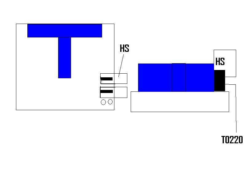

Everybody and his cousin mounts TO220s without heatsinks, in spite of the 85% or so reduction in rated dissipation. So the heatsink police won't come knocking at your door... this time.
Any harm in adding some heatsinks? I was thinking clip-on types with one half cut off, so that it presents a vertical profile to the board components (read: doesn't overhang anything). Are the heatsink tabs grounded? do they need to be isolated from one another? I hope the attached diagram makes it clear.
