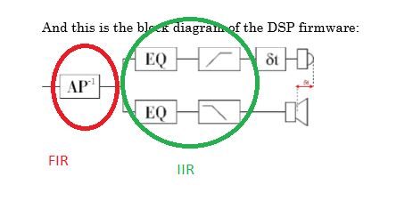

Have a look at the DSP diagram from the LS1:
All eq and xover points are done with IIR. This gives a very nice minimum phase result and everything sums correct. If you take a look at the absolute phase you will see a 360 degree phase shift at the xover. This is corrected with the Fir in the input channel. It's only correcting this shift and nothing else. But you can do this also with a IIR all pass which is non- casual. In the low latency mode this Fir is switched off. Up till now I haven't heard anybody detecting an audible difference.

The result is NOT minimum phase. This is why the AP-1 stage is needed.All eq and xover points are done with IIR. This gives a very nice minimum phase result and everything sums correct.
Exactly - this is NOT minimum phase!If you take a look at the absolute phase you will see a 360 degree phase shift at the xover.
What do you think happens when you apply both AP-1 and HPF in sequence? The answer is - it forms a linear-phase filter of the same frequency-response slope as the HPF. The same happens with LPF. This only works well because the magic of Linkwitz-Riley crossovers when both HPF and LPF have exactly the same phase response, so - it is just an optimization of (idealistic) linear phase LR crossover. Nothing else.This is corrected with the Fir in the input channel. It's only correcting this shift and nothing else.
I asked for example of such inverse filter. You surely can have forward all-pass with IIR and sum (causal one - the speaker itself summing acoustically is such an example), but general consensus is you can't do the inverse. If you know how to do impossible - please share, I would be very interested to utilize that.But you can do this also with a IIR all pass which is non-casual.

You are mixing up absolute en relative phase. A LR4 filter produces a 360 degree absoluut phase shift and the relative result is that both speakers are in phase again and will sum flat if their offset is zero. So it is minimum phase.
In the LS1 the all pass only corrects this 360 degree shift in the absolute phase domain. Actually it is a time correction of one wavelenght. With or without the freq. respons stays the same.
NoA LR4 filter produces a 360 degree absoluut phase shift and the relative result is that both speakers are in phase again and will sum flat if their offset is zero. So it is minimum phase.
Each driver is minimum-phase, and stays minimum-phase when corrected using (IIR or FIR or whatever) minimum-phase EQs and filters, but the summation of the two drivers is *not* minimum-phase.
