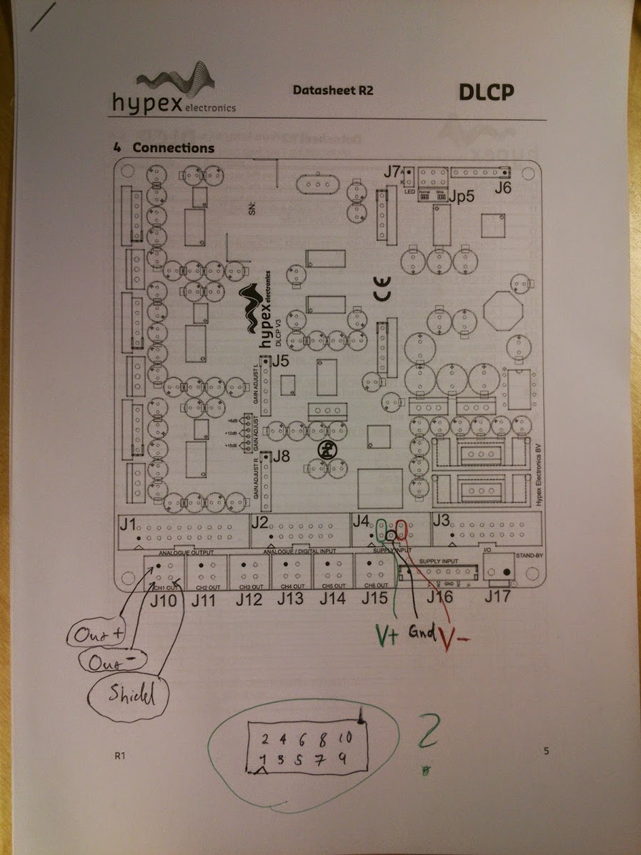

The progress continues and the next step for me is to connect the DLCP cables.
As the hypex dlcp psu is not out yet I'm using my own psu and as I'm not using the input board I'll be connecting the other stuff myself too. So I wonder about the pin arrangement. I assume that on the dual row connectors the first pin is the black one, and then pin 2 is on the second row. Pin 3 is then on the first row again 1 column right from pin 1. Or in short, like I've drawn with the green circle around it.
And thus the J4 psu connection should be connected with V+, gnd and V- as I've drawn too if I've got the pins correct.

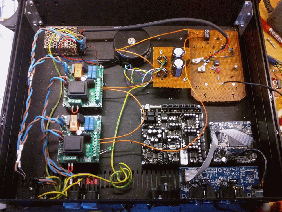

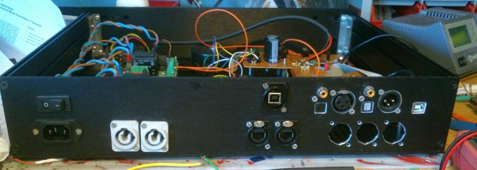

Here is a pic of the rig so far:
The board in the top right corner is my auto poweron/off circuit which I will use one of the two unused channels of the DLCP for such that when I don't play anything for ~ 20 minutes my main speakers power off. The relay on the board is connected to the switch on the hypex soft starts. The amps which is a PSC2.400d & a ~ 75W munching dual channel class A amp for each channel so letting them stay on when not listening is kind of a waste =)
The input is is from a MiniSHARC as I want FIR magic =)
The amount of cables most DSP setups have frighten me so the outputs from this one will be one PowerCON + etherCON for each channel. The EtherCON contains 2 analogue channels + AES/EBU with the option of throwing in another channel in the future if I get a separate DAC for the poweron/off circuit.
What do you see as "FIR magic" ?
(I'm not trying to pick holes, I genuinely want to understand)
Phase linearization of the low frequency roll off + all crossovers. I'll use IIR in the DLCP for all the frequency modification but the MiniSHARCs FIR for phase, like how Bruno does in the Grimm LS1. And the nice thing is that the FIR can be common on the whole channel, so it's enough to have 1 MiniSHARC with the 2x2 plugin which has ~ 6000 taps @ 48 khz. It is enough fix even the LR4 @ 25 hz low frequency roll off =)
