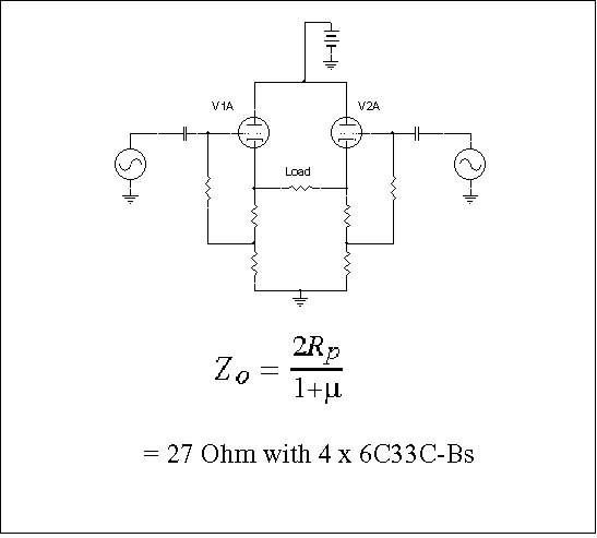

Then give us an idea how different the output power stage internal impedance of the circlotron is from for example the Fletcher/Cooke type of amplifier, and how much effect this might have on class A output power.
Facts please, not vague statements.
I don`t want to abuse this great topic started by respected DIY member Audiodesign going to much off topic ! , but If you read this article carefully you well found the answer : 6C33C-B OTL Amplifier - Background and OTL CircuitsThen give us an idea how different the output power stage internal impedance of the circlotron is from for example the Fletcher/Cooke type of amplifier, and how much effect this might have on class A output power.
Banat,
The push pull OTL amplifier by Fletcher/Cooke has 23,67 ohms output resistance; the load is 14,22 ohms. Pure class A output power a little over 6 watts with 8 6AS7G tubes.
Please note that this amp was designed to be a class A amp (driver stage).
This output resistance is almost the same as for the push pull OTL amplifier in the article you provided (6C33C....Background and OTL circuits) which makes sense as 8 6AS7G's are about the same as 4 6C33C's, 27 ohms.
The circlotron with 4 x 6C33C has output resistance of around 10 ohms.
I have a building instruction for the Atma-Sphere MA60II here (by John Harper).
He measures an output resistance of 10 ohms; sounds believable with 8 6AS7G's.
Harper measures low THD (mostly even order) up to 10 watts; above 10 watts distortion sharply rises with odd orders coming in; IMO switching from class A to class B at around 10 watts.
So we have PP OTL with 23,67 ohms Ri into 14,22 ohms load, giving 6,3 watts class A.
We have Circlotron OTL with 10 ohms Ri into 8 ohms.
Would it give 60 watts class A? I think not (with 550mA of idle current it will be some 5 watts pure class A).
