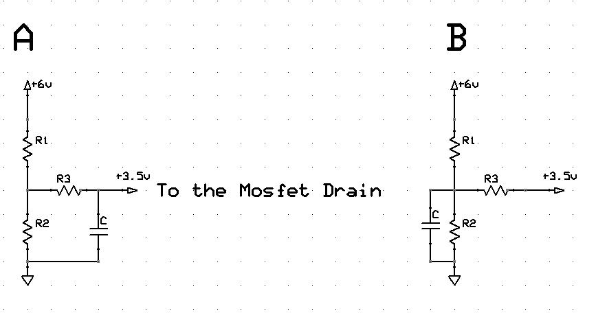

How many reactance is the optimal when I calculate the value of the shunt cap and on which frequency?
I mean this by a "standard" voltage divider, in my original question.
Optimal for what? I would shoot for something below 5Hz at least. A series resistor of 5k and a 10uf cap would give you an F3 of around 3Hz. If you want to use a smaller film cap, then use a higher value resistor. Or, if the bias supply is quiet enough, leave it out altogether.

I thought the target frequency is 50Hz or 100Hz against humm.

In this example the cap is after the series resistor or before (from the middle point of the voltage divider to the ground)?A series resistor of 5k and a 10uf cap would give you an F3 of around 3Hz. If you want to use a smaller film cap, then use a higher value resistor.
Thanks! It was the most important for me.If you want to use a smaller film cap, then use a higher value resistor. Or, if the bias supply is quiet enough, leave it out altogether.
'tis, but you want to be well below that to completely suppress it. A little overkill is not a bad thing here.
The series resistor is between the wiper and the cap.

I attached a little drawings for better undrestanding. Do you mean the A or the B version? Usually people use the B.The series resistor is between the wiper and the cap.
B
