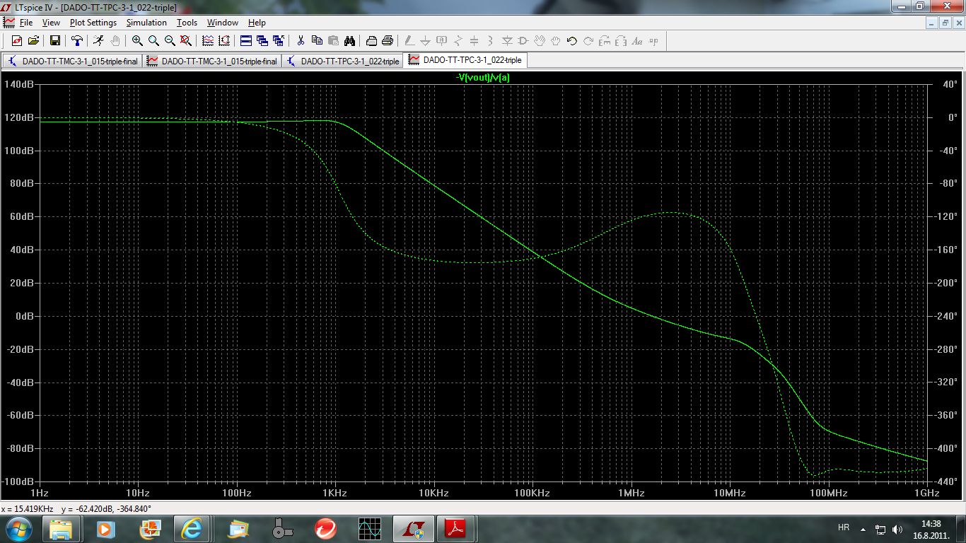

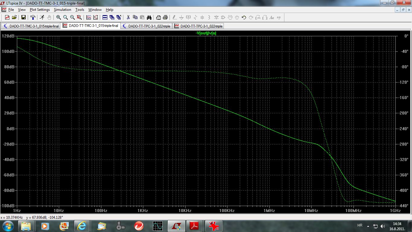

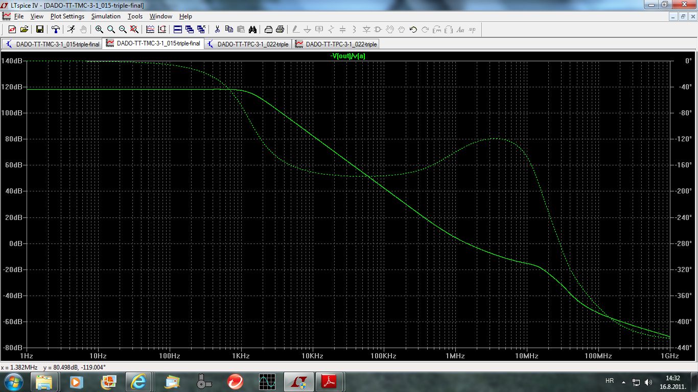

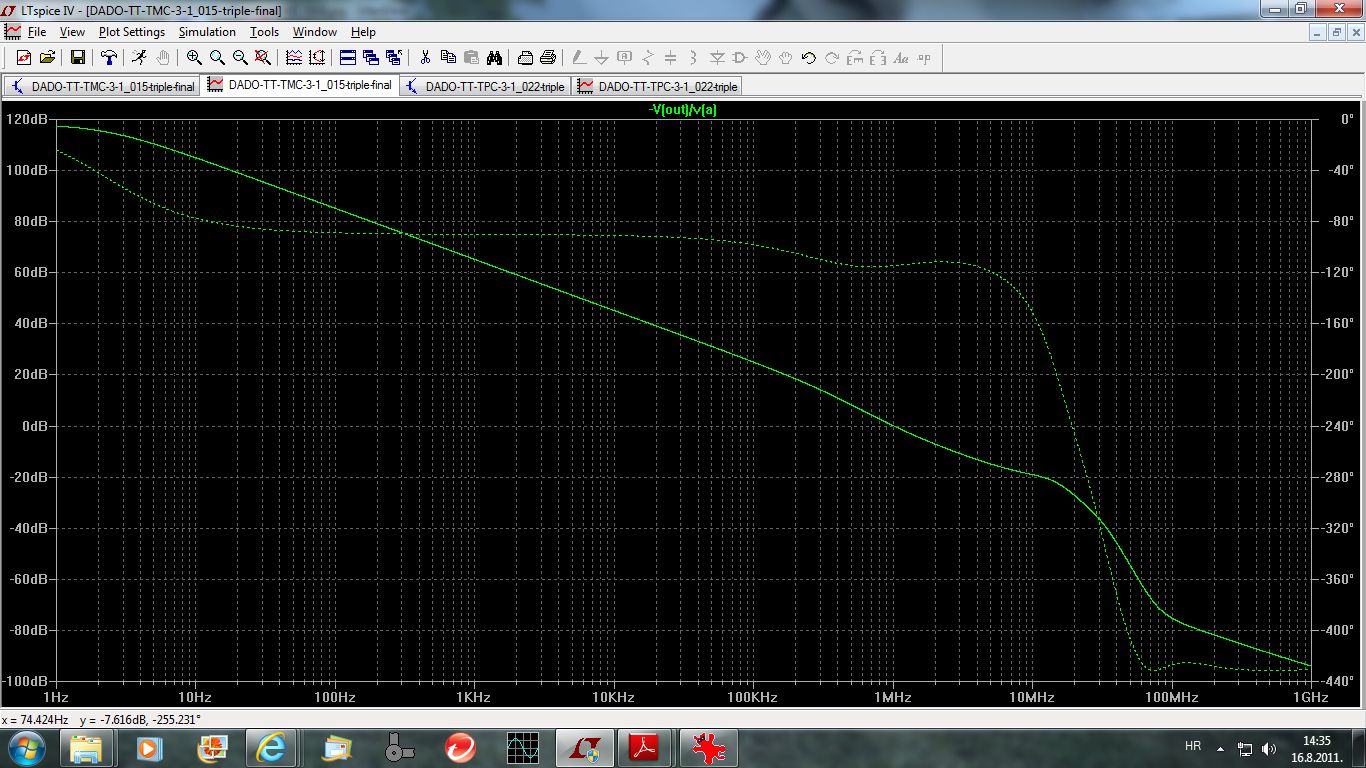

http://www.diyaudio.com/forums/loun...ch-preamplifier-part-ii-9215.html#post5066347
amp from Bob's book - 3 compensations:
green trace - nominal dominant pole
yellow trace - added 300k R, R||Cdom to flatten gain, get "wide open loop gain" (couldn't load the beta enhanced VAS out heavily enough with shunt R to gnd)
red trace - 2-pole
