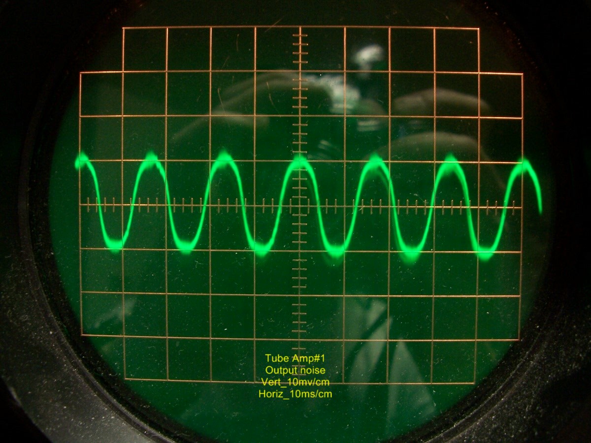

You don't have to. Just measure the voltage across the 8 ohm dummy load with the amp on and the input shorted (a wire going from the input hot pin to ground). That will tell us the noise voltage on the output. The rest can be calculated. Please don't make this more complicated than it needs to be.

But first, please, just answer the question. Just the noise voltage only, please.

ok, I can say that I have to put my ears to closer to 1 meter to hear any humi do not measure hum.....i listen for it on my speakers...
if i have to put an ear very close to the speakers to hear the hum and noise,
then i know my amp is reasonably quiet...
Okay, a starting point, good. Now, if the scope calibration is correct, then you have approximately 20mv pk-pk on the first amp and 32mv pk-pk on the second amp. Do the math and you have 0.0071 VRMS and 0.0114 VRMS output noise, this is quite high. Your S/N ratio (referenced to 1-watt) is only 52dB for the first amp and only 48dB for the second amp.
I think this would easily account for noticeable loss of inner detail in music recordings as the lower in level those parts are, the closer you get to the noise floor and intermodulation of the output noise with the actual signal. While you might not hear the hum at the listening position, you have pretty high limitations with the amps. Incidentally, what is the sensitivity of your loudspeakers and how far away is the listening position? Also, any idea on the noise floor in the listening room? Those noise figures would run me out of the house on my speakers (~95dB@1-watt) before playing any music.
