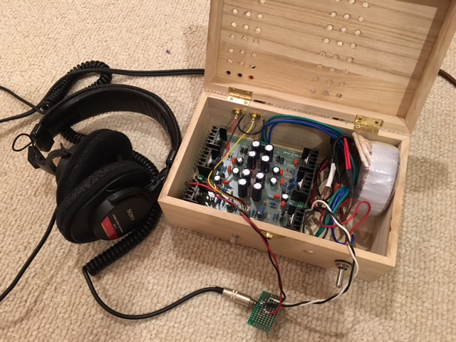

I listened to my new JLH class A headamp last night on old Sony MDRV6's and the sound quality was a revelation. Never heard such deep deep bass before and never heard such detail and low noise clarity in these phones before.
Here is the amp almost finished awaiting a 1/4in jack.
