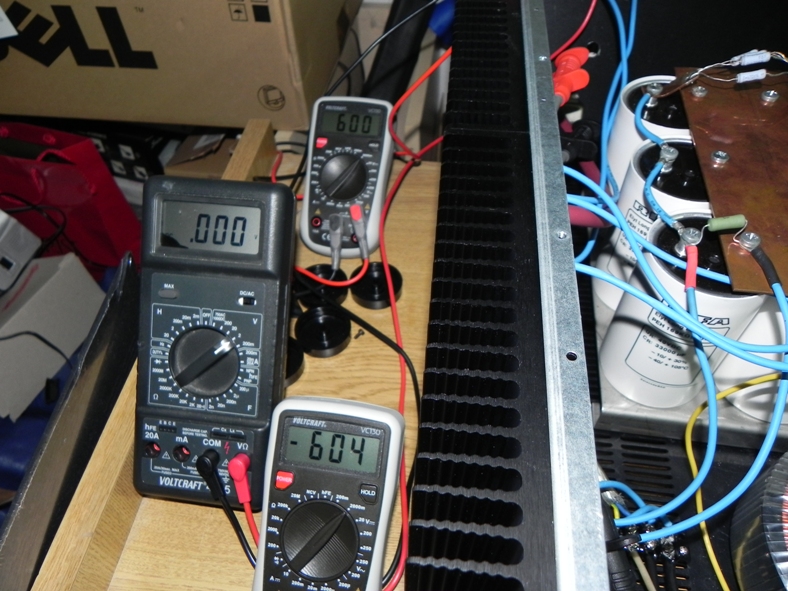

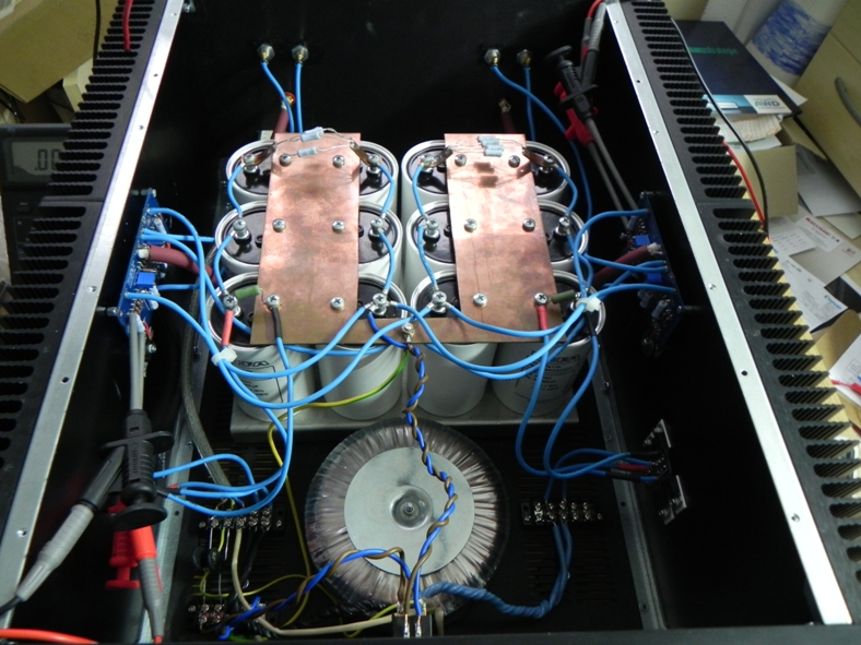

Finaly...
Puhhh.... I got both channels working now very well!!!
It turns out that I interchanged somehow Q5 and Q6 on my left side pcb. But luckily nothing was damaged and the amp working properly as you can see.
I also needed to add a 2.2k resistor to R3 and R4 in order to bias to 0.6V and offset it to almost Zero.
More pictures to come....
Mallard
Mallard

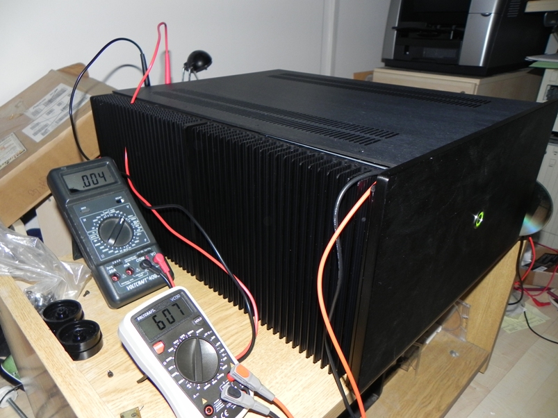

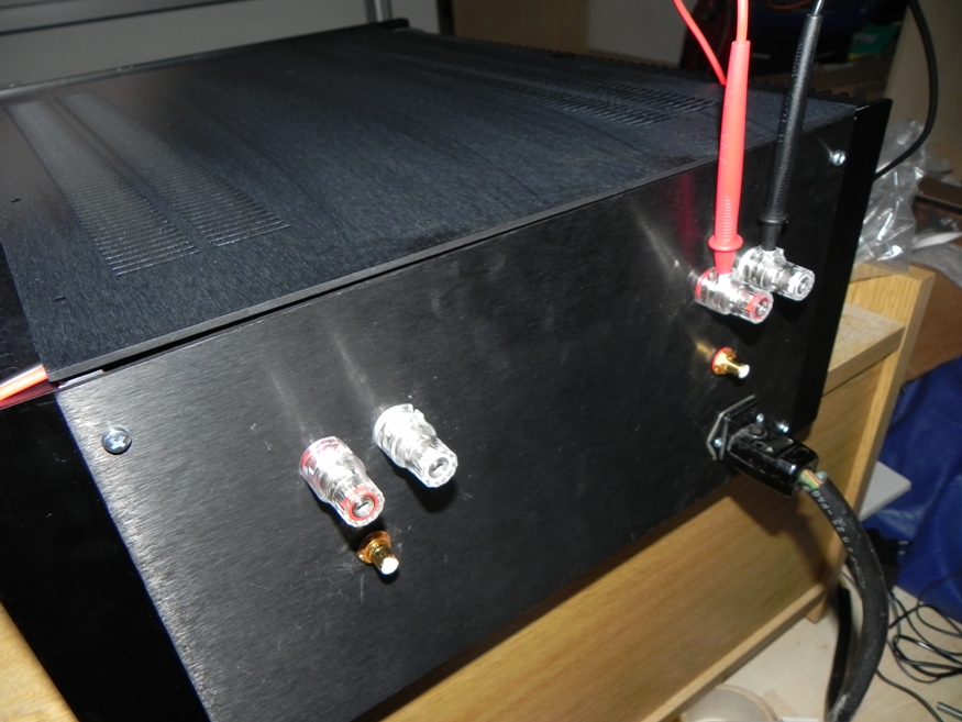

Almost done!!!
Here is my NP F5 clone
I'm currently in the process of biasing it with closed lid. It's a bit difficult because every time I open it the bias changes by itself...
Sure there is quite a bit work to do in terms of fine tuning, but step by step!
I can't wait to connect with my pre-amp and my speakers. I hope that is all the stress and the money was worth it!!!
