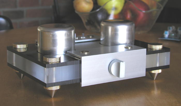

Peter Daniel said:
And here's my humble effort with the preamp. The current version is all aluminum, but I have a feeling it does not sound exactly the same as acrylic.
Hello Peter,
you lucky one got cans without dents ... mine are not so smooth that I could show them in the living room ...
and of cource PMMA does sound better that alloy ... wood would also be good.
Cheers
Christian.
KT said:
What was your inspriration when you designed it?
I guess one might say Shanling. ;)
I also made a black&white version, which had slightly different appeal.
Sorry, but I do not have any photos of the rear side.
The rear side has 1 input and 1 output for each transformer, ie there is 4 medium quality golden chassie females on the rear.
Hard wired ground connection for all 4 transformers.
The case is from ELFA. ELFA
I can swtich inputs and outputs rather easily, and even though S&B share the same nice and sweet sound, the sound from the S&B transformers are just so much better. More details, more dynamics, more intensity, more speed, firmer bass, snare drums much better on S&B.
This has been verified on two totally different system in two different homes.
Of couse there is a price difference and the S&B should be better.
Sigurd
Sigurd Ruschkow said:
... the sound from the S&B transformers are just so much better. More details, more dynamics, more intensity, more speed, firmer bass, snare drums much better on S&B.
I am glad to hear that ... having spent the big money.
I am still impressed with the sound of these TVCs.
Cheers
Christian.

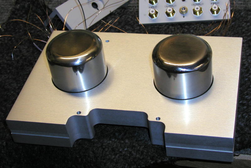

Peter,
Wow!
My trannies are not as polished as those are. Did you do any finishing to the cans? Also, since I know the cans are an EMI nickel shield, and that nickel EMI shield works better when annealed (so assume the cans are annealed); did you do anything to ensure you didn't... erm... de-temper the cans?

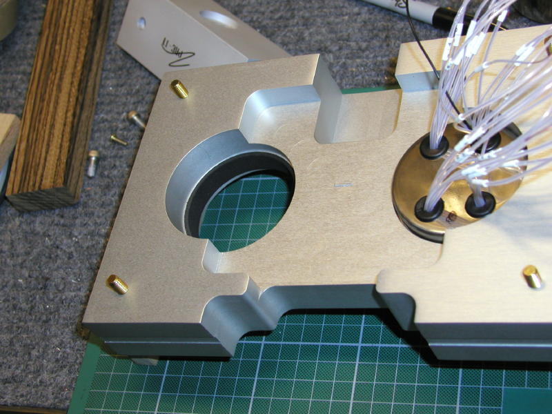

Peter Daniel said:
I made special mounts (out of hole saw and some rubber), mounted the transformers in a drill press and did some polishing with Scotch Brite pads, just lightly on a surface to get nice, uniform finish.
I've wondered about that blue rubber that you use. What exactly is it? And, if you don't mind me asking, do you use it because you feel it changes the equipment for the better, or is it just something that you like working with (or just have lots on hand)?
Thanks for the idea about Scotch Brite pads:), will try while I'm waiting for my next shipment of parts (I can't believe how many times I think I have everything, and find out that I don't).
I don't know exactly what it is, some call it blown rubber. Its rubber like substance but feels like foam. They use it for shoe liners and for slipping pads (at least it seems to be similar). It is not neoprene, as it's harder to thouch.
I use it to provide semi rigid mount of the transformers inside platform's opening. I just can't think of anything better for that purpose.
The outer cap on transformer stops against the notch in chassis opening, providing for a perfect height alignment. There is a small gap around transformers when looking from top, so the rubber is not visible anymore, nor any special trimming required.
The cans are special ordered, with polishing treatment.
