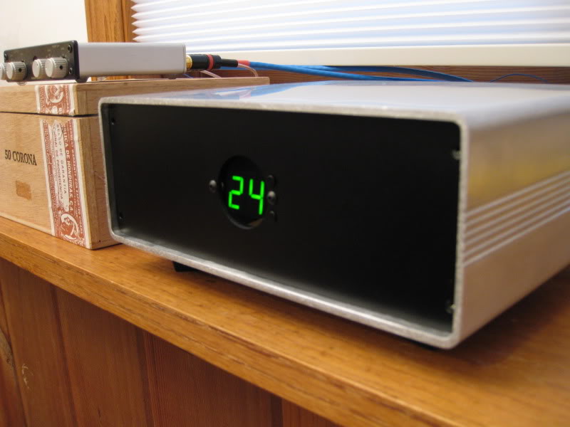

Hi John! Thanks for the information - I wish I had taken better notes when I looked them over yesterday... I'll take another look later.
By the way, this current project is up against some stiff competition here! :)
