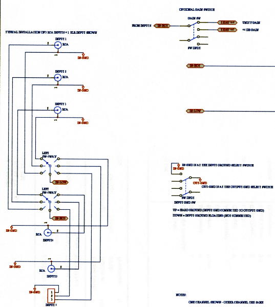

Your wiring is really close to being right on. The only bits missing are a signal to pin3 of the xlr. This should be connected to the 'bottom' of the secondary. These will be the Black/White wires from each transformer. Just run each one to it's respective pin3 and you should be good to go.
The only other thing you may want to check when you are at it is that if you have wired a mute position at the bottom of the switch it should be wired to pin3 of the XLR output - not to ground. That way when at mute position you short pin to pin3 - no difference between levels gives a mute. If you wire this spot to ground when you hit the mute position then pin3 waves in the breeze and it won't mute.....

Thanks John I appreciate the reply. I actually had the output lugs on the switch round the wrong way left>right and vice versa.
I did have the signal to the xlr but messed up my post.
The good thing is that I have now added the mute wire to the xlr rather than ground
thanks again.

Hi Everyone,
I've just recased my 102s in an original Django chassis kindly supplied to me by Brian a couple of years ago.
I've fashioned beechwood trafo supports and the 23 position Seiden switch is wired up. I have all the other parts to finish, but I'm a little foxed by the 4 pole, six way Seiden selector. Seems to me that I have 3 inputs on my chassis and 12 possible stereo channels on the switch. I was wondering whether I'm missing the obvious, or is most of my switch going to be unused?? I suppose I could wire it such that the positions 4, 5, 6 are phase inverted from 1, 2, 3, but to what effect?
What did you guys do with your Seiden selectors, please? I'd like to get this project wrapped up (after 5 years!!

With your 4-pole switch you break BOTH hot and neutral wires of each channel. This allows you to conductively isolate all inputs from one another.
Hopefully, the switch is make before break, at least on two of the poles, so that any signal grounds are not broken before the hot side, to prevent popping.
Therefore, you'll have 6 positions for input, of which 3 will be used. You can inverse wire the other positions for inverted phase.

After long delays I am finally rehousing my TX102's and wondered if someone could answer a question for me. In all wiring schematics I've seen the inputs have both signal and ground connections switched is this absolutely necessary or could I just switch the signal connections? TIA
