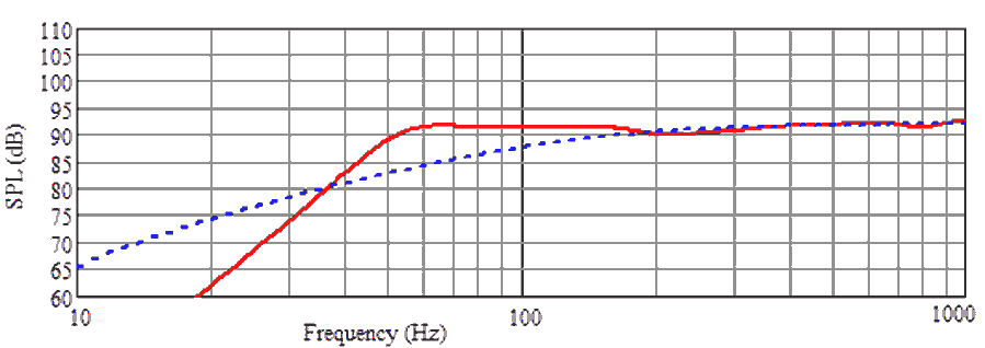

I'm currently building a pair of small BRs for a pair of 10Ps and someone I know wants me to build a couple of fullrangers for them. I'm wondering which enclosure gets the best low end response out of a pair of 12Ps.
I've been looking at the Pensil series (they seem about the right size) but can't seem to find any technical specifications for either the standard or super Pensil 12.2P. Does anyone know how low F3 is for these enclosures?

Pensil12.2 sims near 35 Hz F10 anechoic (F3 is a meaningless number as far as what we hear, a term that is an artifact of the filter theory used). In room they will very likely go lower (but room modes will mean lumpier response)

Could you explain how F3 is meaningless?
Meaningless wrt what we hear… Toole showed that with scientific experiment.
And analytically it does nottell us anything… take a reflex box and a sealed bix with same F3, the sealed box goes considerably lower as it is rolling off much slower. The shape of the roll-off is important.
Much more useful to use F6 and F10.
3dB (F3) is "just noticeable". F10 is half the volume.
