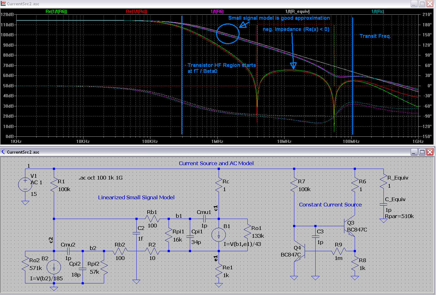

re = alpha * rm; alpha = beta/(1+beta)
yes - i forgot R2, R2 is important, input impedance with R2 is (R2 + re)(1+beta) or about 150kOhm @ 1mA, beta=150
The feedback capactiance between C and B is very important as it lowers the impedance. think of an inverting amplifier: C_CB is the impedance from output to negative input...
The picture shows the equivalent small signal model:
For some reason I have never encountered rm, is there another symbol for it? It could be that I've just forgotten! Thank you for explaining, so dIc = dVin / rm ( where dVin is the change in voltage at the base & rm = 26/Ic, I think some books have stated that re = 26/Ic, which is a close approximation if beta is high as alpha ~ 1
yes as it is multiplied by the voltage gain of the circuit, the miller effect?
It is only 1p for the bc847, that's quite good I would think?
The difference in Ro in the two transistors, is this due to different collector currents?

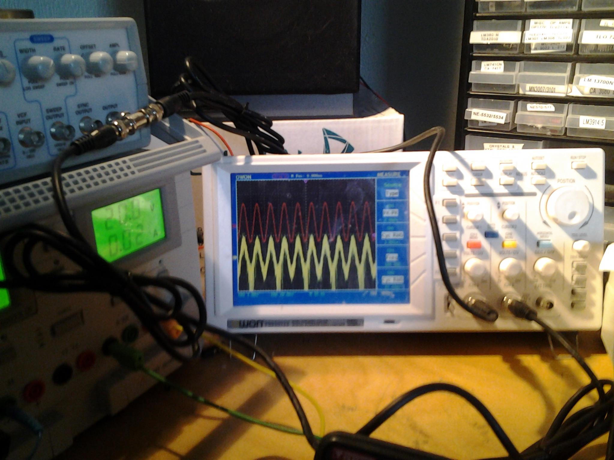

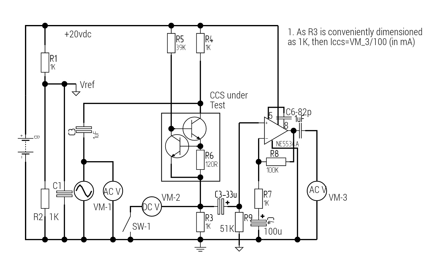

Latest setup, see attached.
Results:
VM_1 = 1.007 V RMS, Vcc = 20.0 vdc, Vccs(DC) = 9.4 vdc, Iccs(DC) = 5.3mA.
Signal Frequency: VM_3 Zccs(ac)
100. 15.5mV. 6.50M
330. 14.38mV. 7.00M
1000. 14.03mV. 7.17M
3300. 18.40mV. 5.47M
10000. 41.74mV. 2.41M
20000. 79.60mV. 1.26M
I don't understand why the impedance at 100 Hz is lower than @ 330 Hz. Notably the voltage on VM_3 was unsteady during the 100 Hz test, so the figure of 15.5mV was an estimate of the average reading on the meter.
Initially there was a lot of HF noise on the output of the ne5534 (see photo) this was tamed with an 82p compensation cap between pins 5 & 8
I suspect that the HF noise is coming from the power rails via the Vref network, therefore this may need to be cleaned up as my bench PS outputs quite a bit of HF noise ( I find this odd as its linear, not smpsu )
The 5534 should be rock solid stable at higher freq (gain=100), but low freq. can make trouble, it need a decoupling C (100nF).
Try a 100 R at the output and a small cap across the 100k too.
51 k is a bit on the high side for 5534a.
if you have trouble with the PS, try a LDO ( LM317 or similar), with short cables.
Place SW-1 on the other side, so that no long cable is picking up RF.

I forgot to put the decoupling caps in the schematic, but I did use them, 3 in fact; 1 across V+ & V- and 1 each between V+, V- and vref, all 100n disc ceramic. I will try your other suggestions though.
Also the capacitor C1 on the vref potential divider is a 2200uF electrolytic.

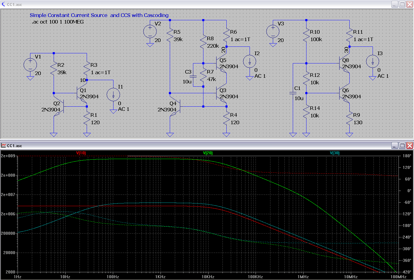

In the transistor BC846 plot of Ic over V_CE (for constant Ib) the curves are not horizontal.
An ideal current source would have a horizontal line, as Ic does not change with V_CE.
The early effect is modelled by Ro1 in the small signal model i posted earlier.
You can greatly reduce the Early Effect by cascoding the current source transistor (or by using hig-voltage transistors).
In a cascode the CCS transistors sees a constant V_CE. This improves the high frequency performance too.

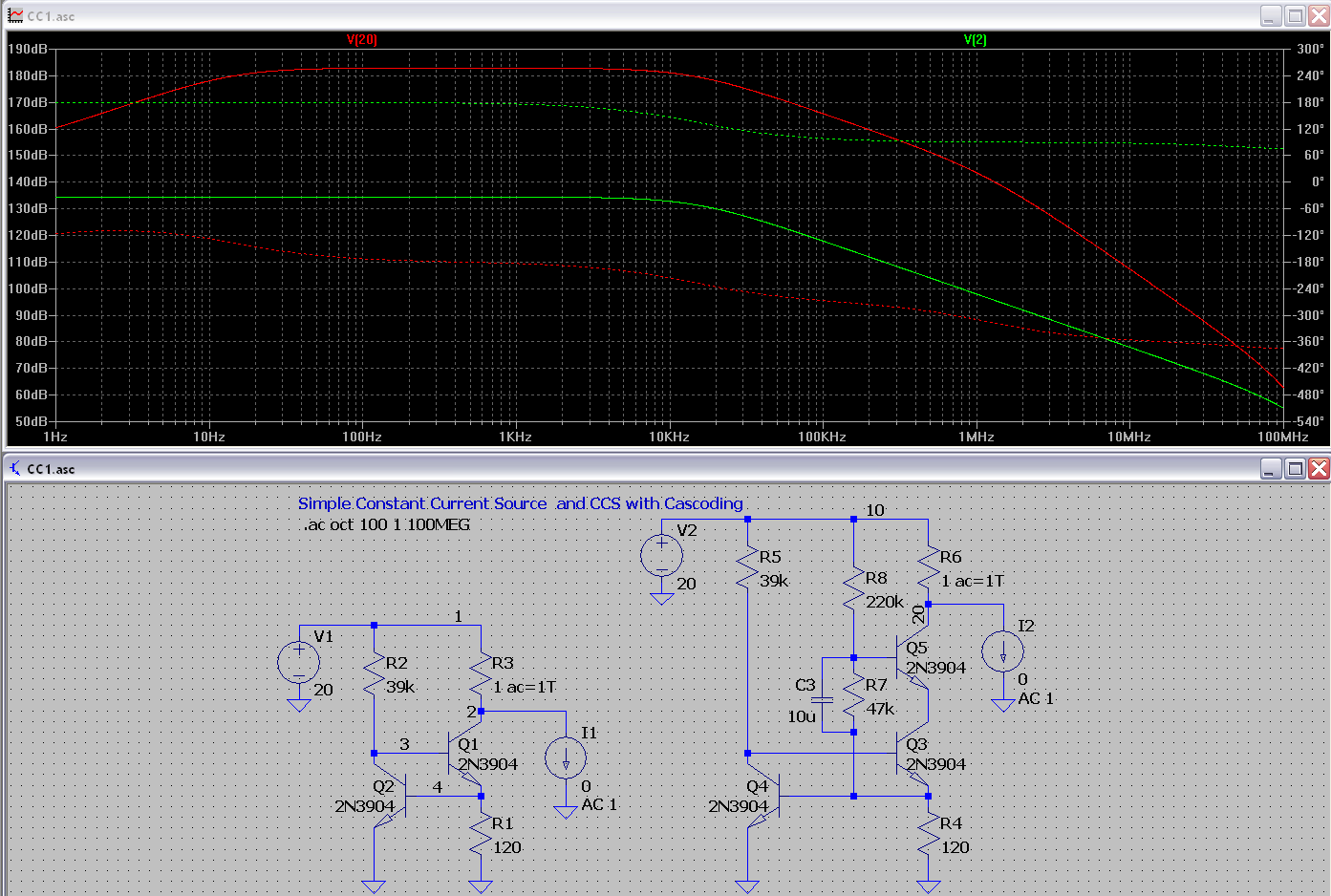

Here you see the effect of a cascode on the output impedance:
The output impedance goes up from 5 MegaOhm to 1.4 GigaOhm
(a factor of 270)!
- At least in simulation - i would really like too see if you can measure this in reality too
(I use a LTSpice trick with R6: ac=1T means that the AC impedance of R6 is 1e12 Ohm for small signal analysis only....)
(a factor of 270)!

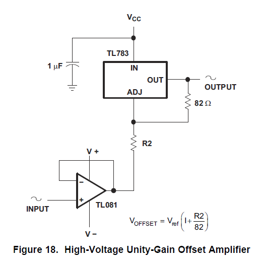

jackinnj wrote: Here's another idea from the TI datasheet-- will work to 125V -- using the TL783:
At first the relevance of this went right over my head. But yes this could be another solution to the problem, I don't see why it wouldn't work with the lm317, etc, of which I have several to hand. Thanks.
Gordon.
(a factor of 270)!
That is an incredible result with the cascode circuit. I seriously doubt that my instruments are up to such a delicate measurement, as it would involve the measurement of incredibly tiny voltages / currents, in fact could any equipment measure this assuming that it could actually be built to operate as in the simulation?
Here i have simulated a further simple CCS:
Zout = 5.2MegaOhm / 1.4 GigaOhm / 7.6 MegaOhm
Actually I'd have expected better of the third circuit, the simpler cascode one, though perhaps it is relatively superior to the simple 1 bjt current source

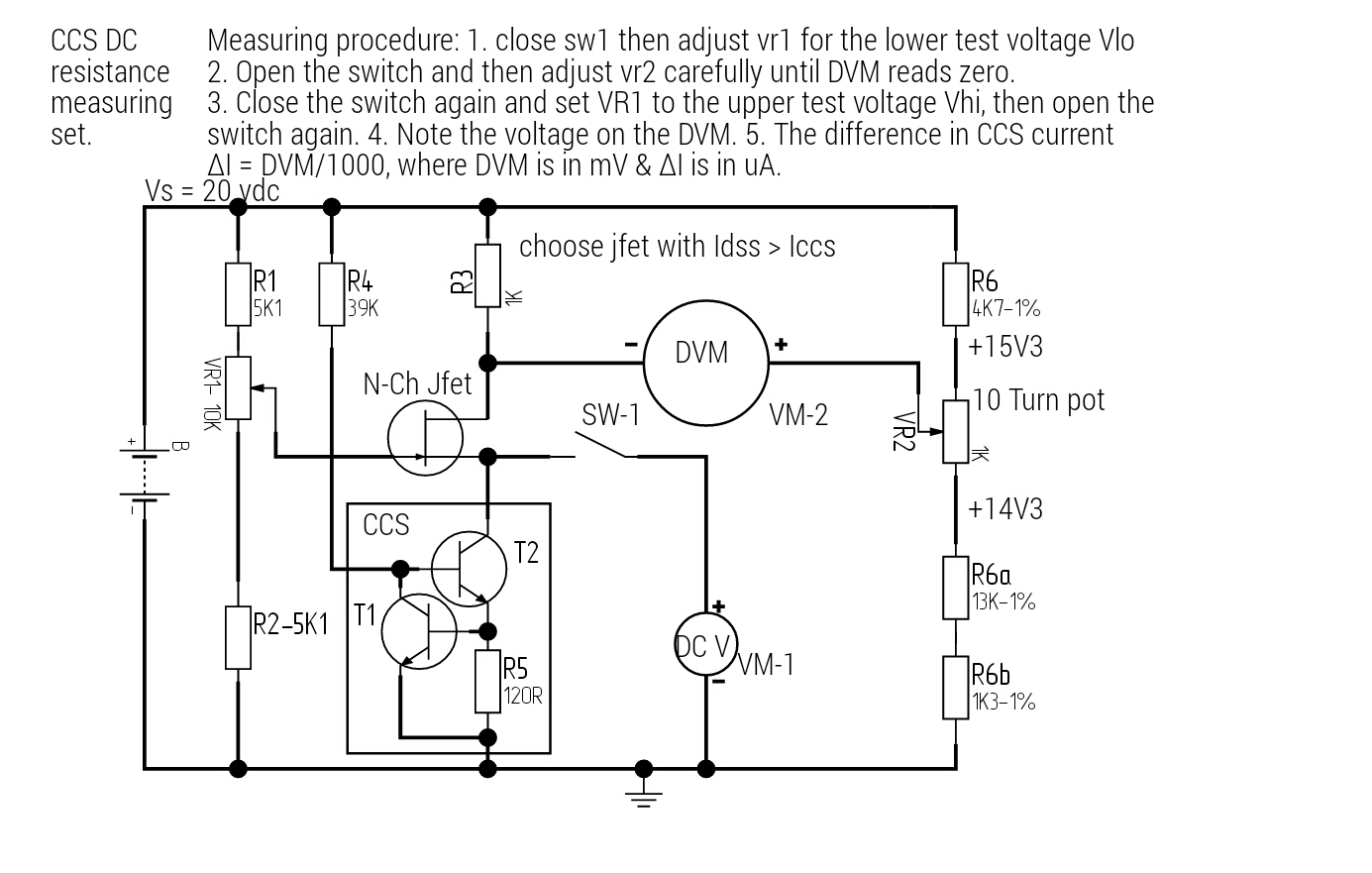

I was hoping to see your DC measurment. It would confirm if my DC measurements and estimate of 200k to 300k is completely wrong or in the ballpark.
I am surprised that your early AC figures are so much better than what W.Jung has published.
Andrew, I have come up with a scheme to measure the DC resistance, see attachment. I made a somewhat crude measurement using an ammeter and voltmeter and got a figure of around 2.2M, but my equipment was at their very limits, so the error margin is enormous. That result was for the same 2 transistor 5mA CCS as in the ac measurements.
Still not out yet as the Good Lady is getting laundry sorted out for the kids as they're returning to school tomorrow.
Anyway, AndrewT can you describe or better still, provide a schematic to show the method that you used to measure DC resistance and which type of CCS? If possible can you confirm what instruments that you used including relevant specifications, such as resolution and % error for DMM's, if it's not too much of a bother.
I'm keen to make comparisons between different methodologies, this thread could have the potential to turn into a publishable paper, though I'd need to fake my credentials, as I'm an EE degree dropout sadly
Looking forward to your reply Andrew,
