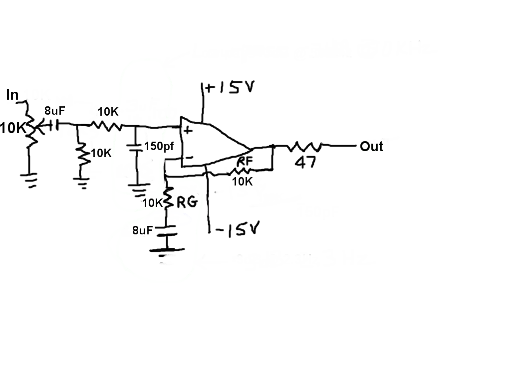

You're correct in that my primary concern was DC offset at the outputs since I have encountered this before with higher Ib op amps.
Mooly stated that offset would be lower with the feedback and input shunt resistors being the same value and shared the idea of the cap to ground on the feedback network...something else I didn't know about.
So yes, I realize that it's important, too.
Then another member stated, like you just stated above, that it's good practice to have both a low and high pass filter on the input.
Up until this point, I've never used any kind of trap on the input of an op amp circuit.
So now I'm at the point of making sure my schematic below is correct for both a low pass and high pass filter on the input.
I calculated the -3dB point of the high pass at 2Hz and the -3dB point of the low pass at 106KHz.
Does this look OK to you, or do you see things I need to change?
Do both filters go after the volume pot like I have it drawn?
Thanks...

Looks as though the feedback resistors are too large as well as shown in the AD827's datasheet below. They don't recommend anything over 5K.

No - since 'sound' is perfectly subjective I'd not make a blanket statement about other people's 'sounds'. In my experience though the caps on the supply are a bigger issue for sound than coupling caps. For example I use (contrary to the consensus here) 10uF X7R 1206 ceramics to couple my DAC to my amp and don't hear any issues, but decoupling caps are a different story all together. I realize this makes me a heretic but hey that's life
You have to remember the AD827 is designed as a wide bandwidth device and that is one reason the feedback resistors are recommended to be less than 5k. Using higher than 5k will limit ultimate bandwidth and slew rates (due to stray capacitance effects for one reason) but you also have to remember that audio applications don't come close to needing what a device like this can offer.
I would suggest that whatever you decide, that it should be backed up by real measurements to confirm stability and lack of ringing and so on.
As to the filters... why don't you try more extreme values, say 20Hz and 40kHz in a test circuit and then compare with say 2Hz and 400kHz and see whether there was any audible effect or loss to you.
In your latest circuit the + opamp input should just see 10k to ground so that it matches Rf.
The circuit in post 57 has 20k on one input and 10k on the other, so input current will generate a voltage offset. Of course, using lower value resistors will reduce this problem, but you have to be careful not to load the source too much. Is this an appropriate opamp for this application?
