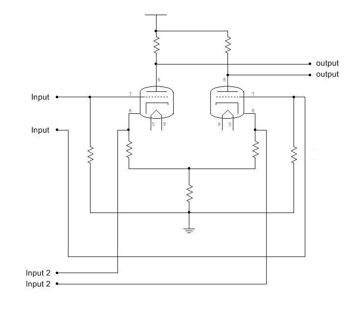

How can I add a balanced input to a tube amplifier?
A possible way to put a balanced input on the Bill 2.

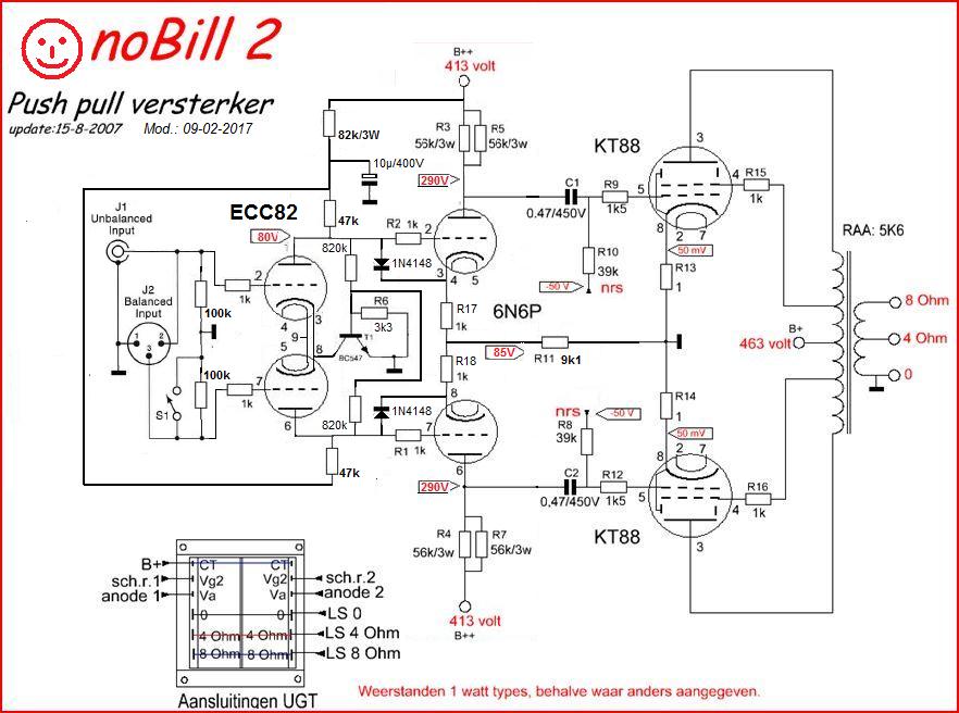

Yes, your schematics, and the one shown in #35, btw, are perfectly symmetric amplifiers. But what to do if you want to add global NFB in order to achieve lower THD, wider frequency response, higher damping factor etc.?
Myself didn't find any solution for that so far in my also perfectly symmetric Circlotron monoblocks that I've built more than ten years ago. So I went to use transformers, being still in search of an electronic (hopefully with tubes...) solution.
Best regards!
The problem with feedback is a symmetrical source.The Bill2 has an OPT with 0-4-8Ω, no 16Ω. With a 16Ω out you can have two outputs same voltage opposite phase by taking the 4Ω tap as a common, 0 is one phase and 16 the other.Those two can be feed back to the cathodes of the first stage.
Another solution is a floating winding on the OPT to put between the cathodes first stage.

Like this?

The circuit above is what? A LTP made up of two differential amplifiers?
I found the issue I was having with my simulations. When I calculated the turns ratio, I came up with 33:1. That is plate to plate turns but I entered 33 for each winding in the simulator and plate to plate ended up 66 turns. So my opt primary impedance was much too high. This explained why I'm clipping my input stage before I reach required output power.

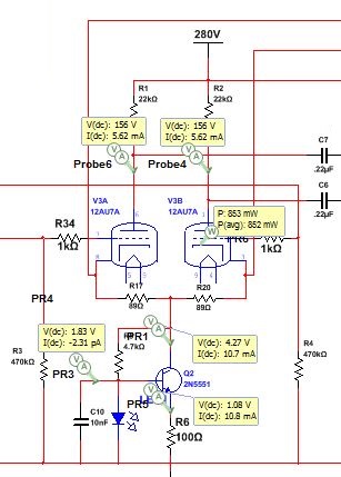

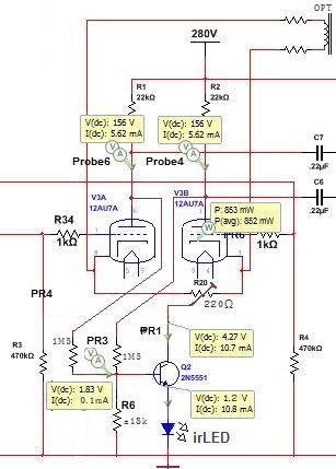

How about like this ?
If the output winding isn't floating the transistor compensate the current in the feedback resistors (within reason).
A irLED for not loosing to much voltage.R6 is uncertain, depends on LED voltage and current gain of the transistor (no high voltage type is needed).

My output winding is floating. I will keep that in mind though if I decide to wrap feedback around the output stage as well.

I think you may want to swap R6 and the LED to get your CCS working?
The feedback resistors decrease the tail impedance quite a bit. Does that matter?
Best regards!
If you swap R6 and LED you get a fixed current source.Any resistance to ground from the feedback cause more current in the tubes, the anode voltage drops.Here the voltage drop on R6 depends on the anode voltages and keep them on the same level, even if the tubes change (other tube, getting old).Now you can experiment with the feedback and keep constant state of the tubes.
Mona

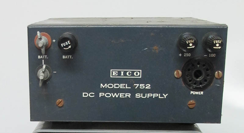

This is a little older than your '73 Beetle. You'll often find these DC-DC converters for Hallicrafters, Heath and Eico ham radio gear:

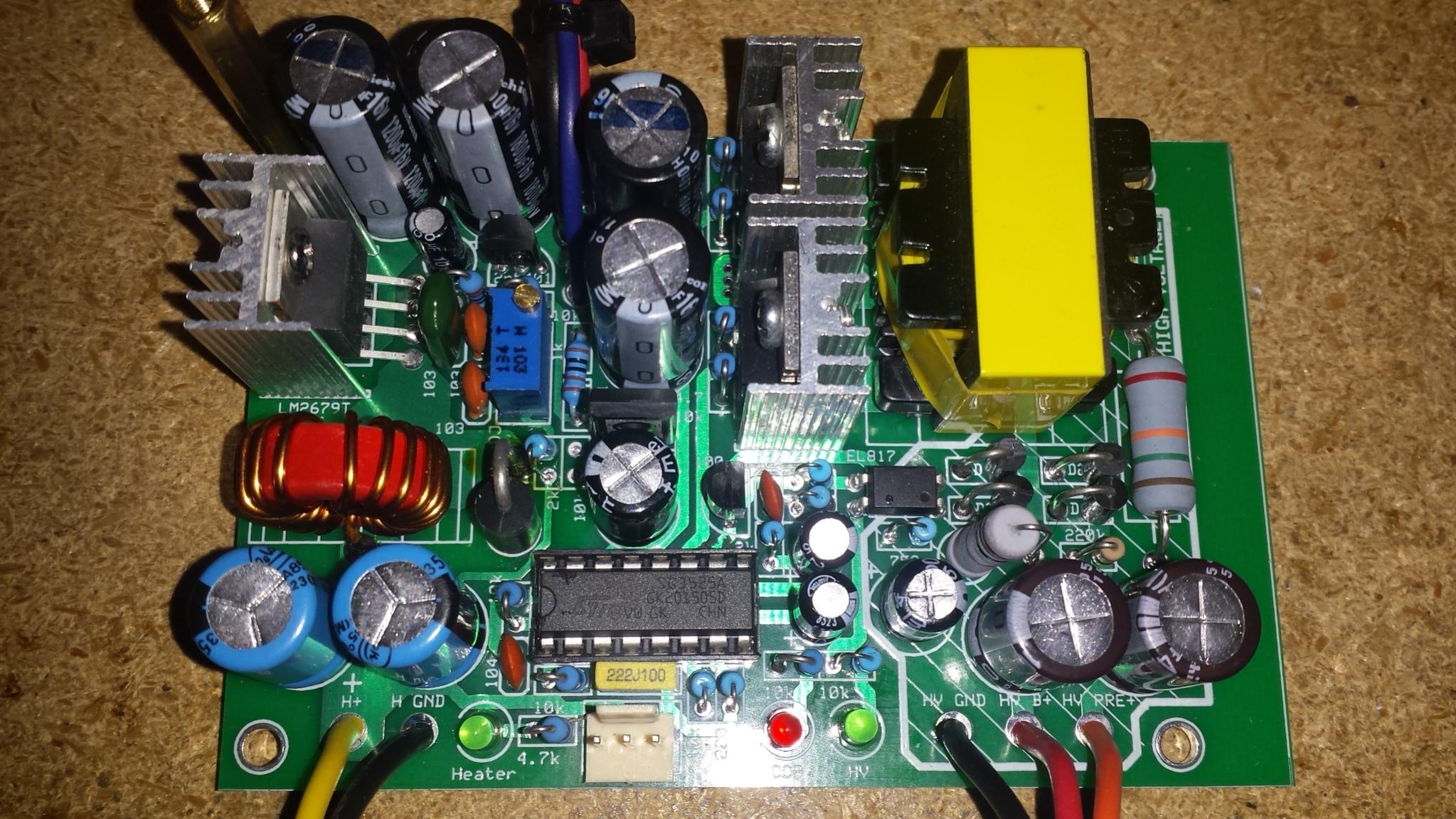

Thanks everyone for the input. I'm a bit confused about the change to the CCS though. Attached is a common circuit for creating a CCS with an LED and transistor. In my case, the cathode is high enough (about 5v) above 0v that I can supply the LED voltage from the cathode. There will be some ripple if the stage becomes unbalanced. A small capacitor at the base might help that. I'm not sure that it's needed.
As for the tube amp being mobile, I've already designed and built the smps power supply. It's silent. I'll find a photo in a moment. It has a soft-start 6.3v regulated heater supply (buck) and a 300v (under load) unregulated plate supply (push pull) with an RC to drop to a 250v for the preamp. I use it in a stereo push-pull 6BQ5 amp.
