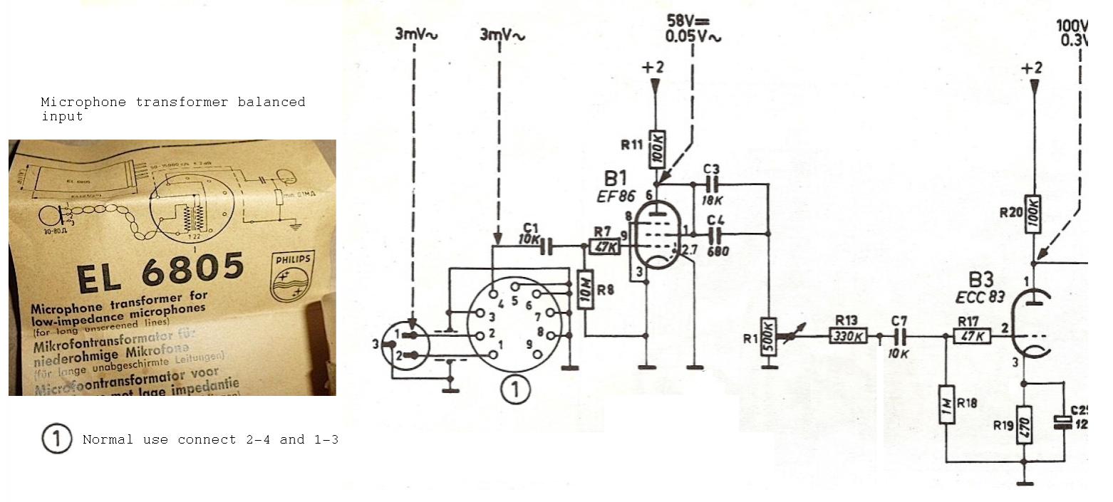

Maybe you mean this ??
Ok now I'm stumped...

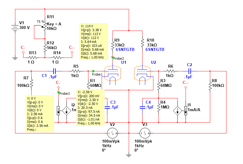

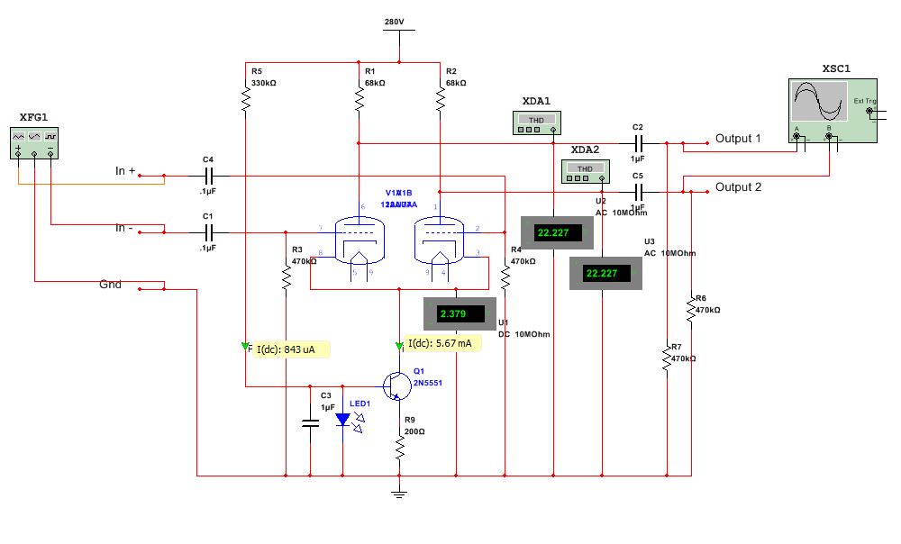

How would I go about making a LTP stage, that will take a balanced input, and then apply NFB without upsetting the impedance between the inputs?
I searched for examples but couldn't find anything.

What's the type of the tube you're about to use? Sorry, but I can't read it in your schematics.

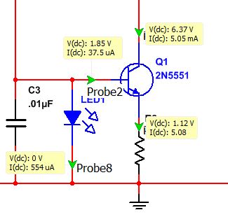

You may need to relate the CCS to some negative supply, as in this depicted configuration the 2n5551 may operate near saturation.
Best regards!

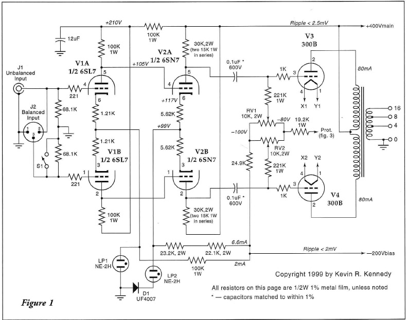

Does anyone have an example of a tube amplifier with a differential (balanced) input? This doesn't seem like it would be as hard as it is. I can make an input stage like the one above and it has fairly low distortion. Incorporating it into an amplifier is proving difficult.
The Gigant has transistorized input and mixer stages, it's inputs are not truely balanced, the signal being fed to the base and the emitter of the first transistors.
If a SS balanced input were acceptable, I'd recommend an instumentation amplifier.
