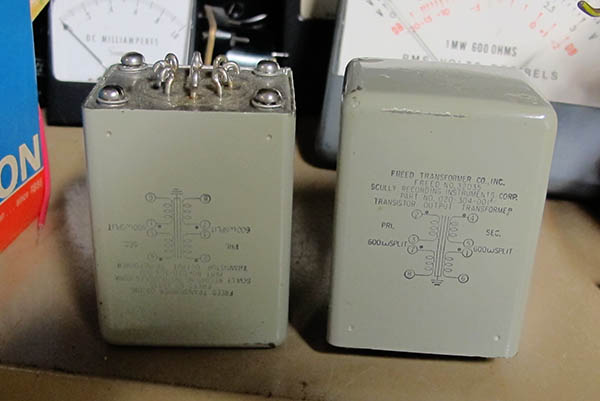

Transformer easiest -- Jensen LT-11P-1 are about $70 each. Or you can go fishing on EBay -- I picked up these Freed "trasnsitor output transformers, 600:600 for less than $20 and they are flat from about 25Hz to 100kHz with a source impedance of 20R and secondary load of 100k.
With a transformer you'll have to match the output impedance with an RC network across the secondary --

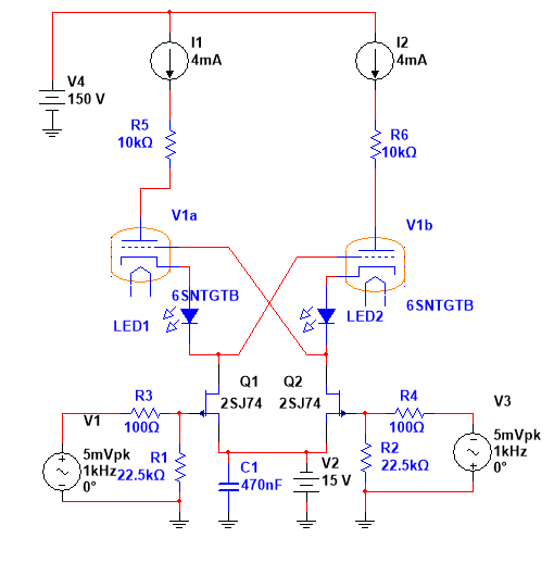

That's an interesting circuit. Good balancing I assume?
Cross-coupled, CCS loaded, LED biased, that's the Cadillac of hybrid input stages. balance is perfect, performance should be excellent. I have simulated something similar from one of Sy's posts a while back and it gave insanely low THD numbers...
