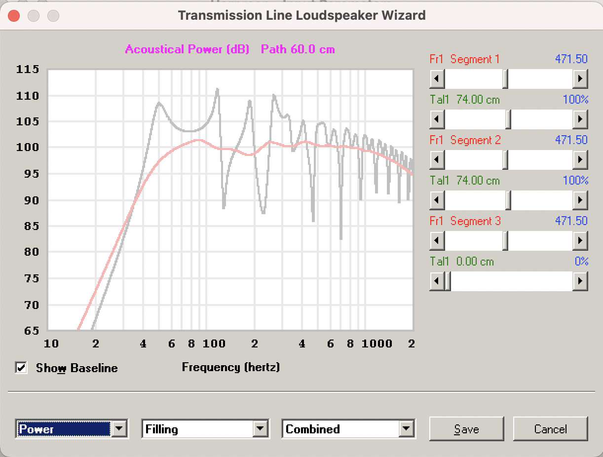

Hi Everyone,
CHANGE
Results can no longer be calculated with the Ctrl key depressed (Booger weldz to particularly note).
BUG FIX 1

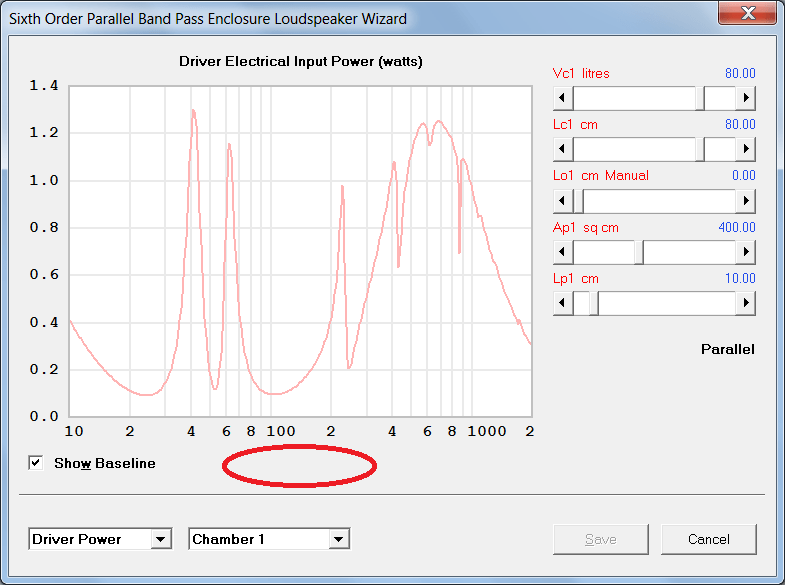

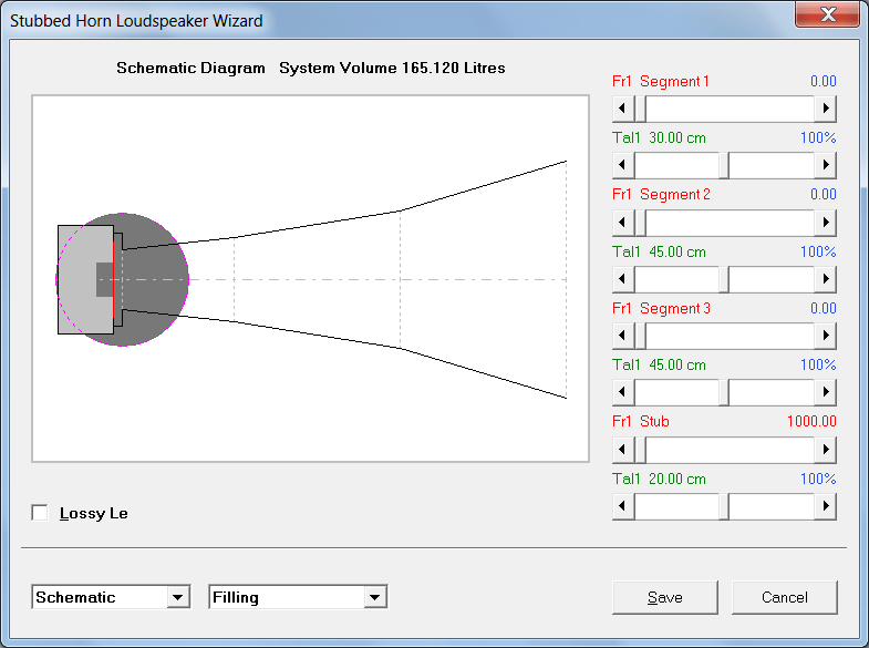

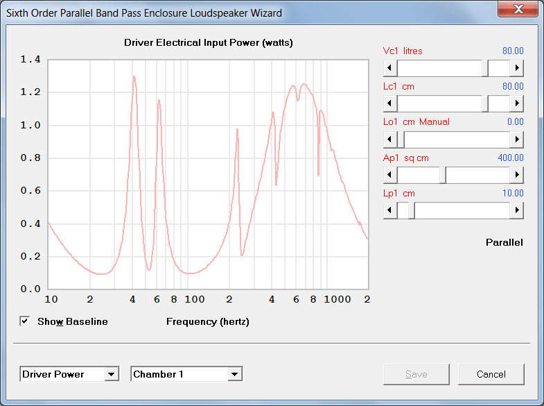

The "Frequency (hertz)" x-axis label was missing from the Driver Electrical Input Power chart in the Band Pass Enclosure Loudspeaker Wizard, as shown in Attachment 1. This has now been fixed, as shown in Attachment 2.

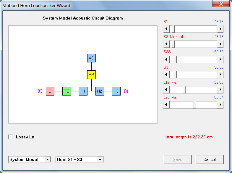

BUG FIX 2

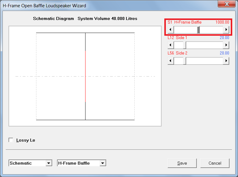

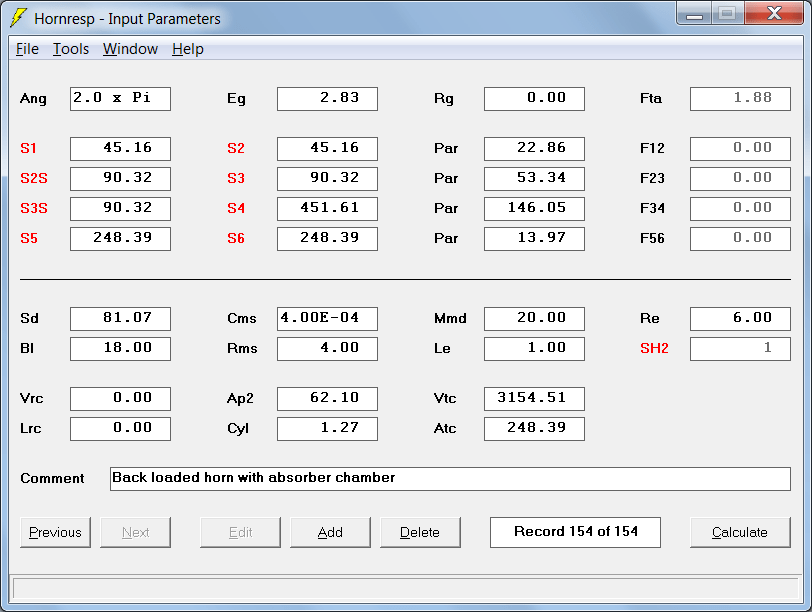

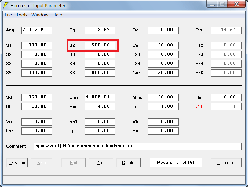

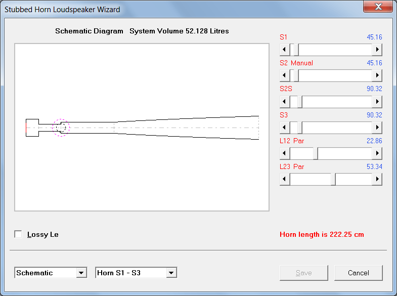

When the Loudspeaker Wizard area slider control for an H-frame or a U-frame system was adjusted and the results saved back to the main input parameters window, the S2 value was not being updated as shown in Attachments 3 and 4. This has now been fixed.
BUG FIX 3

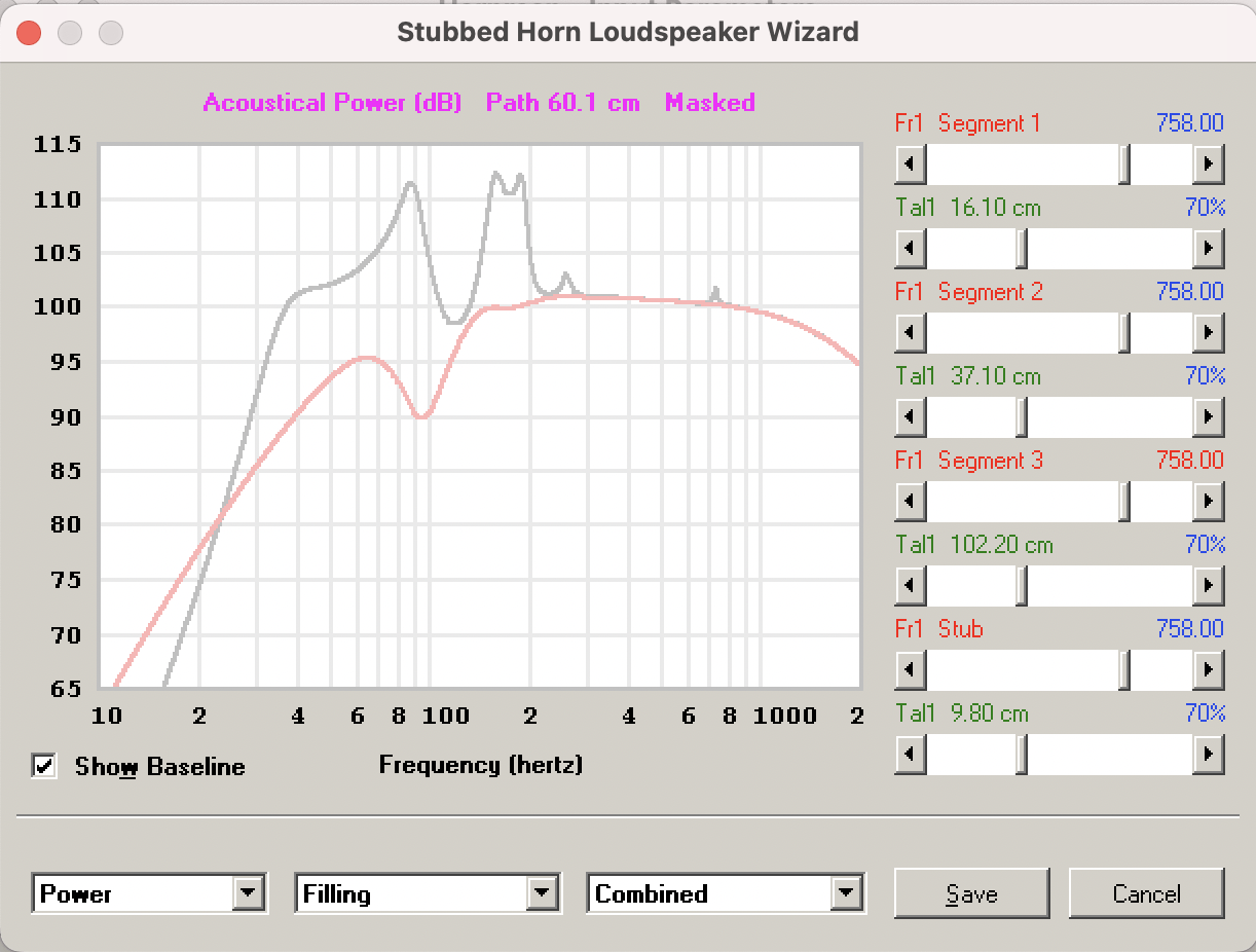

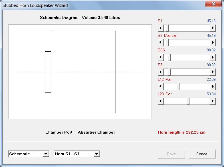

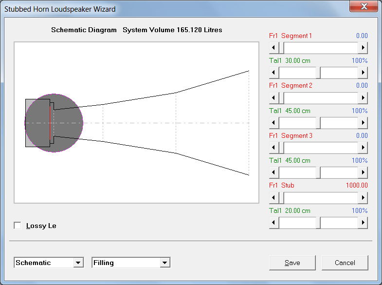

In the Loudspeaker Wizard Schematic Diagram for a stubbed horn, acoustical lining material in the rear chamber had display precedence over absorbent filling material in the stub, as shown in Attachment 5. This display precedence has now been reversed, as shown in Attachment 6.

Thankyou David, sure did cut down the learning curve. It looks like the absorber chamber does smooth the midrange nicely but the bass still has a dip I wasn't able to fill. When I compare to the standard offset horn, overall I think it looks better. An offset backloaded horn with an absorber chamber might be a good option if that were possible.
Is there any explanation for the dip and peak below 100hz in the stubbed horn model output? I can achieve a rolled of smooth response by increasing the coupling volume (increases length) but that would be impractical--I think. I tried masking/unmasking throat resonances as well. Thanks for any feedback. Datafile attached.
The main reason is because the horn mouth is so small, causing significant reflections due to the acoustical impedance mismatch at the mouth.
You may possibly be better served by using a tapered transmission line design instead.
