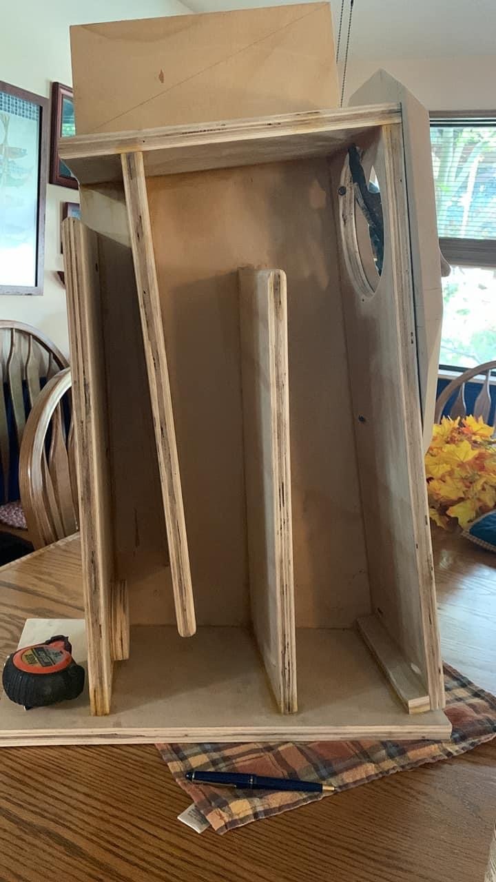

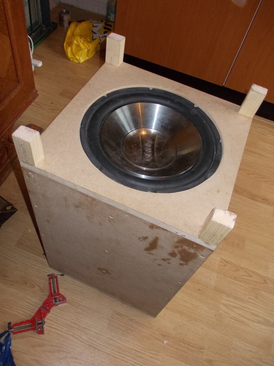

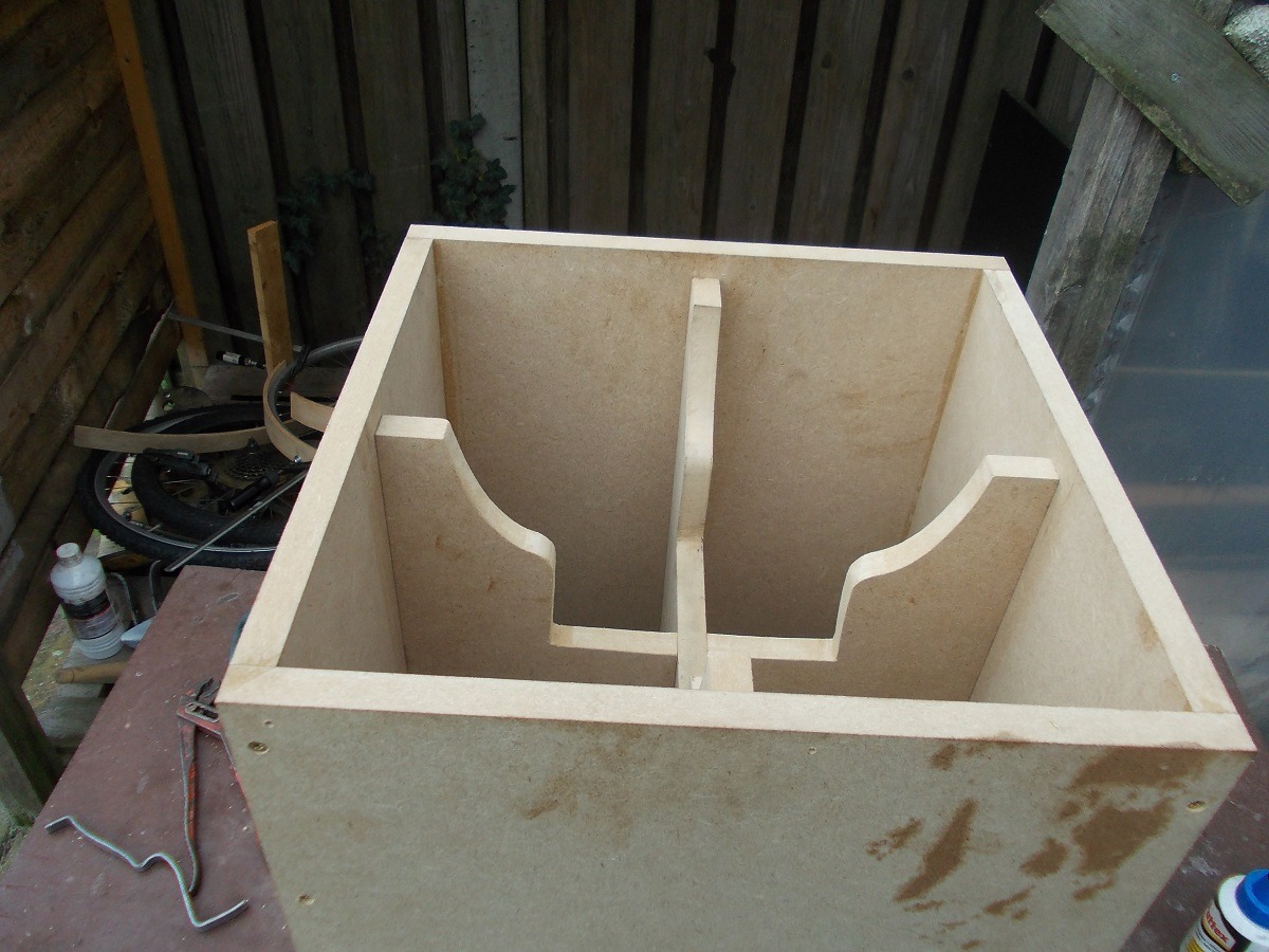

I thought I post a result of the subwoofer. The sound is
through a phone mic so do not expect super high end, is just give a idea of the result of the bass, I have connect the box
to the hybrid output who has no feedback, also for bass a less good option (lower damping).
Now I go on with curing from lyme.

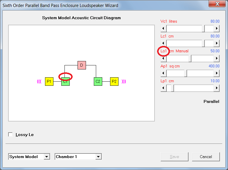

Hello David,
Do you have any schema for the BP6 design indicating how the Lo1 and Lo2 parameter are referenced regarding it's dimensions? Sorry to ask but I wasn't able to identify through the Schematic Diagram from Hornresp, I had the impression that it makes the driver move closer to the ports but it assumes only positive value, so if the offset e defined to move the driver away from port I can't add negative value. So I assume I didn't understand it correctly, do you mind to clear?
Marcelo
Marcelo
Hi Marcelo,
Adjusting the Lo1 and Lo2 slider controls should change the driver offset in the Schematic and System Model diagrams, as shown in the attachments for a BP6P system. Is this not happening for you?
Kind regards,
David
Kind regards,
David

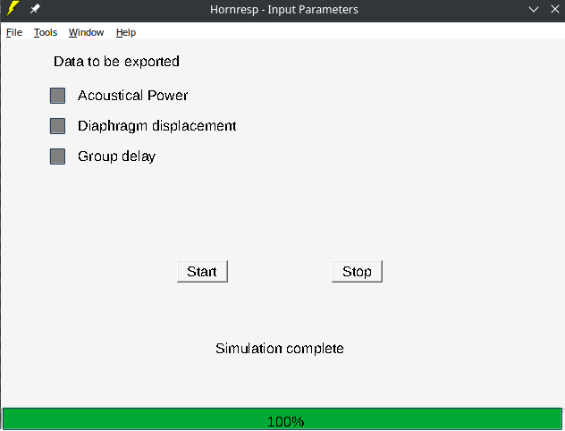

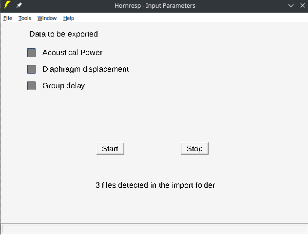

Would it be possible to create an "Auto execute mode" for hornresp?
I mean, currently, for hornresp to perform a simulation we need to manually input the data and manually click on calculate.
The idea for auto execute mode is, if the user go to tools and click on "auto execute mode", hornresp will display an specific screen for this mode and check the Import folder to see how many files are there. If the user click on the START button hornresp it will automatically run simulations for all TXT files available there. one by one and sequency, if they contain valid hornresp input data. For each simulation, hornresp will also automatically save a TXT file in the export folder, with the same name as in the import txt file containing SPL vs Frequency, or other available data, and when the last file is simulated it will shown a message that the process is complete. There is a draft in the attachment.
This function would speed up interactions with hornresp and improve the fine tune process for loudspeaker in order to achieve the best performance possible, besides the loudspeaker wizard is fantastic, in a real box due to its layout one dimensions affect many other and CAD support / boxplan is needed in this process and many TXT files might be created in this process.
This new function would save a lot of clicks when there are a lot of simulations to run.
Sorry if I'm posting too much or too often here, don't hesitate to warning me if needed.
Best regards,
Marcelo

Hi Marcelo,
It's a great idea, and I would very much like to implement it, but unfortunately at this late stage in the development of Hornresp, it would require just too much work. Code that is currently distributed across many different forms would need to be centralised in a global module, and the associated local variables would also need to be made global.
If it had been known right at the beginning that the feature might be required some time in the future, then the coding architecture could have been set up differently, to take that possibility into account. Unfortunately it is just too late to change things now. As you know, Hornresp has evolved from very modest beginnings to what it is today without there being an over-riding master plan in place, and the coding structures reflect this ad hoc approach.
Ideally the program should be completely re-written now to tidy things up, but that is not going to happen .
Not a problem, I welcome all posts relating to Hornresp, and from anyone.
Kind regards,
David
