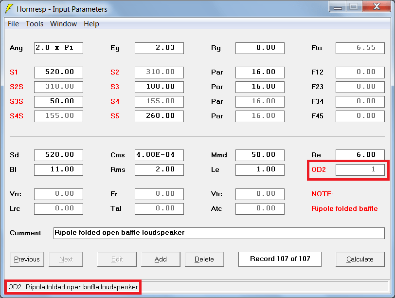

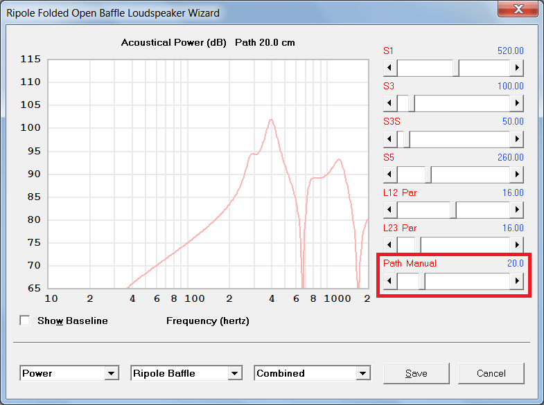

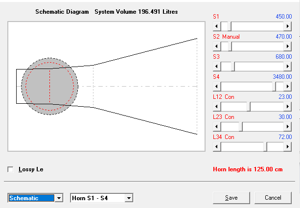

Hornresp Update 5440-221015
Hi Everyone,
CHANGE 1

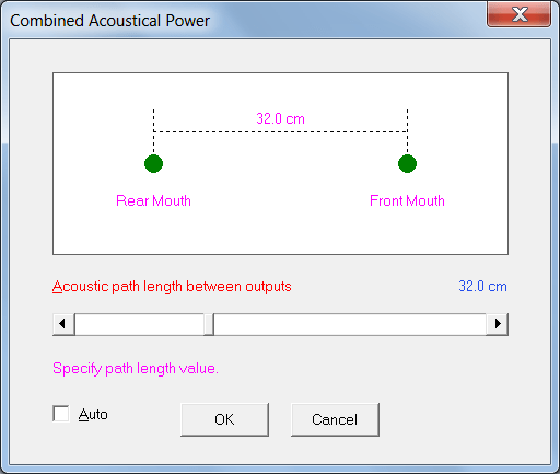

A ripole loudspeaker can now have an odd number of drivers, side panels can be non-parallel, and the path length can be manually set. Attachments 1 to 3 refer.
CHANGE 2

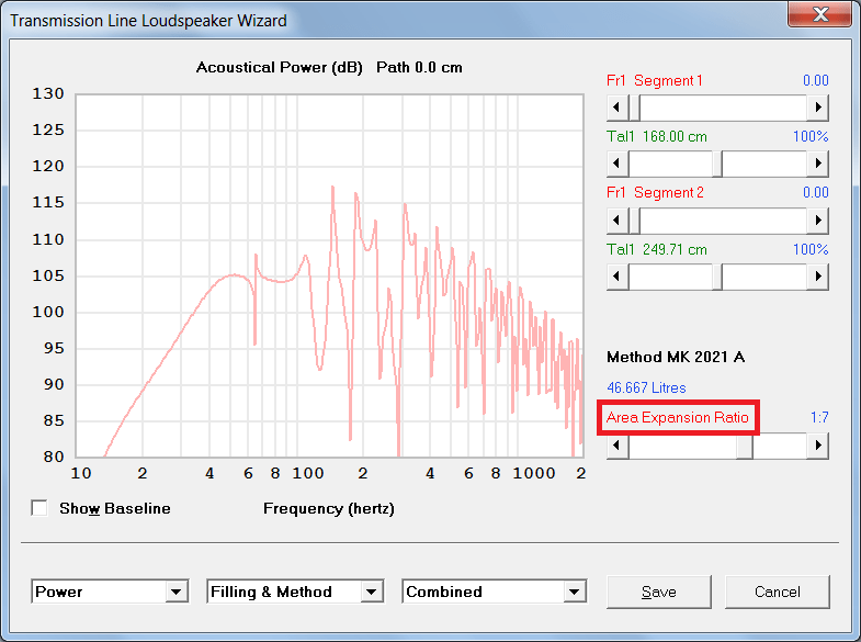

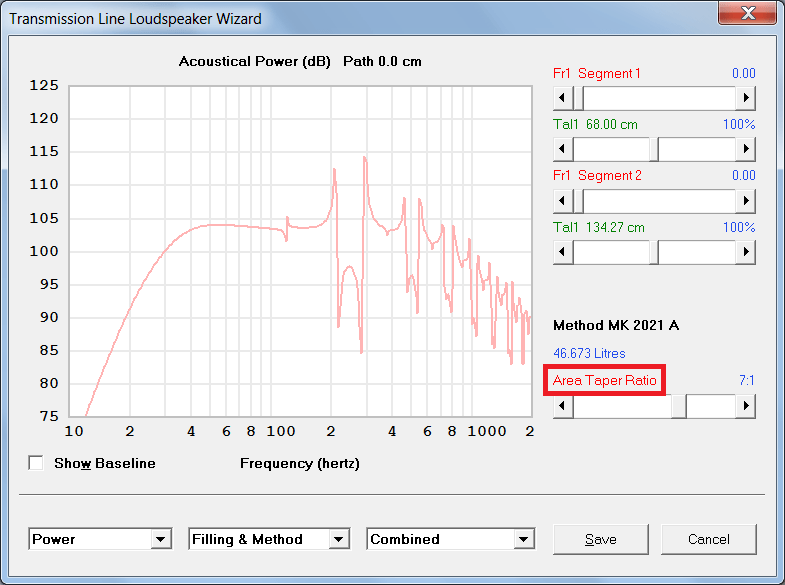

Methods MK 2006 and MK 2021 in the TL Design tool now support both tapered and expanding transmission lines. Double-click on the 'Area Taper Ratio' label to specify an expanding transmission line. Attachments 4 and 5 refer.

"change 2": many thanks David. This will certainly help with comparing options and tradeoffs between the different enclosures. I had a play with default settings for the 2021 MJK B method. A useful starting point on the journey of deciding a practical enclosure to be built.

CHANGE 1
That is really awesome, very useful additions, thanks!

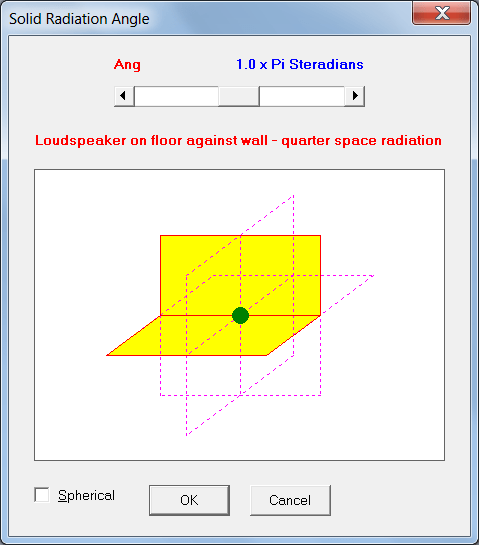

Two thoughts came up to me, as the SPL of ripole simulations seem to be surprisingly high, but in reality riploles are considered to be not very efficient:
-The boost by the rear wall in a quarter(and eight) space radiation should probably not be taken into account, as it is effectively replaced by the "Path" setting.
-Is the loss of energy for the sound traveling(to real wall and back to the speaker panel) along the "Path" taken into account?

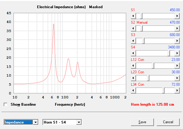

Hi I have a couple questions related to impedance. Ive designed a horn to be used in the 80-200 Hz band and have achieved my desired response but am struggling to shift the second impedance spike out of the operating range.
1) How much of an effect will this spike have on the performance and how important it is for me to try get rid of it while juggling other important aspects of the horn.
2) If there is, what is the most effective way to reduce/remove this impedance? I have attached a photo of the horn and impedance graph.
All help and advice appreicated.
Just to clarify - the "Path" length is the distance between the two point source outputs. There is no loss of energy.
For further information see Post #10,453 linked below, and the three further references contained in that post.
https://www.diyaudio.com/community/threads/hornresp.119854/page-523#post-6069923
Thank you for these infos.
The combined power response of two sources is dependent on their individual magnitude/phase, and the separation distance between them. The pressure response @ 1m is then calculated for a point source having the equivalent power response. The relative distances between listener and sources does not come into play, only the separation distance between the sources.
So this is true regardless if it'a monopol+port(radiating in all directions) or dipole(radiating in opposite directions). What confuses me is how to get the distance of the rear wall into the simulation, as this is more crucial for dipoles than with monopoles because of the 180° phase shift to the rear, which adds or cancels when arriving at the listening position depending on frequency, and it also looses some db on the journey.
From https://www-dipolplus-de.translate...._sl=de&_x_tr_tl=en&_x_tr_hl=en&_x_tr_pto=wapp :
  • If the path from the back of the membrane via the front wall back to the level of the baffle is an odd multiple of half the wavelength, then this sound meets the sound from the front of the membrane offset by another half wavelength. Reinforcement is coming.
  • If this path is an even multiple of half the wavelength, then this sound meets the sound from the front of the membrane without any offset. It weakens.

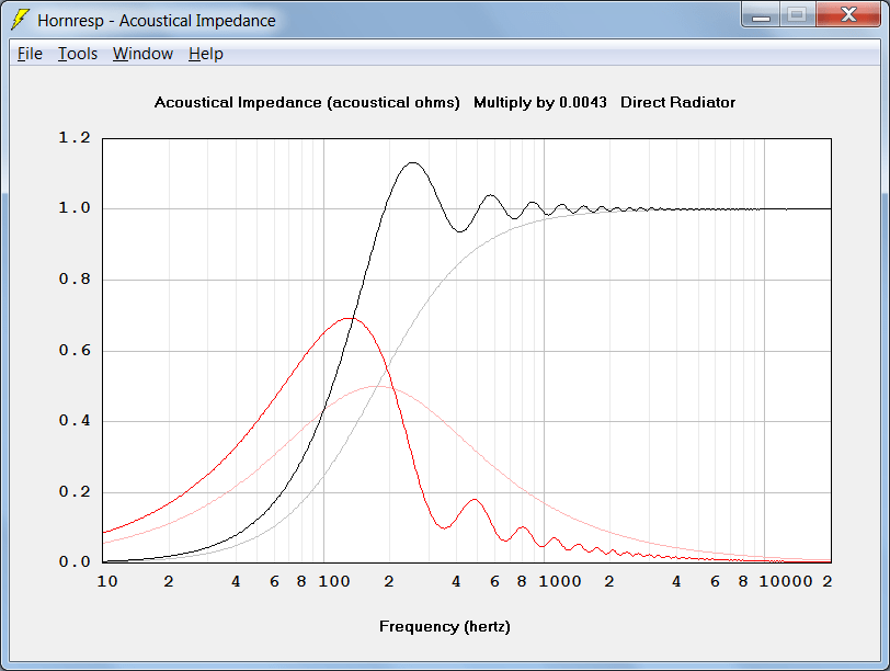

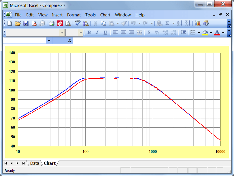

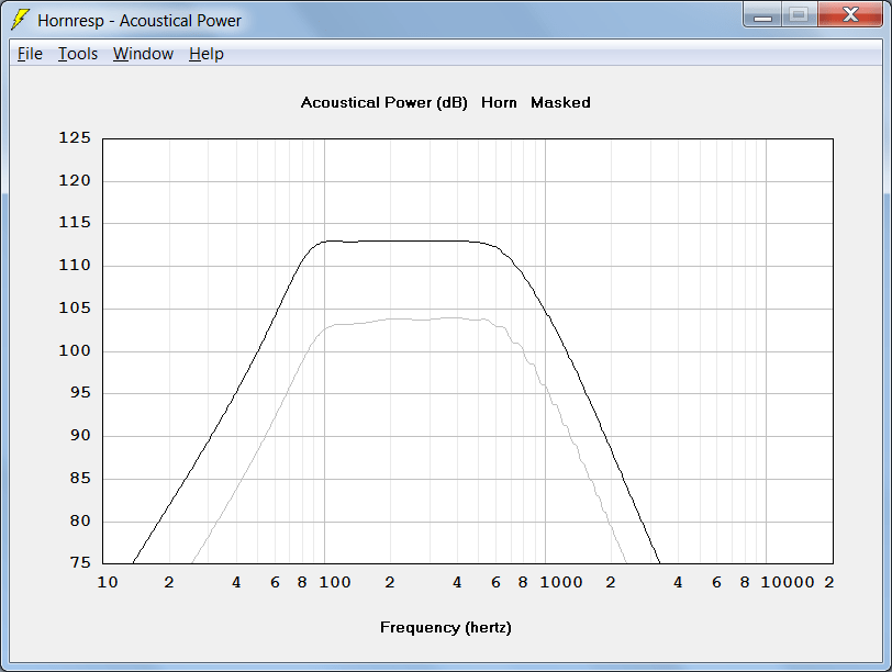

A loudspeaker terminated by an infinite conical segment having the same solid angle as that specified by the Ang parameter, will produce different results to those obtained using just the loudspeaker and Ang value.
To illustrate:
Attachment 1 shows the normalised acoustical impedance at the mouth of the default horn system when Ang = 0.5 x Pi (dark traces) compared to the mouth impedance of the same system when terminated by an infinite conical segment with Fta = 41.5 degrees (light traces).
Attachment 2 shows the power response of the default horn system when Ang = 0.5 x Pi (dark trace) compared to the response of the same system when terminated by an infinite conical segment with Fta = 41.5 degrees (light trace).
Also, a combined response cannot be obtained when an infinite segment is used.
To illustrate:
But why is the response different? Shouldn't they be the same? Why does Hornresp treat them differently?
Maybe think of it from the other end. The environment is the "load" on the speaker. Because the environment is different, the "load" is different and the results are different.
https://trueaudio.com/st_spcs1.htm
Yes, but why is it different? They both have the same solid angle so the loudspeaker should be seeing the same load. Maybe it's the abrupt transition from circular cross section to triangular that is creating the discontinuity, causing some sound to be reflected back to the throat.
With the infinite segment included it is not possible to determine the absolute level of the power response because there is no finite mouth area upon which to base the calculations. In order to produce a power response chart for the infinite case, for the purposes of the calculations Hornresp arbitrarily assumes a 4 x Pi environment. To directly compare the infinite results with those for Ang = 0.5 x Pi it is therefore necessary to add 3 x 3 dB (4Pi->2Pi->1Pi->Pi/2) or 9 dB to the infinite results. When this is done the comparison chart is as shown in the attachment (blue trace = 0.5 x Pi, red trace = infinite segment).
The remaining difference at the low frequency end is because Hornresp uses the standard 1P (one parameter) horn loudspeaker model, which assumes that under 2 x Pi conditions the radiation impedance at the mouth is that of a circular vibrating piston in an infinite baffle. The radiation impedance is adjusted accordingly when the specified solid angle is other than 2 x Pi. As shown in Attachment 1 in my previous post, the impedance so determined is never going to be the same as that at the throat of an infinite conical horn. For one thing, there will be no ripples in the infinite horn throat impedance because there is no mouth impedance mismatch to produce reflections.
