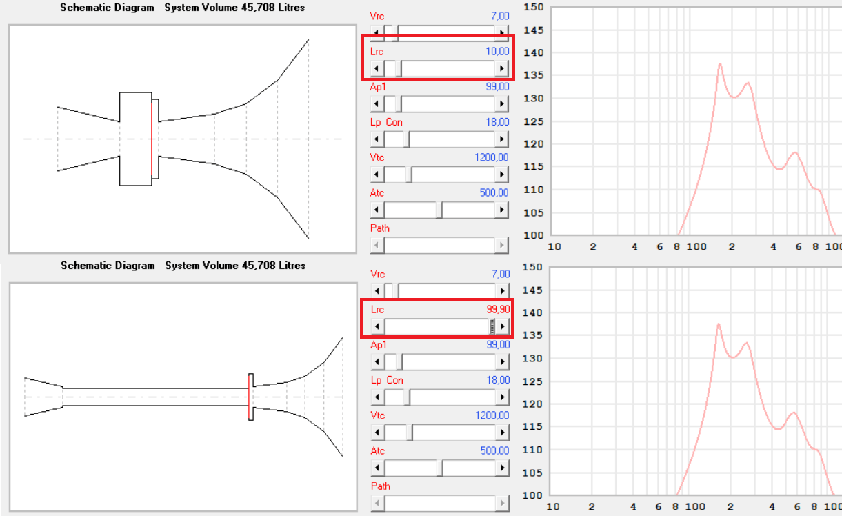

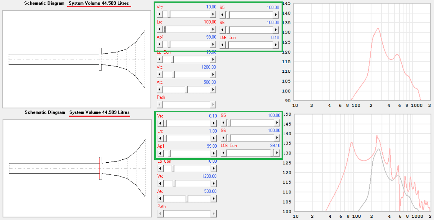

i was playing arround with some compound horn with rear chamber, when i seemed to find an error.
While simulating the rear chamber, there is absolutely NO effect at all, varrying the chamber depht (Lrc) as you can see.
I am pretty sure this has some heavy impact in reality. Am i doing something wrong here?
On the other side, while modeling the same volume of air with the same shape, i get different results... depending if i use the horn (S5+S6+L56) or the chamber (Vrc+Lrc) to model it... while keeping the other stat at 0,1.
Any ideas?

Hi TechnicSummse,
Thanks for the feedback. The good news is that the results you are getting are not due to a bug
To obtain the results you were hoping to see for both the test examples you provided, simply change the chamber resonances option from "Masked" to "Not masked".
When the "Masked" option is selected the air volumes in the front and rear chambers are treated as a simple acoustic compliances. For the rear chamber this means that only Vrc is taken into account, and changing Lrc makes no difference to the results.

Hey David, thanks for the fast help.
I think i get the point here... but adding a port/horn to the chamber adds a second output wich varries with chamber lenght, right?
Whats the benefit, of ignoring the Lrc, besides simpler calculating?
Correct.
Changing the chamber length alters the position of the resonances.

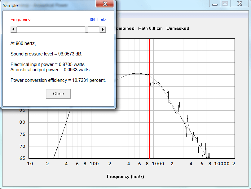

The attachment compares the masked (grey trace) and unmasked (black trace) response results for a standard ("Normal") bass reflex loudspeaker radiating into half space, created using the Input Wizard.
The chamber resonances in the unmasked response at higher frequencies can be clearly seen. The rear chamber depth Lrc is 20 cm and the speed of sound is assumed to be 34400 cm/sec.
Lrc = 0.5 wavelengths at 860 Hz
Lrc = 1.0 wavelength at 1720 Hz
Lrc = 1.5 wavelengths at 2580 Hz
Lrc = 2.0 wavelengths at 3440 Hz
Lrc = 2.5 wavelengths at 4300 Hz
And so on…
If Lrc is changed, the resonance positions alter accordingly.

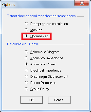

The Masked option enables Hornresp results to be directly compared against those produced by other simulation programs that use the simplified air chamber compliance model. Also, using the Masked option is another way of showing how adding acoustical lining material to an enclosure can dampen resonances.

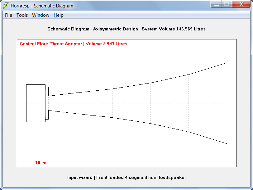

Is 4 segments limit hard coded or can't I just find a command to add more segments?
Hornresp is limited to 4 segments except in the special case of Paraflex horns, where 7 segments are used.
In some designs a throat adaptor can be specified to in effect add a fifth segment, as shown in the attachment.

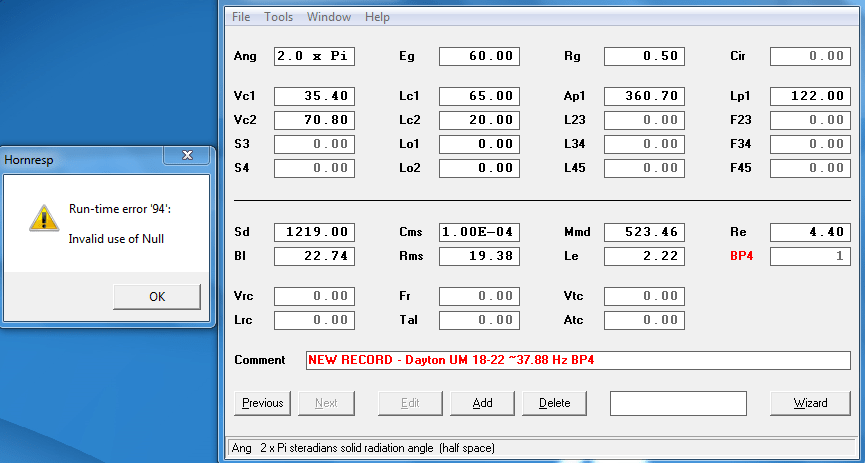

OK, what 'null' did I manage to miss this time?
This is really weird, I have no idea what is causing the Error 94 problem you are intermittently experiencing. I have tried everything I can think of but have not been able to replicate the problem.
Not one else has reported a similar issue and I am at a loss to explain why it should be you only - you're just lucky, I guess
