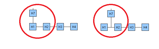

Just to clarify, the first case shown in the attachment below was not actually generated by, or is used in, Hornresp because of the confusion it can cause - by implying an offset rather than an inline connection.
This is also shown on the System Model diagram, when the Sd and S9 sliders are selected.
I never came up with the idea to check the system model, when changing driver parameters, especially because i can not change the driver, it is as it is :LOL:
Also, at first, i could not imagine, the opposite side of S9 could really be purely SD, since this would be really hard to design in real. But atleast i can now clearly understand, how the system model works.
Do you want me to remove that image? I did not think about it beeing confusing for other people if i did not change H7 to H3 for example. It was just easier to copy/paste the H7 :D

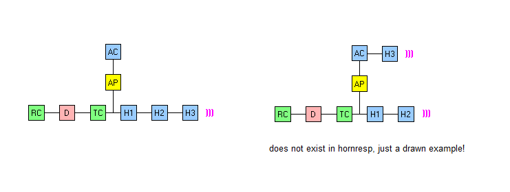

Since i now understand a lot more, i did model a lot of different box types, just to see, how they work with my driver.

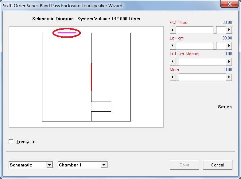

At the end i realised, that i want a box with 1 side of the driver closed. But there seems to be ONLY front loaded horn and bandpass type b (wich are both basically the same... you can model a big throat getting smaller to act like a chamber of the bandpass, or you can model the first chamber beeing smaller then the following port, wich also results in like a horn [i hope one can understand what i am talking about here :D]), wich then result in the same box.
But what i really miss, is a possibility to model something like a bandpass or double reflex or bi-chamber at the opposite side of the closed box.
Or in other words, just a second "path" for tuning, but going from that one opposite side of the driver. Like in the following picture:
Or is there any way, to take the output of a model, and insert as a driver in a new model?
Kind regards
Benni
Edit:
I just realised, i did skip the stubbed horn while simulating... maybe that one will do the trick like it is!

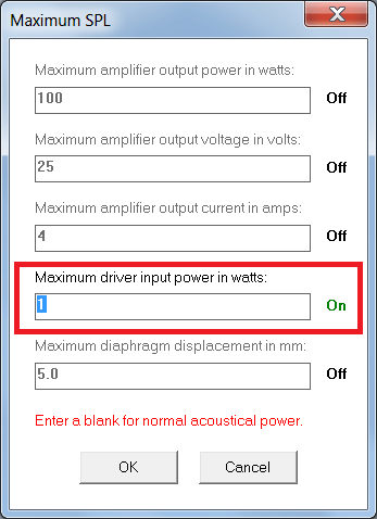

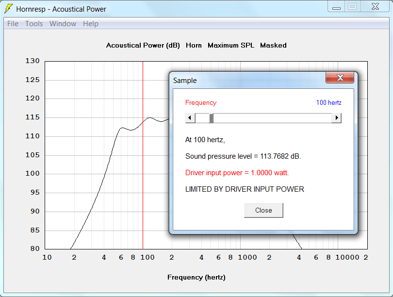

Would it be possible to add a function into the "window menu" or "tools menu" in the "acoustical power" window to plot a graph of 1Watt of real power input (not apparent power) versus SPL?
Hi Crashpc,
I'm not sure if it gives you what you want (as it plots frequency versus SPL rather than power versus SPL) but the Maximum SPL tool can be used to specify a constant 1 watt input, as shown in the attachments.
Kind regards,
David
Yes, frequency versus SPL is what´s needed. Just to clarify....
Yes, the recommendation of maximum power tool is very helpful, yet little more is needed. This is apparent power. Real power with CosFi (phase angle) is needed for purpose of coil heating aproximations and such. And with my limited Hornresp knowledge, some data export of the values would be immense too. To this day I did combined printscreens.

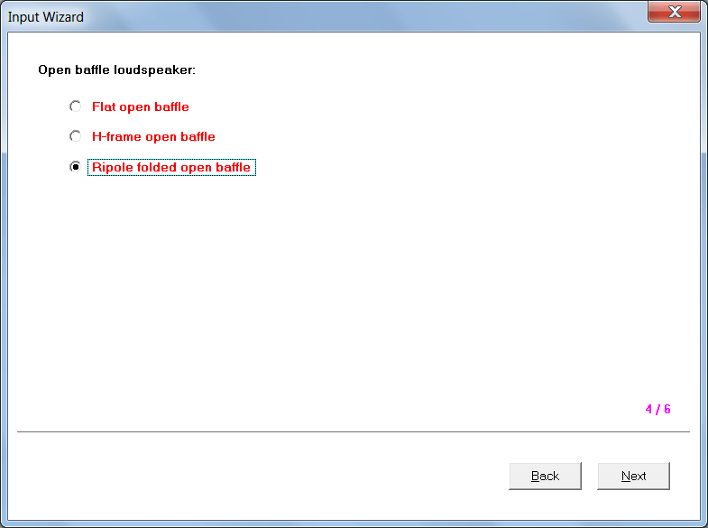

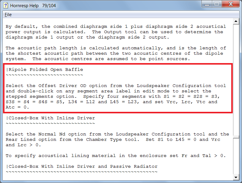

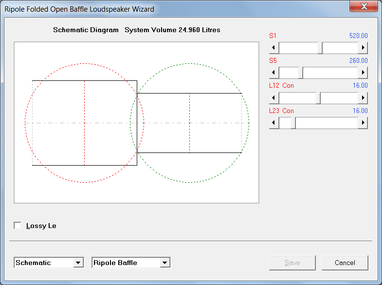

Hornresp Update 5400-220507

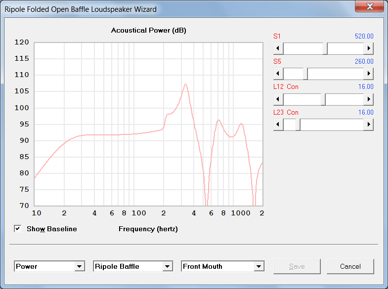

Hi Everyone,
CHANGE
Ripole folded open baffle loudspeaker designs can now be simulated. See the 'Ripole Folded Open Baffle' section in the Help file for details.
The simplest way is to specify a Ripole is to use the Input Wizard to generate a template design and then modify that design as necessary using the Loudspeaker Wizard.
BUG FIX
The inconsistency in results identified in Post #12,688 has now been fixed. My thanks to grindstone for reporting the problem.

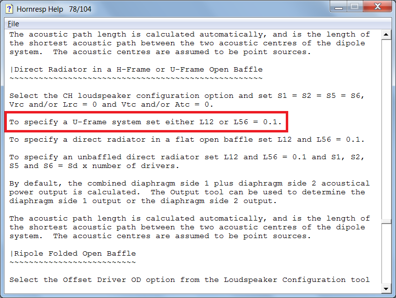

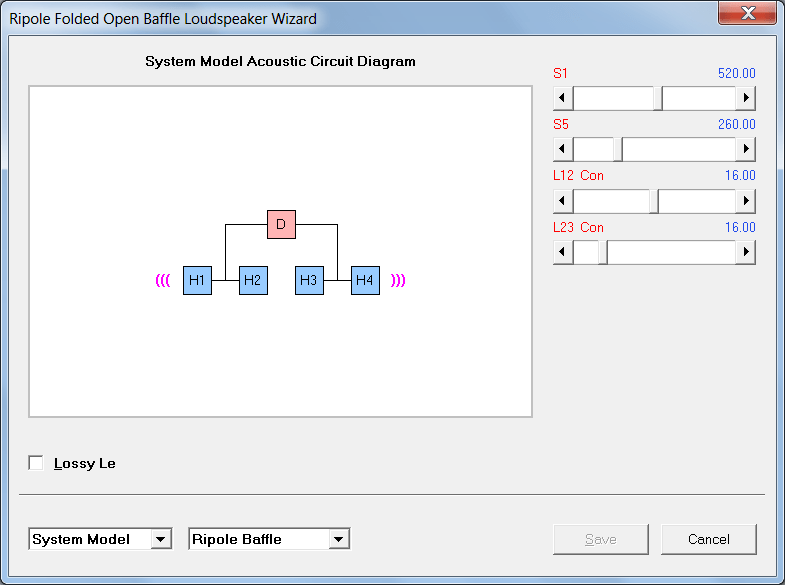

That's an incredible update!
Question, if people want to simulate a U-frame dipole, can they just use the H-frame option and change one of the lengths to a small number?
