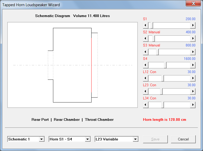

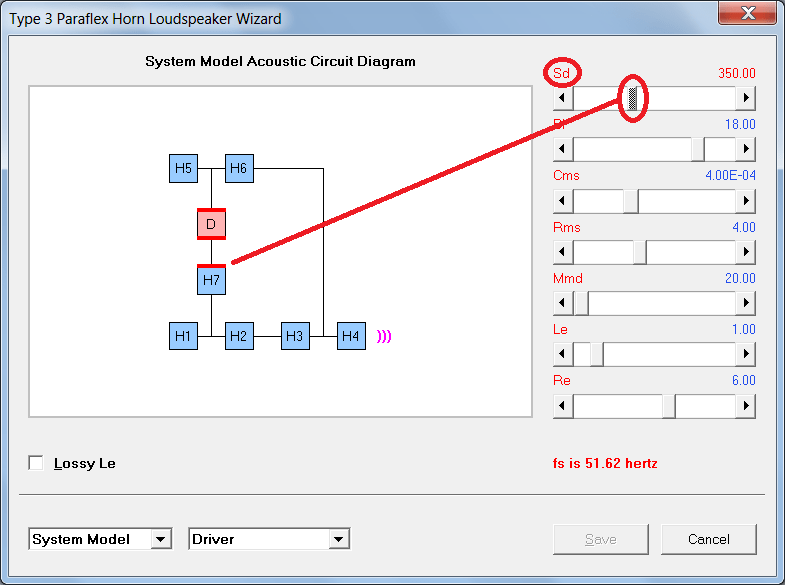

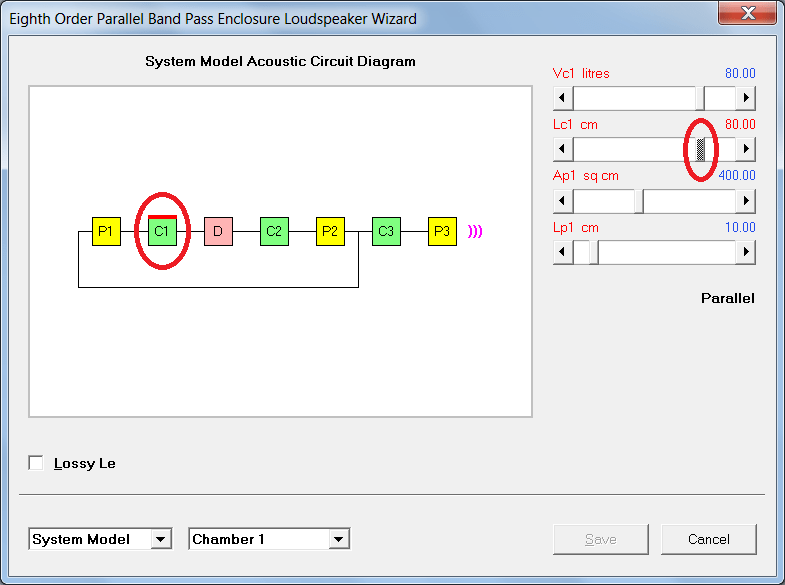

When a Loudspeaker Wizard slider is adjusted the dimension being altered is highlighted in red on the System Model - see Attachment 1.

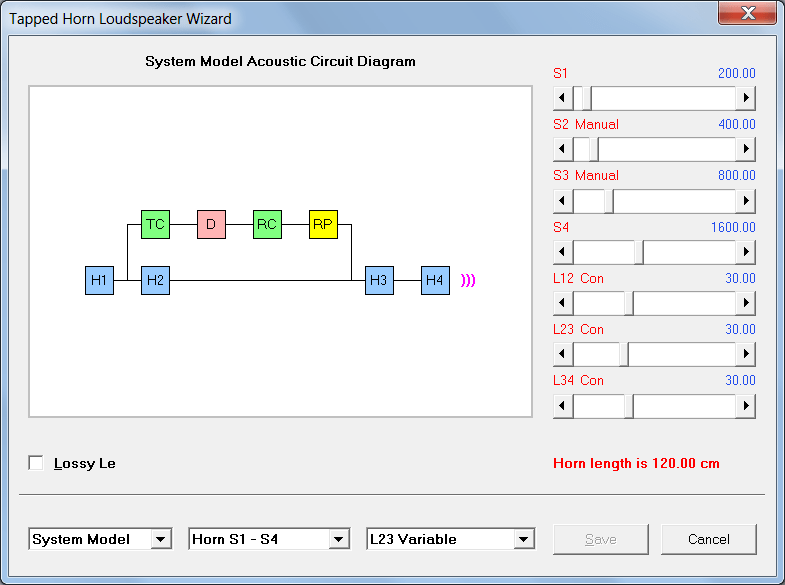

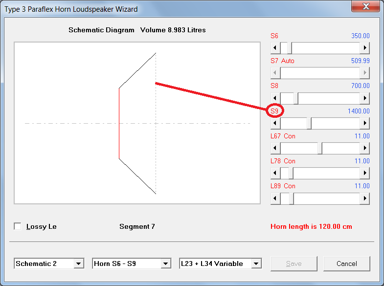

Select the Schematic 1 and System Model options in the Loudspeaker Wizard to get a better understanding of the layout - see Attachments 2 and 3.

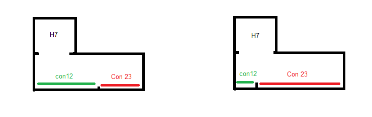

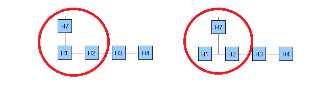

Wouldnt they result in the same box, just with different numbers in the program? For example like this:
Also... for example 1, how does the program know, where at what exact position of H1 the H7 is entering?
Or schould i see it more like the following imge?

Ok, so about that... there is no magic trick about S7? It is just a chamber with the calculated volume, it does not have a special value or something... just random size as wanted, but not possible to enter manually?The value of S7 is calculated automatically from the values of S6, S8, L67 and L78 simply because there is no room left on the main input parameters window for it to be specified independently.

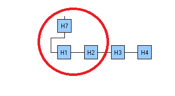

My problem is the understanding of the "joints". What exactly is the difference of these two connections?Select the Schematic 1 and System Model options in the Loudspeaker Wizard to get a better understanding of the layout - see Attachments 2 and 3.

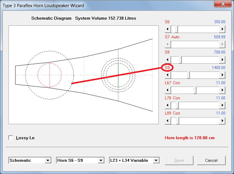

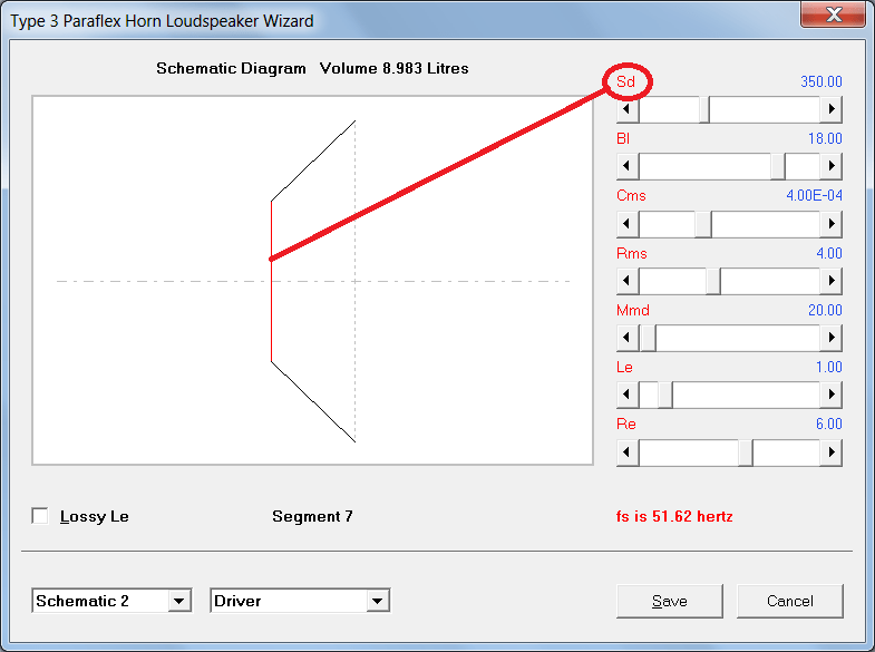

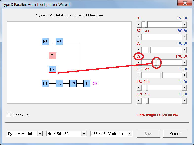

But.. what i was intendet to ask about, is the area, wich the driver is mounted to in H7, like in the following image.
Is it the same as S9? Or is it just the cone area of the driver? Or is it even something completely different?
Sorry, i was thinking about S7 as the wrong thing on the system model... it is just the horn area inbetween s6 and s8, and i can now clearly understand, that you can simply calculate that by the lenght of these two!The value of S7 is calculated automatically from the values of S6, S8, L67 and L78 simply because there is no room left on the main input parameters window for it to be specified independently.
It is really no different to an electrical circuit - in the first case the three elements (H7, H1 and H2) are connected in series, so the "current" passes through each in turn. In the second case the "current" passes through the first element (H7) then divides, with some going into the H1 load and the rest passing through H2.
Yes.
The end of H7 (segment 7) you have highlighted is equal to Sd, the other end is equal to S9, as shown in the attachments.
Amazing! Thank you!
That cleared a lot of that fog in my head.
This is also shown on the System Model diagram, when the Sd and S9 sliders are selected.
