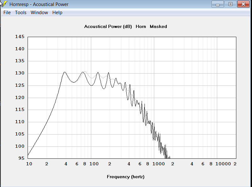

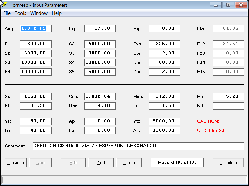

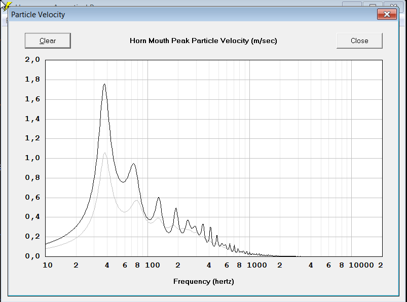

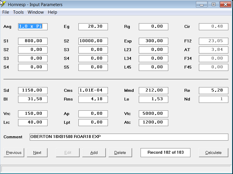

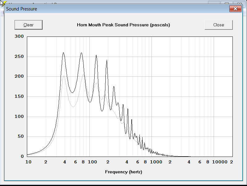

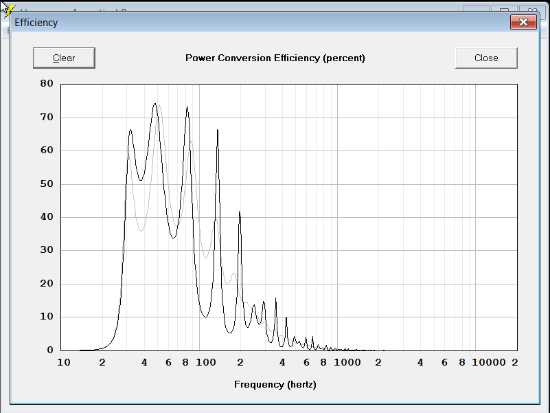

I tried to simulate a normal exponential horn and a front resonator enhanced exponential horn with roughly equal behavior in the bass range.
Grey lines is the pure exponential horn and the black line is the front resonator enhanced exponential horn.
The constriction in the open end of the quarter wave resonator (front resonator) creates a substantial increase in particle velocity. If Hornresp does not account for the exponential increase in air particle momentum and the effects of inertia which get quite substantial at 140 dB and above, then I don't think it will predict the maximum spl and power compression correct.
