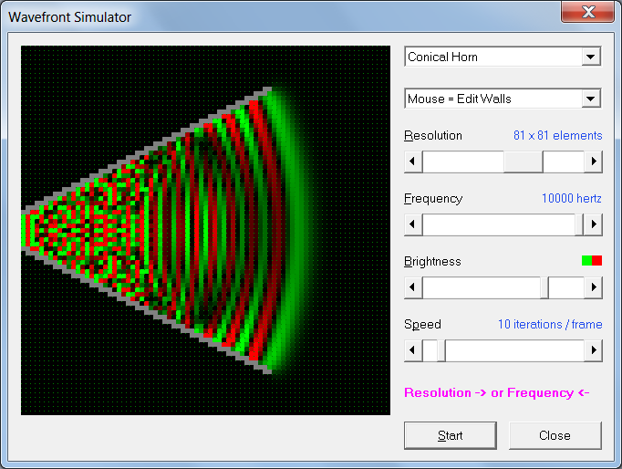

Is the "dimension" minimum(2.22 cm) in the ripple tank simulation a constraint on the upper frequency limit it is possible to accurately simulate?
Hi Mark,
The upper frequency limit that can be accurately simulated before aliasing effects start to impact on the results depends upon the sampling rate, the resolution setting and the window size.
The guidance message "Resolution -> or Frequency <-" is displayed when the upper frequency limit is exceeded.
The attached screenprint shows the effect of aliasing (very obvious in the first half of the example horn).

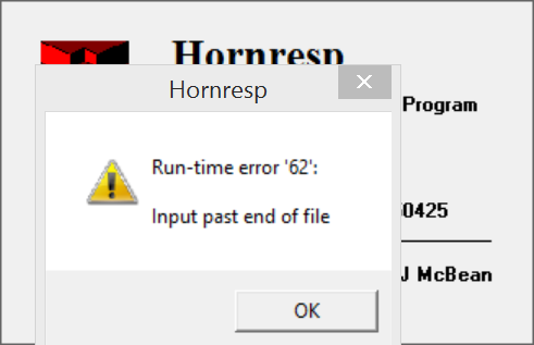

just got this error, anythoughts (on startup).
Hi sine143,
It would seem that your Hornresp.dat file has been corrupted in some way. This is most unusual.
If the data is important to you I may be able to fix the file, if you care to send me a copy.
The Hornresp.dat file is located in the 'Data' sub-folder under the folder in which you have placed the Hornresp.exe application file.
Click on my name on the Hornresp download web page for my email address.
If the old data is not critical, simply deleted your existing Hornresp.dat file and a new one will be automatically created when you next start Hornresp.
