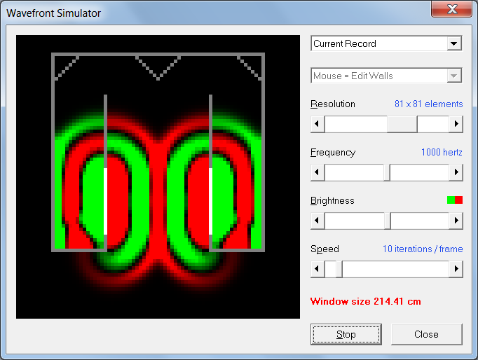

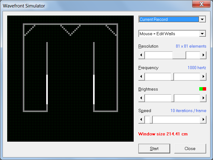

Hornresp Update 3940-160101
Hi Everyone,
The following changes have been made to the Wavefront Simulator tool.
1. A grid is now displayed when in Edit mode (see attachment 1).
2. Driver polarity is now specified by the order in which the diaphragm end points are set. Multiple drivers can have different polarities (see attachment 2).
See the Wavefront Simulator description in the Tools Menu section of the Hornresp Help file for further details.
Kind regards,
David
