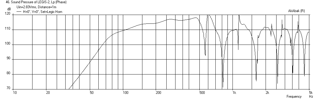

That's interesting, Hornresp does not predict as much gain on the top end for a OD FLH. Can you post the script? Akabak does not calculate using parabolic expansion, could that be the difference?
NeoDan,
Here is the Akabak script for the Legis horn. The geometry is just as he has drawn. I assumed that he wanted to drivers to be mounted as close to the back as possible, so based on diameter of the driver, I determined it needed 200 mm of clearance from centerline to the back edge of the horn sidewall. Based on a 30 deg half angle, this places the axial distance from the vertex to the driver injection point at 173 mm. It is quite a simple geometry and I assumed a linear expansion (not conical, or exponential). I just noticed that I was using a -12dB/oct HPF and not a -24dB, so maybe even more power can be eeked out of this - not that it is needed though :D

That has a rear chamber - i wonder if that is the difference?
I cheked and the "acoustical power" graph of Akabak is more like hornresp's acoustic power graph. I cannot choose the hornresp to show tools -> directivity -> response -> 0deg with the NEO Dan's sim for some reason (the whole directivity-option is grayed-out). Why is that? I think it would be the corresponding graph for the "acoustical pressure" graphs of Akabak that you attached previously.
Does the Akabak and/or Hornresp take into account the "mass break point" of the driver? I calculated it to be approx. 205Hz with that Eminence driver (Bl^2 / pi * Re * Mms in kilograms [ie. 72g = 0,072kg]). I'm not sure does that apply since the compression ratio at throat is miniscule (or non-existent) and the drivers do not have a back chamber. But, if Akabak does not take that into account and hornresp does, it would also alter the graphs.
If I understand the drawing correctly, the sim is an OD (offset driver horn), which logically requires at least two segments. The directivity tool is only available on one segment horns (which necessitates using Nd instead of OD). You could make a comparable one segment horn with the drivers firing into the throat just to see what effect different angles have on the response, and then imagine that as a transfer function to apply to the OD simulation. But as far as I know there's no other way to get directivity response of an OD horn in hornresp.
Ok, that's too bad for multisegment horns!
The difference in power response (lighter trace) and front/0deg frequecy response (darker trace) is quite big in "similar-ish" (or maybe not) monosegment horn:

I am not sure if I understand the nuances of what you guys are trying to do in Hornresp with power and pressure at 0 deg. The type if data I generate with AkAbak is the standard sound pressure plot at zero deg I usually always make. Is there something else I should be setting on AkAbak for you to compare? This is a very simple, albeit complicated by rear firing radiators, 2 segment horn so I hope I did not mess it up. Let me know if you want me to try something g different.
The plots you made were the correct ones, ie. the 0deg freq response. At first I mistook Hornresp's power response for a 0deg freq response but they are two (very) different things.
One thing you could try, is to use a 20-60 litre back chamber for the drivers and how that changes the response near the low and upper cutoff points. The chamber could also be tried with a leaking/acoustic resistance port, that would delay the rear wave and control (make narrower) the radiation pattern near the low cutoff. However it might be a bit complicated to simulate! :)

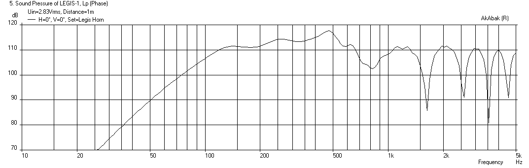

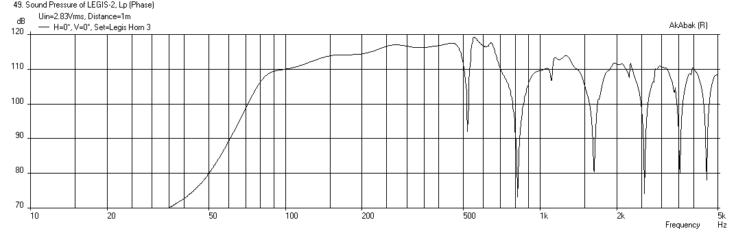

Legis Horn with sealed rear chamber and with vents
Looks better between @ 25-30 per driver.
Here is the Legis horn case (a) with open back, case (b) with a 30 liter (ea) sealed back chamber, and case (c) with a 30 liter back chamber that has a 4 in dia x 10 in long vent aimed backwards +/- 60 deg from centerline.
Case (a) open back at 2.83v and 1 meter:
Case (b) sealed 30 liter rear chamber (Q=0.5) at 2.83v and 1 meter:
Case (c) with 30 liter chamber and 4 in dia x 10 in long vent:
The vented rear chamber case obviously has the deepest bass extension. What is interesting is that the open back case loads the cone better than the sealed chamber, and is about the same as the vented case.
Here is the script - remove comment | before the OFF in the Vent Radiator specification to turn vent off.

Driver Def='Deltalite15' 'Driver 1'
Node=1=0=11=201
| Right driver when viewed from front
Driver Def='Deltalite15' 'Driver 2'
Node=1=0=11=202
Enclosure  'Back chamber 1'  Node=201
Vb={Backchamber_vol}  Qb/fo={Q}  Lb=12in
Duct    'Vent 1'  Node=201=211  | rear vent left
    dD=4in  Len=10in
Enclosure  'Back chamber 2'  Node=202
Duct    'Vent 2'  Node=202=212  | rear vent right
    dD=4in  Len=10in
| Backside vent radiators angled at 60 deg back - left driver angled left back
|OFF
Radiator  'Rear_Rad1'  Def='Vent 1'    Node=211
    x=-0.173m  y=0  z=-0.827m  HAngle=-60  VAngle=0
    WEdge={Width/2}  Hedge={Height/2}  Reflection
Label=10
| Right vent radiator angled back right
|OFF
Radiator  'Rear_Rad2'  Def='Vent 2'    Node=212
    x=0.173m  y=0  z=-0.827m  HAngle=60  VAngle=0
Label=20
| ### HORN WAVEGUIDE
Waveguide 'Horn Seg 1'  | From vertex to driver at node=11 (both drivers excite node 11
Node=10=11
STh={S0*Height}
SMo={S1*Height}
Len={L01}
Waveguide 'Horn Seg 2'  | From driver injection point to mouth
Node=11=12
STh={S1*Height}
SMo={S2*Height}
Len={L12}
| ### Main horn mouth radiator
Radiator  'Horn Mouth'  Def='Horn Seg 2'    Node=12
    x=0  y=0  z=0  HAngle=0  VAngle=0
Label=30
Thanks for the sims, I love this community for being so helpful! I will check that out better in the evening.
I would also suspect that the load does not drop above the driver's Fs. There are two kinds of "loading". One is the load that comes from the horn (let's say between 100Hz - 500Hz). When that ends when we go down in frequency, there is the "mass controlled" band between the low cutoff of the horn and the drivers Fs (let's say 35Hz-100Hz), including the air mass of the horn that increases the driver's Mms and lowers the Fs. And below that the woofer is only controlled via it's mechaninc suspension. So the open backed situation is not that bad excursion-wise that one might prima facie think. Adding a small rear chamber one rises the Fc (system resonance) to much higher than Fs would be open backed, so the band starts sooner where the woofer is only controlled by it's suspension (and the air spring of the closed box).
For "ported" version I ment "acoustic airflow resistance" port, that does not act as Helmholz but as a flow resistance that delays the sound. Check this site out: Cardioid bass
Can the Akabak (or any other sim) simulate such "flow resistance" constructions?
What shows this?
Could you explain how you read the info and how you came to your conclusion?
I spoke to Lockwood a few years ago and during the conversation he asked "have you considered not using any back box" on the front loaded horn. It could be very good. i.e. he was suggested a no box for the loft mounted drivers feeding the bass horn.
Founder of XSA-Labs
Joined 2012
What shows this?
I started a new thread to fully discuss the 'Legis' dipole/cardioid bass horn here:
http://www.diyaudio.com/forums/subwoofers/258706-study-dipole-cardioid-bass-horn.html
The response to your question on how do we know the loading on the open back is greater than the sealed back is presented there.
X
