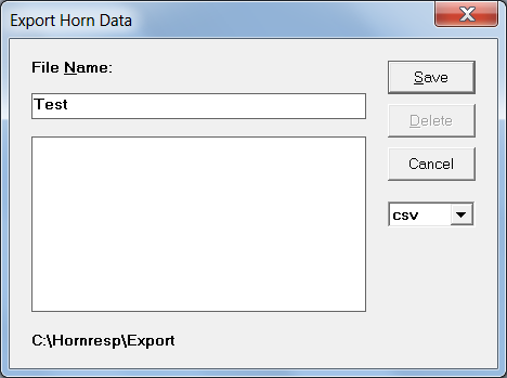

Hi Paul,
You should see a form similar to the one shown in the attachment. By default, a text file is specified - with the generic file name *.txt being highlighted in the File Name input box.
A comma-separated values (*.csv) file can be chosen instead if required (so that it can be directly opened in Excel, for example) by selecting the csv option from the drop-down list. After specifying the file format, key the desired file name into the File Name input box, and then press the Save button.
The data file will be placed in the folder shown at the bottom left of the form. For the given example, the exported csv file is called Test.csv and is saved to the C:\Hornresp\Export folder.

That is exactly what I am doing. However, neither I nor Explorer can find the file...there doesn't seem to be a "C:\Hornresp\Export folder". (Hornresp folder exists but not the Export folder.)
Interestingly, when trying to overwrite the file, the standard error appears "file already exists do you want to overwrite?". So it must exist somewhere???

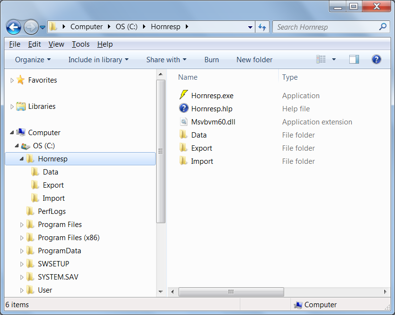

Hi Paul,
This is very strange indeed. There should be three sub-folders named Data, Export and Import just below the Hornresp folder in which the application files are located (see attachment). What version of Hornresp are you using?

Hi David,
There are no sub-folders for Data, Export, or Import. Beyond what you show, there is an additional readme file but nothing else. Hornresp is V34.80. PC is Win7 64 Ultimate.
I tried manually creating the Export folder, but nothing gets saved there when I Export.

The missing folders are created the first time Hornresp.exe is run. Since the folders are "missing" it is then plausible you are launching Hornresp.exe that is actually in another location. Very easy to do if you use a shortcut.

Hi Paul,
This is becoming more and more weird - unless there are multiple copies of Hornresp in different locations, as Dan says.
In Windows Explorer, try double-clicking on the Hornresp.exe filename. This should start Hornresp and automatically create the Data, Export and Import files. If this does not happen, then I have no idea what is going on .
