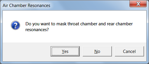

Hi GM,
Are you absolutely sure that you pressed the 'Cancel' button and not the 'No' button on the attached message box? If you did press 'Cancel' and the main input screen 'Calculate' button subsequently worked, then your computer is possessed - there is no way in the world that the bug in the Hornresp code could allow it to happen!
This is all very weird - the sort of thing that usually only occurs in "The Twilight Zone"... :).

Hi Everyone,
Press "calculate", then select "cancel" in the dialog about masking the rear chamber resonances.
I assume that people already know this, but just in case...
The default option displays the chamber resonance masking dialog box each time that the Calculate button is pressed. This can be changed using the Tools > Options menu.

Well, this would hardly be the first time a computer of mine did impossible things according to the guru that assembles, etc., them.
Regardless, here's what I did [again] in case I misunderstood Mike's post:
Used the default horn sim to make a new one.
Pressed 'calculate'.
In the SPL plot, clicked 'tools'/'options' [where the 'masking' is]/'cancel' and the 'calculate' button still works.
So where is this message box where I can choose 'no'?
GM
GM
Hi GM
Try this instead:
1. Open Tools > Options, select the 'Prompt before calculation' option and press OK.
2. Select the default record and press the main Calculate button.
3. Press the Cancel button on the dialog box.
You will now find that the main Calculate button no longer works :).
Mystery solved!

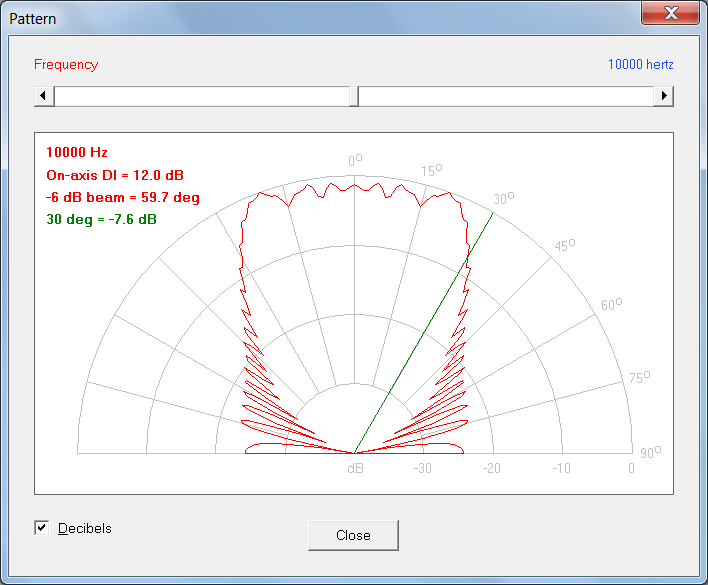

The Directivity Pattern tool now has a frequency slider. See Attachment 1.

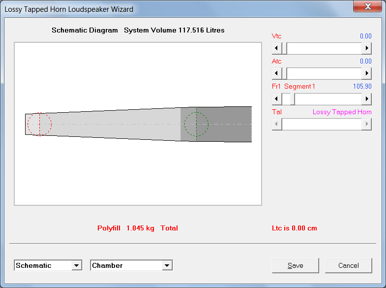

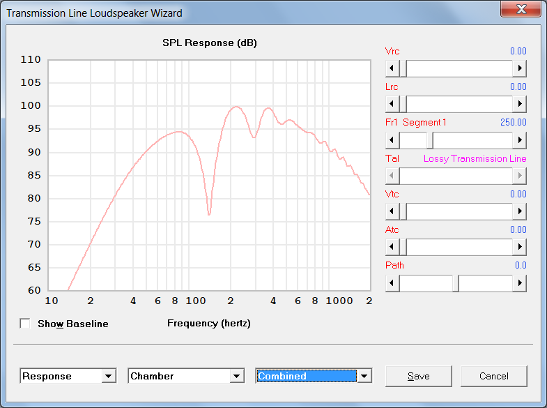

Different airflow resistivity values can now be specified for each segment. Double-click on the Fr1 slider caption to select a segment. If the Fr1 slider value is changed while the F5 function key is pressed, all segments containing absorbent filling material are set to the same resistivity value. See Attachment 2.
CHANGE 5
Double-clicking on a length slider value no longer adds or removes absorbent filling in that segment.
CHANGE 6
When the airflow resistivity value is less than 1000 mks rayls/m and the Schematic and Chamber options are selected, the Loudspeaker Wizard tool now shows the total amount of Polyfill absorbent material in kilograms required to achieve the specified resistivity value. Double-click on the total value to display the amount in the currently selected segment. See Attachment 2. My thanks to 'just a guy' for providing the Polyfill density data.

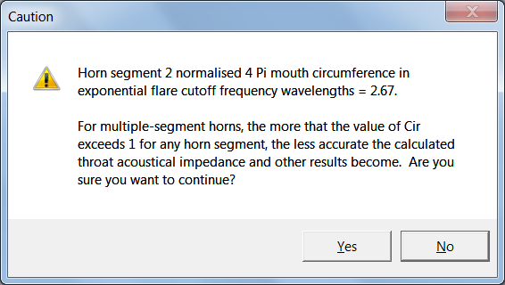

The bug reported in Post #3996 has now been fixed. My thanks to 'littlemike' for bringing this problem to my attention. Pressing the 'No' button on the Cir > 1 message box caused the same situation to occur - this has also been corrected.

Hi David, that is very nice, could not resist the temptation to go back and recalculate some of the designs, I can see a few changes in those would be good :).
One question though, perhaps I am misunderstanding something. the ability to add damping only exist in the loudspeaker wizard, right. So the values for the segments are not stored in the data model and hence not in the export, and not saved, right? If correct that also means that you cannot see the influence for example on the combined response or the impulse.
It would be really nice if the program remembered this info
But thanks for a great program, Kurt
Hi Kurt,
Correct.
The airflow resistivity value for the currently selected segment is saved (as Fr). If the same filling density is used in each segment, then the information is in effect stored. If the densities are different in each segment, then you will need to keep your own manual records - perhaps you could include the individual values in the record comment field. Note that this limitation is not unique to the Loudspeaker Wizard - the Filter Wizard doesn't save anything :). For all wizard data to be saved, each record would require a number of additional fields, even though they might not be used in a particular design - this would increase the Hornresp.dat file size significantly even though in many cases no information is being stored.
You can see the influence on the combined response (see attachment) but not the impulse response. The impulse response would take too long to calculate, causing the real-time wizard to "seize up".
The lossy model is restricted to the Loudspeaker Wizard primarily to limit the observable frequency range to 2000 hertz - see Post #3924 (linked below) for details on why this is desirable.
