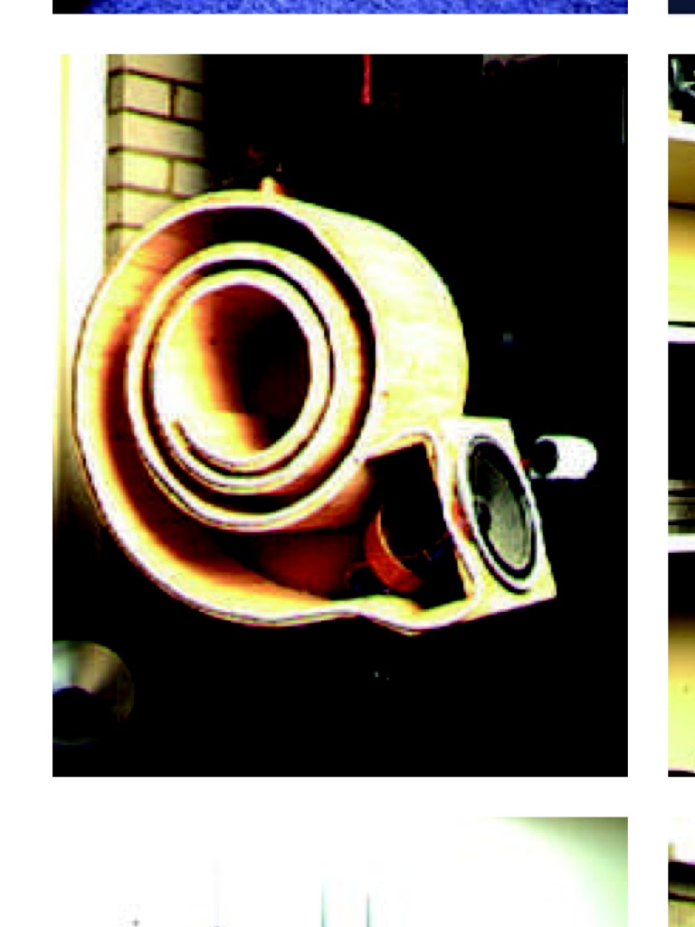

Hi soongsc,
Because the tapered rear chamber is sealed, and filled with absorbent material, there is nothing to tune :).
There is no reflected wave - that is the whole purpose of including the absorbent material. The system is not operating as a transmission line loudspeaker, where the output from the lossy line is combined with the output from the front side of the driver. In the Nautilus design, the radiation from the rear side of the diaphragm is simply absorbed in the filling material and dissipated as heat.
The following quote from the Bowers & Wilkins brochure linked by Oliver is relevant:
"The combination of an acoustically transparent magnet and an exponentially tapered horn absorbs virtually all rearward radiation of sound - creating the nearest thing yet to an infinite baffle."
There is another interesting comment on the B&W web page, also linked by Oliver:
"Tapering the tube enables you to make it shorter for the same level of absorption. It acts like a horn in reverse - reducing the sound level instead of increasing it."
This statement is extremely misleading at best. The tapered tube is not acting as a "horn in reverse". Because the mouth is closed, it is acting as a sealed chamber. Also, tapering the chamber reduces the volume of the absorbent material for a given length. I can't see how this would improve the situation, where the B&W stated aim is to absorb the rearward radiation of sound.
The Bowers & Wilkins company makes very good loudspeakers, but I personally believe that the use of tapered exponential rear chambers in the Nautilus is more about achieving a "remarkable piece of audio sculpture" (their words) rather making a meaningful contribution to the sound quality.
This is just an opinion based on my understanding of the physics involved, and the evidence available to me. You are of course entitled to hold a different view :).
Kind regards,
David

Hi soongsc,
I have been talking about the coiled "Nautilus shell" bass unit as shown in the original drawing posted by Oliver. It seems to me that is a sealed chamber. Do you have any evidence to suggest otherwise?
The high frequency configurations are definitely a marketing strategy. There is absolutely no need for such exotic rear enclosures (either open or closed). If however you wish to simulate one of the higher frequency units, then just leave the small end open, and look at Output 2 in the Loudspeaker Wizard (bearing in mind that there is a 2kHz upper frequency limit, for the reasons given in an earlier post).
Kind regards,
David

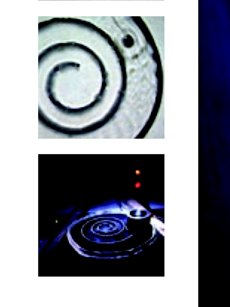

All the experiment pictures in the PDF file shown in a previous post show the taper opening into another sealed volume. Although the total enclosure is closed, the transmission line part is open. If the research were done that way, is there any indication that the end product would be different?
I have expressed my question about speaker response vs transmission line length in your sim. However, I have no intention of doing a transmission line like that, rather, it would use side slots as mentioned before, and you have no intention of implementing that capability, so there is no point spending time on it. In fact, inspired by the Nautilus, I had a test unit implementing the configuration I mentioned, the results were positive for a test of concept.

First of all, when you look at the pictures in the B&W brocnhure, there does not seem to be an opening at the small end of the curled tube for the bass section. The tubes for the higher freequency drivers may very well be open, but as I understand it, it was the bass section David analyzed.
I don't know if you believe anecdotal evidence, but a friend of mind saw the Nautilus speakers at a hifi show. He pushed the woofer inwards, and found to his surprise that it was a closed box design.
If neither of these arguments will do it for you, please consider the simulation of the Nautilus bass section done by Peter Fryer, head of research at B&W, in this JAES paper: AES E-Library Horn Acoustics: Calculation through the Horn Cutoff Frequency. The text for fig. 4 reads: "Predicted output with closed-end rear horn loading of Nautilus loudspeaker bass unit." If B&W head of research calls it a closed end rear horn, I'm not going to argue that the end is open :)

The literature on the Nautilus posted previously seems to indicate open end for at least the higher frequency drivers, what I can remember seeing was some sort of a hole in a metal part in the rear, cannot tell whether it goes through to the enclosure or not. It's been a few years since.
What a tapered tube does to the higher frequency waves is create a long reflection path so that it travels through the damping material longer before it will go back to the driver end. I think you can simulate is using a wave simulator. But the right length really depends on what kind of driver you are using. Mainly the reason why I asked about Fo which never got answered. I hope you are not expecting me to calculate myself. It was made clear the attempt was to see what the long coiled taper of the Nautilus was doing, but it seems the low end frequency response does not even come close to simulating a bass unit. Then calling the tapered tube a hype using simulation so carelessly is very unethical IMO. If you support that kind of stuff, good for you.
