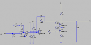

I was also thinking about the following.The cascode operation would allow for supply voltage of up to around 1.5kV by using 1kV FETs.A bridged version could give ~1kV RMS at output.
The problems would be limited power bandwidth and high power dissipation...
Lukas.

You need to connect R16 to gnd instead of the gate of U1, it now works like a weird kind of feedback.
Also 75k is a way too small value imho, you need at least 500k, of course this will limit the frequency response, so pherhaps some small caps in parallel to R16 and R22 would be wise.
